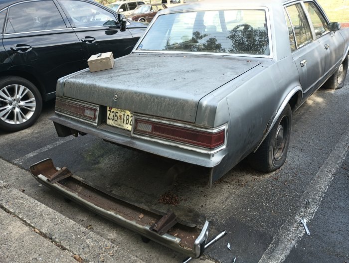

4. best way to take a rear bumper off one of these cars. no matter how hard i try the bolts keeping it on are rusted on solid. i tried lots of WD40. i don't have a heat gun

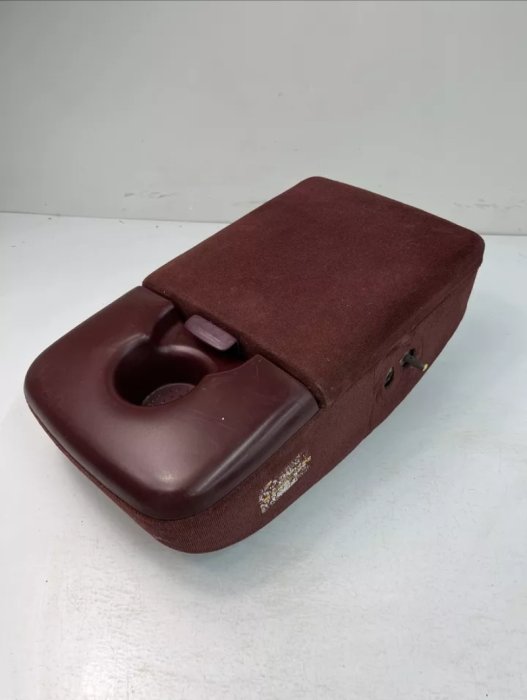

9. anyone know a good cupholder that fits snuggly and doesn't wobble?

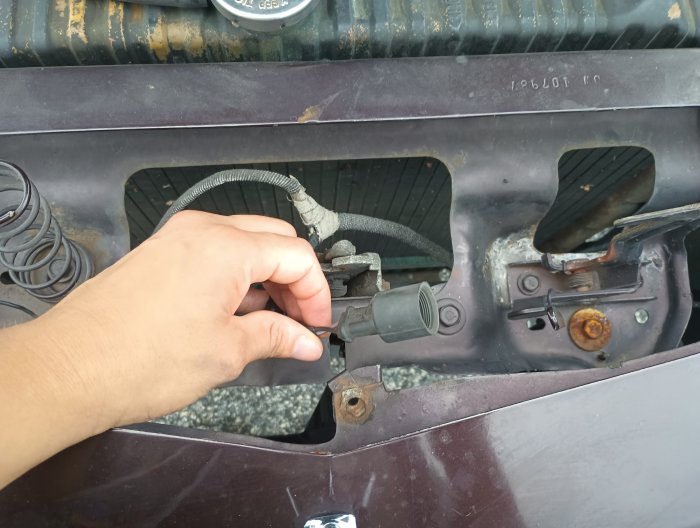

10. my car has this weird attachment on the horn wires. i have no idea what this could be. afaik this car was never in police use, perhaps an auxiliary horn was hooked up by a previous owner a long time ago? my drivers side horn does not work. when trying to put on a new plug to the drivers side one it was a no go. i ideally want to down the road put in a roadrunner meep meep

Was your car an airbag car? That's the only thing I can think of that would have a plug up there. They weren't pre wired early for it so an early 88 wouldn't have it.
For the bumper I always unbolt the bracket from the bumper or from the shock. If nothing is undoing you'll need to cut the bolt or heat it, no other choice.

I forgot about the redneck option for a cupholder. You can find a Buick, Oldsmobile, Cadillac or Ford truck armrest with the cupholder and rig it in place of the existing armrest
This one is out of a Ford

The horn wiring was a common upfitter hack to wire a siren into the horn button. Common, at least, until companies like Whelen offered separate control units with integrated horn control. Those were available by '88, but not everyone used it. Although the horn circuit was integrated with the clockspring on mid-'88-'89 models, horn operation itself was not relevant to the SRS system. Check your horn relay in the fuse panel.
Rear bumper, torch or whizzer. Considering the fuel tank is right there, I'd grab a half-inch drive, bust the heads off, and knock them out. Bolts are cheap.

1. fuse is nothing special. also car is not an AHB package and i'd be very surprised if this thing had a siren. would be cool though. i'm also seeing nothing special like there was something mounted behind the grille long ago. could be, i know the car came from Philadelphia and they used civilian package cars for detectives. that or its that overhead console thing but it is just weird that the plug is so crudely tapped in. doesn't seem stock

It's conceivable that the horn circuit was messed with, either for upfitting or as a goof-up somewhere along the way.

You said driver side horn doesn't work, it's a single wire that splits to both horns behind the grille so it should be easy to figure thst one out, it's usually a horn gone bad.
tried this. putting a new horn on the drivers side. then the old connector for the drivers side fell off.... tied wiring in a new one. and the whole thing died. i actually had to splice connect it back to the passenger side to get it to work again. i don't think the drivers side ever worked or if it ever did it was always very weak even after replacing it before the drivers side connector fell off

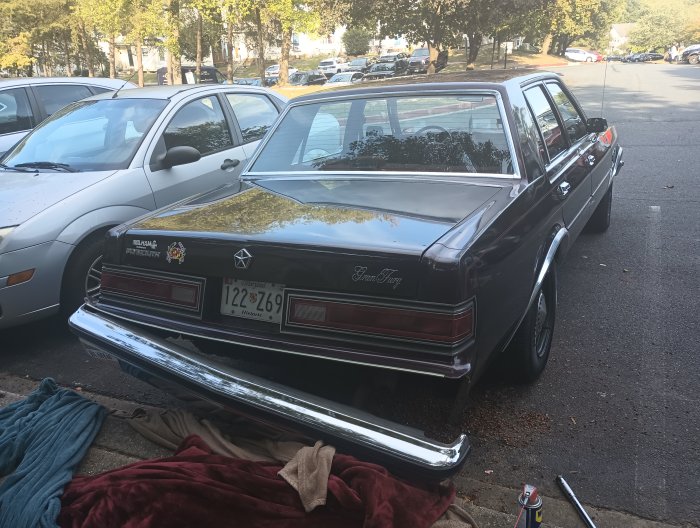

luckily all these bolts actually needed was a lot of WD40 and a good torq wrench. finally got this bumper off.
do yall think i should put the Bush 88 sticker on the new bumper? i guess it'd cover up that scuff mark

Did you use a torque wrench to remove the bumper instead of a breaker bar?
