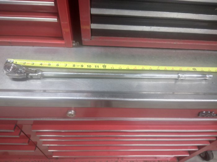

You need one of these. It's a 24", 1/2" drive ratchet. Like a breaker bar only better since you can ratchet the handle exactly where you need it.

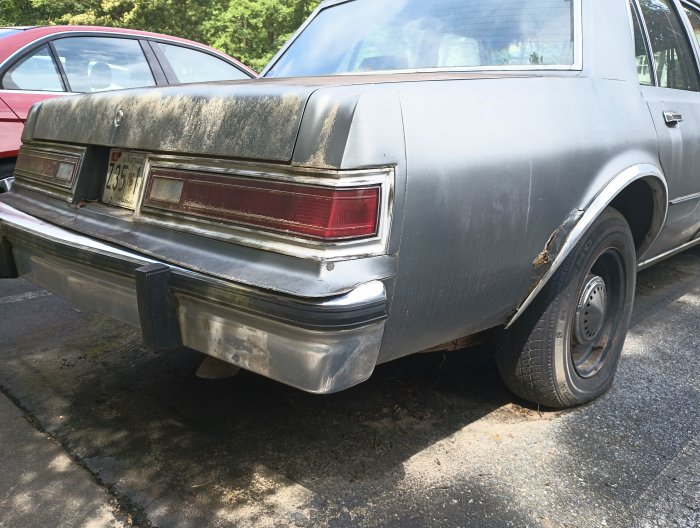

ok another question. i guess this car was used to box someone in during it's life as an unmarked Baltimore County Police car. is it possible to pull this back out? i recall my father tried tying it to a tree a long time ago to no avail. and with how rusty it is now we'd probably rip the thing in half lol

The 2nd one is (was) a front unit.

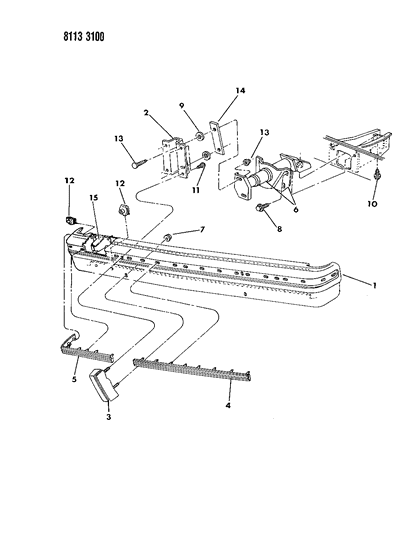

This is from a '79 parts book (so may not apply to later years) for Diplomat and LeBaron rear bumper absorber, however:
4014888 wagon
4014889 2 dr
4014891 4dr
If the catalog is correct, the 4014889 don't fit a 4dr. What the difference is, no idea, lol.

would you happen to know the part number for 80+ 4 door? or you think 4014891 would work just fine?

Sorry, I only have a '79 catalog. I do know '79 and '80 F-body has a slightly different rear absorber. It's only a difference in the hole location where the plate bolts to the rear crossmember though, so it's easily modified to fit either year. Does that apply also to M-body? Don't know for sure.
