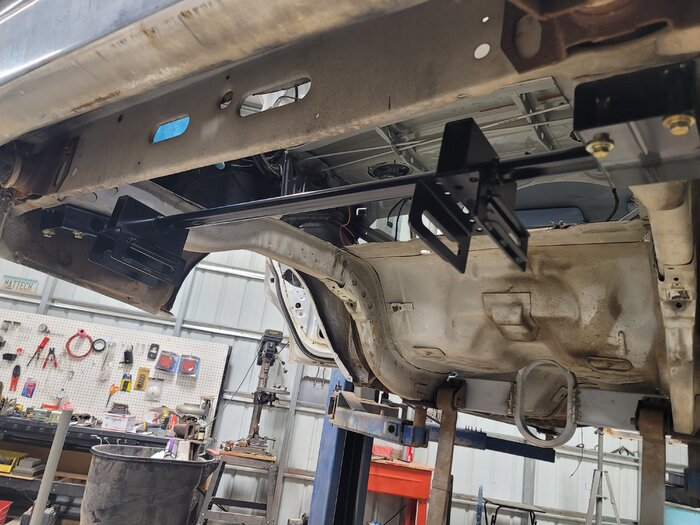

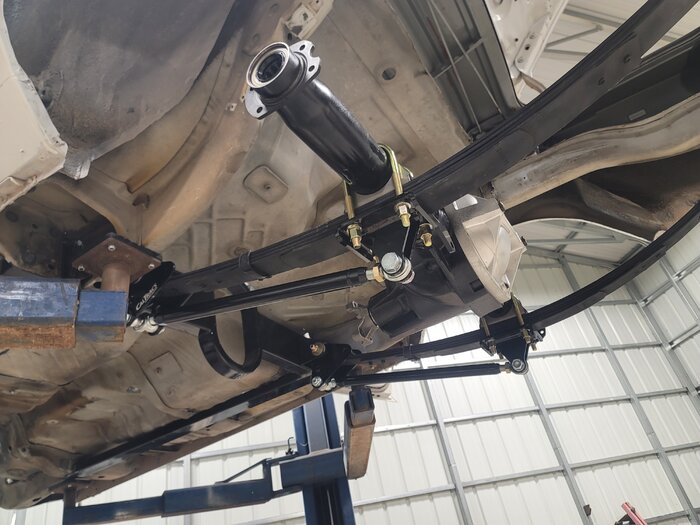

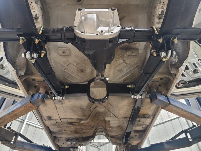

Been while since I've updated anything on this process.
I took last summer off, but made some progress when it got cool again.
Now, it's time to assemble the front chassis/suspension and get my Hemi bolted in. T56 6-speed is waiting to be fitted up. Gonna be a lot of cutting. :)
Here are some pics of the new suspension:

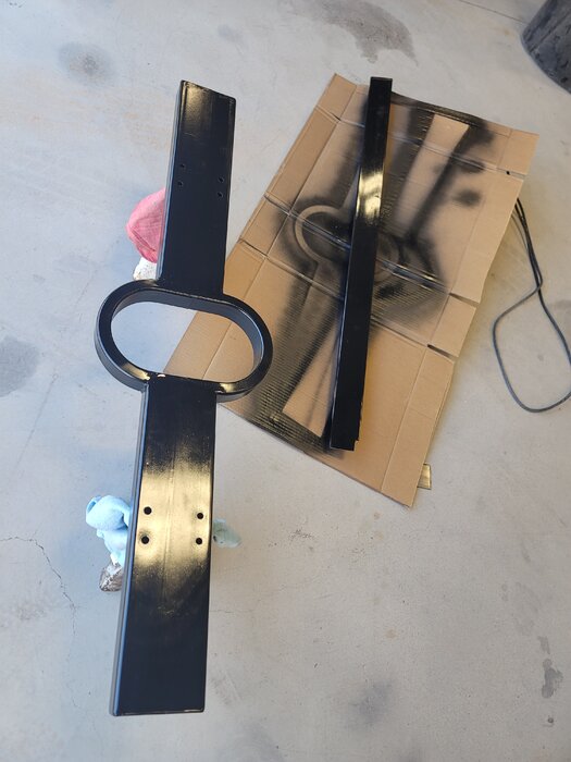

Crossmember with inboard spring hangers.
Rear spring sliders on custom mount
Ford 8.8 rear from 1999 Explorer (narrowed 3")
Caltrac Traction Bars.
