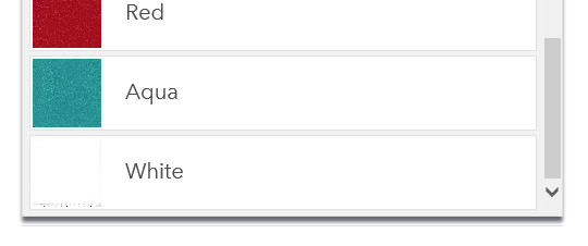

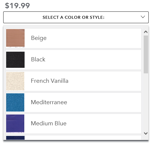

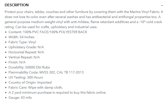

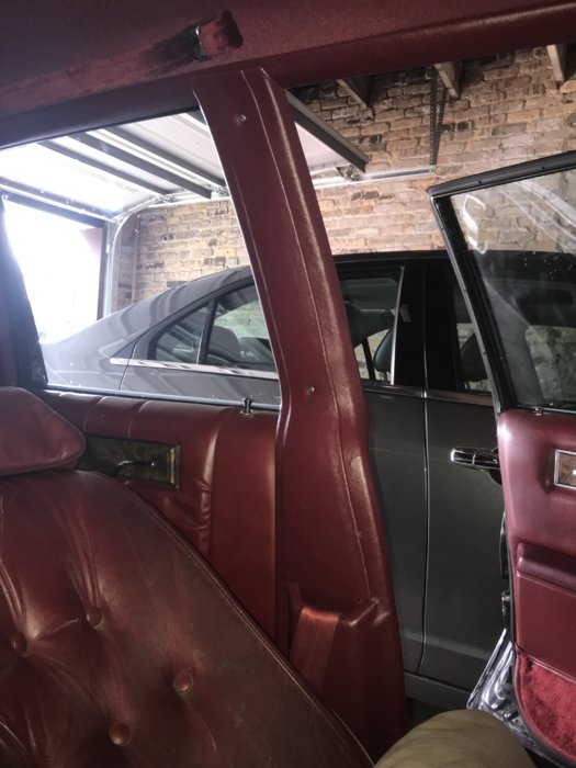

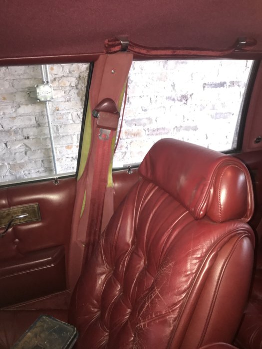

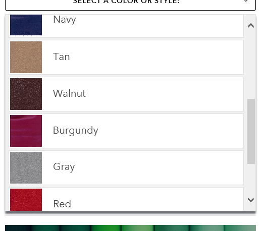

Match the fabric and color of your sun visors. I’ve been slowly reupholstering my 5th ave with a PVC vinyl material that’s normally used for boats, find it at Joann fabric and craft store. It’s very UV, temperature and water resistant and durable, even matches my factory interior pretty well. Attached is a before and after of my pillars
Camtron
Apr 25, 2019
2,346
1,926
US
How much fabric did you end up using on your Fifth Ave? BudW[/QUOTE said:
I used 4 yards total to do both pillars, trim strips that support the headliner up and the little triangle moldings/limousine light covers on the rear doors. Probably have enough fabric left to do both sun visors. With that said, I messed up cutting the fabric once and wasted a good portion of it so, you’d get even more out of it.

For what you're getting that's a very expensive price. I went to an upholstery supply shop and got super premium chair and sofa fabrics for those prices.
Camtron
Apr 25, 2019
2,346
1,926
US
Idk, for being UV resistant, flame retardant, water resistant, having a freeze rating -10 degrees and even having anti mildew properties, was worth it to me. To each their own.
