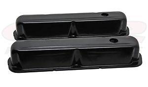

So the breathers only will allow pressure to build up and I will get oil leaks?
here are the valve covers I bought
kkritsilas
Jun 21, 2012
2,009
450
Calgary, Alberta, Canada
The breathers allow pressure to leave the cylinder heads without spraying oil all over the place. You will not have pressure build up in the cylinder head area below the valve covers. You may get pressure build up in the crankcase.
Depends on if the hole that the PCV valve was connected to is blocked off. If you did block it off, crankcase pressure will increase. The pressure increase may nor many not be enough to cause a leak. Depends a lot on how much blow-by the engine has, what kind of rpm the engine is running at, and an a number of other factors. Won't do the oil any good anyway. If you didn't block it off, where/how is the crankcase being vented? If it is being vented below the car, You will smell it. You also may be spraying out a small amount of oil.
Most valve covers have holes near each end, with one hole open (usually for one breather and the oil fill hole/cap), and a pair of caps to allow for a second breather and the PCV valve grommet.
