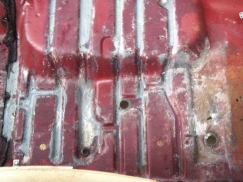

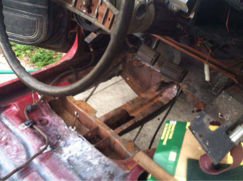

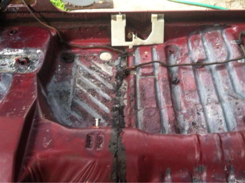

    Ospho in floor pans

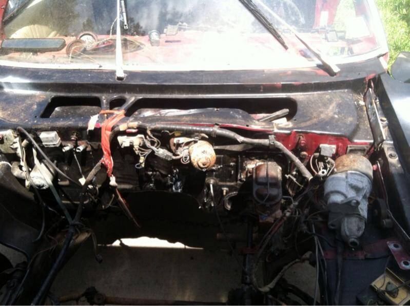

    Got your dash removed and got your hood mounted so I can disconnect the heater box form the fire wall and disconnect the steering coupler. took a while to find the hardware...

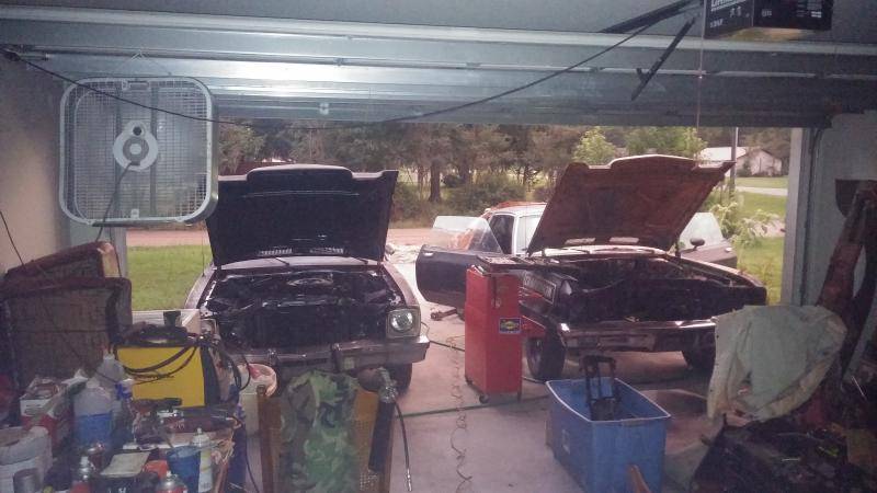

    78 Volare on the left and 77 Aspen on the right
  6. Captain Caravelle
    Captain Caravelle Moderator--Mopar Maniac
    10,789
    1121
    Nice pic!
    Dueling builds.
    CAGE MATCH!!

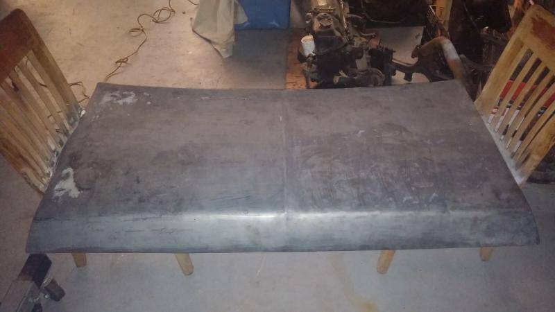

    Got the garage cleaned out enough to where I can start working on the aspen the trunk lid is about to get the treatment and the interior panels got painted up.

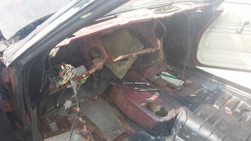

    its all out now just insulation left

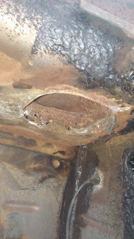

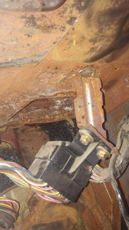

    Hit it with the wire wheel only found two spots where the rust went all the way through the firewall looks in good shape..welding those shut today...

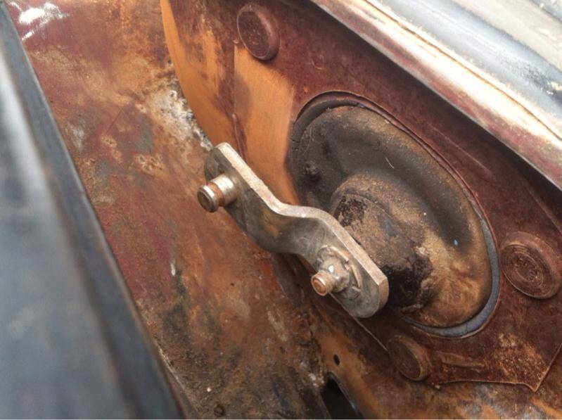

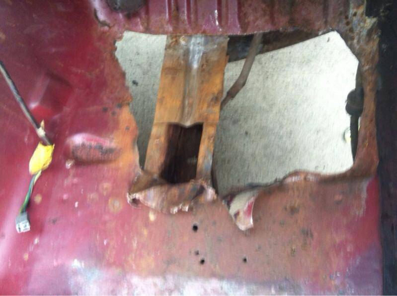

    Driver side vent hole looks a little rough gonna need a bit of work to fix and the wire harness bracket needs to be reattached after new metal goes up there.

    Passenger side looks much better just needs patching and fill the holes and seal it up. :icon_eyes:

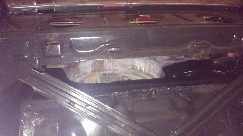

    Holy 'Our Lady of plastic acceleration!'
    -going to have to fix the flint-stone footing.

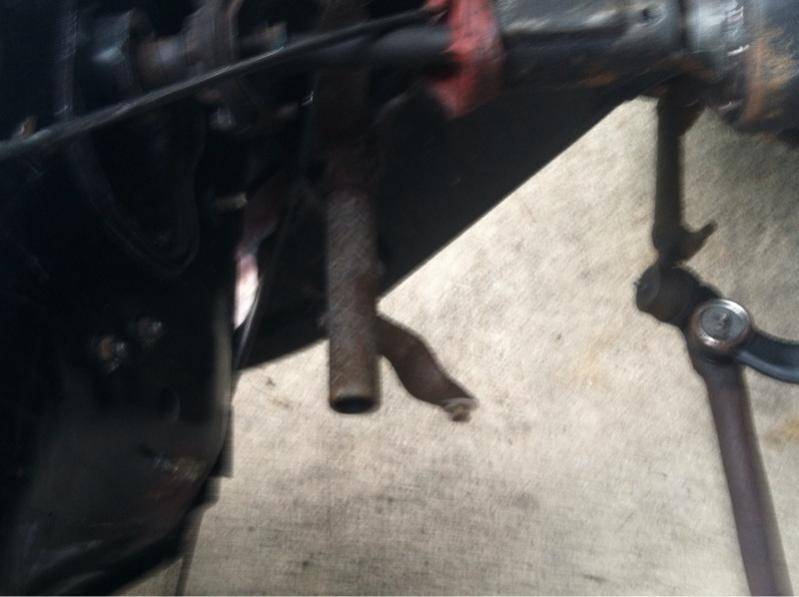

    More

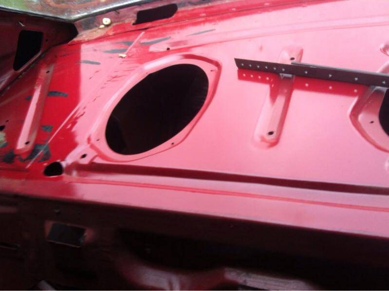

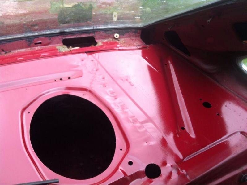

    The back board was under a board of insulation-and looks MINT! Or red.

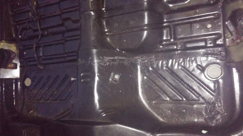

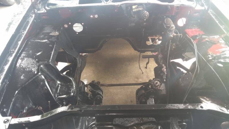

    All the metal that was red all over (either cleaned or Ospho'd) is now painted black with Rustolium industrial strength rattle can at $5.27 a can from Walmart-maybe four cans for the back board, 20% of the trunk, all of the ceiling, and 80-90% of the floor pans. Rich posted pics of it earlier.

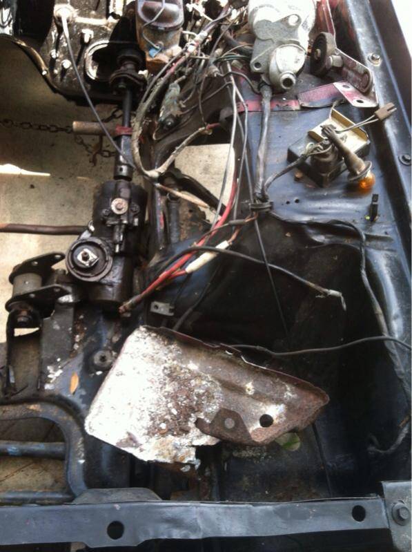

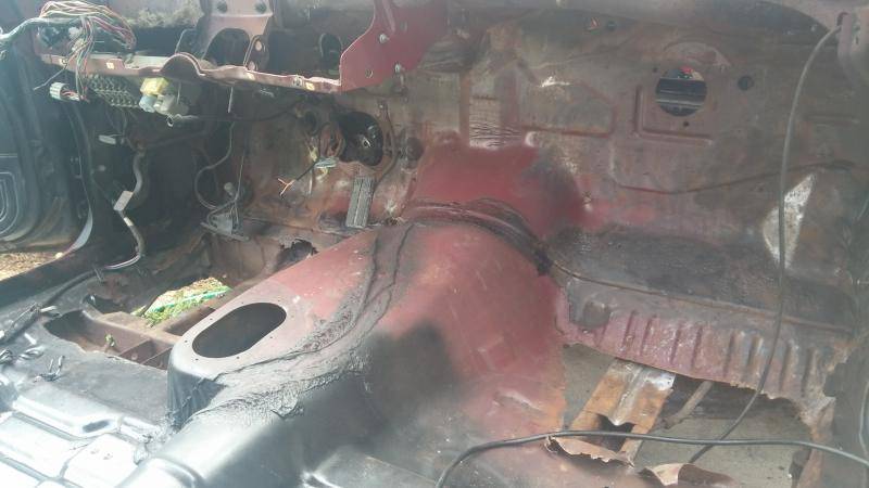

    getting the engine compartment for repairs and paint...there is a small crack in the fender-well and a section of the battery tray needs to be welded as well there are a couple of places on the fire wall that need to be patched up and it will be ready to spray bomb.

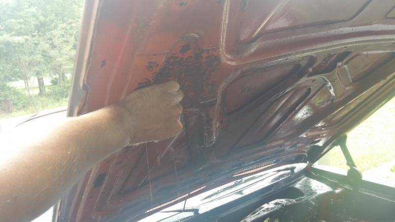

    Under the hood has to be wire wheeled and ospho'ed looks pretty atrocious...
