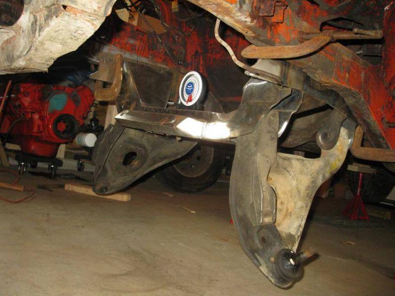

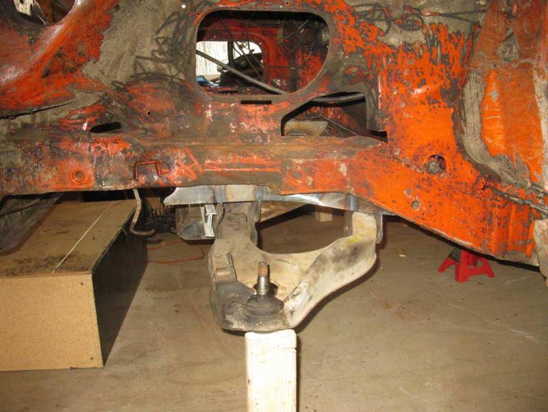

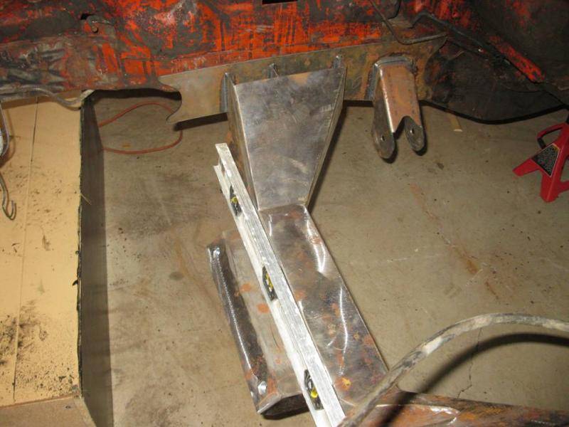

Still more slow progress. Snails pace. F-body k-member out and trial fit of Dakota crossmember in. I think... it's gonna work. I cleaned up some of the gunk on the frame rails, marked dead center for placement and tapped it in with curses and a mallet. Tight, but fits fine. One of my major concerns was how the lower a-arm was going to clear the frame. It does. It will come out for more cleaning, marking and cutting, but, I think I'm on the right path.

Lower stance is good. I've got the crossmember valley positioned between the rails at the same point as the original k-member. If you've seen the 87-93 2WD Dakota's, you'll notice they ride slightly high. If the stance is lowered in my application, that will make drop spindles unnecessary. I'll adjust as I go along.

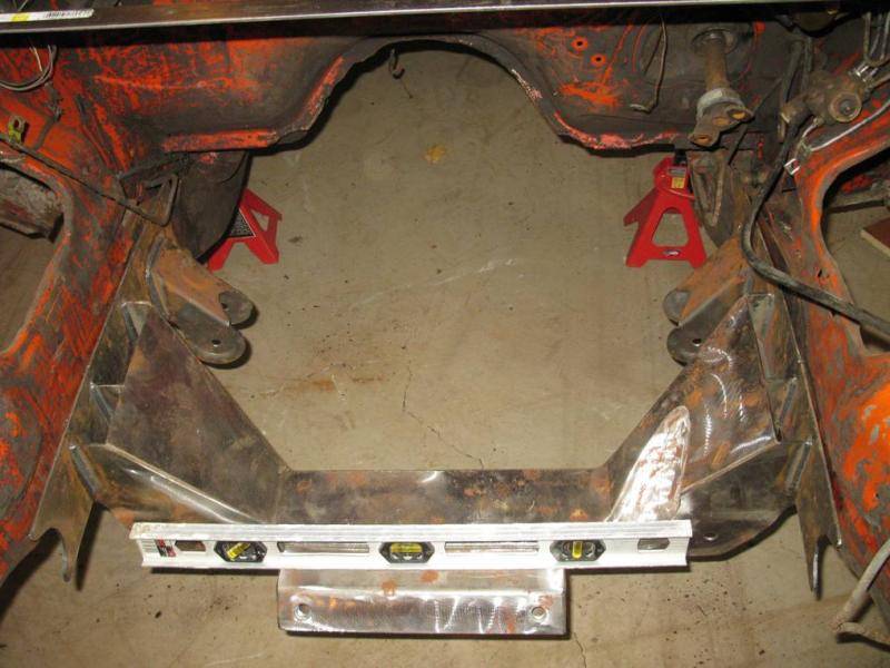

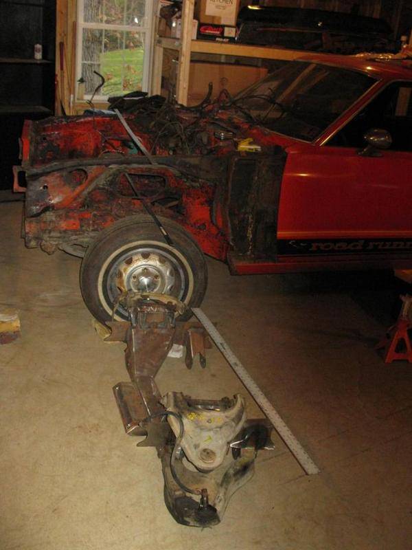

This may not look like I've done a lot, but, I have. I've had the Dakota crossmember out then in again three times and the F-body member in and out twice taking measurements. I'd laid a long straight edge across the F-body k-frame and using the grease fittings on top of the upper ball joint, marked out the axle centerline. I had to do this multiple times to make sure I got it right. I did the same with the Dakota crossmember out of the car. Once I get it all marked out to where I thought it should be, I put the Dak one back in. Before I did that, I had to trim a piece of the frame where the drivers side rear k-frame mounting goes. Once trimmed, it slipped in with some shoving. Things I have learned. F-body frame rails are not symetric. The drivers side rail bows in slightly where the steering box coupler goes. I'll have to do something about that later. Right now, it's just sitting there (again) marked out. Fits well.
Greg

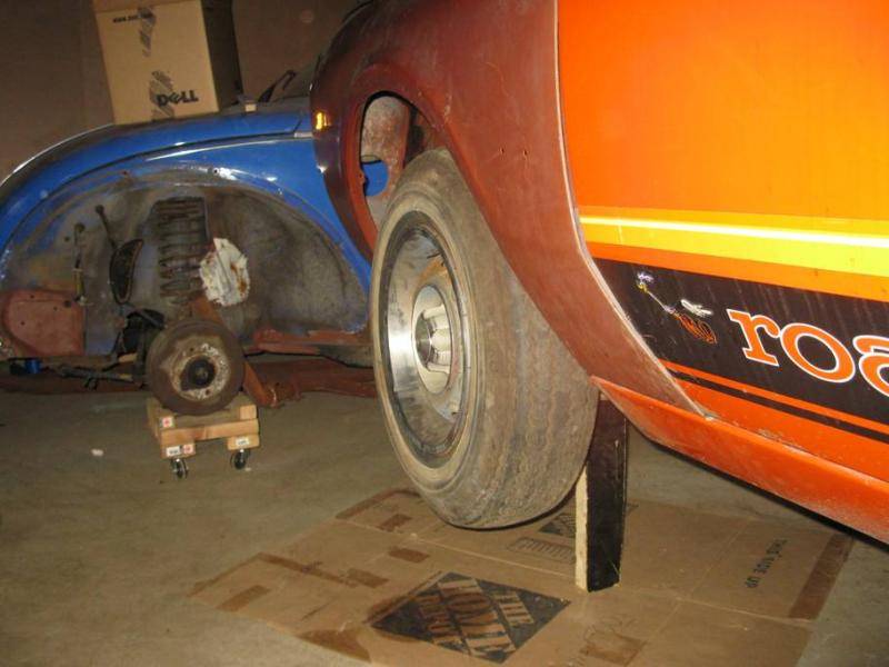

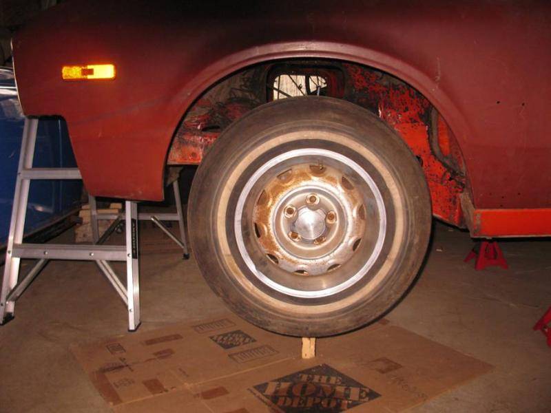

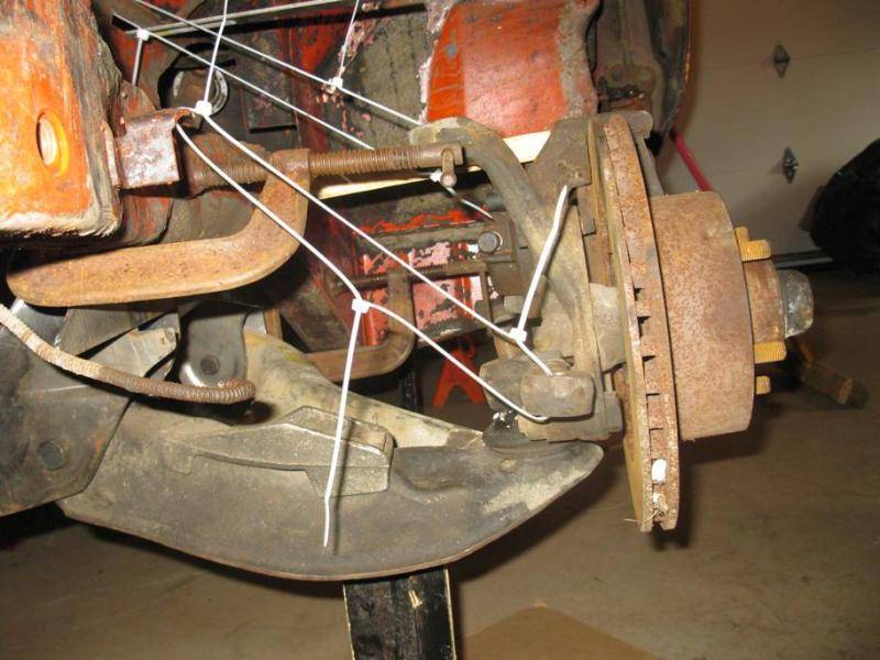

Once I got everything where I THINK it should be positioned, I stuck the spindle and brake assembly on and held it in place with tie wraps and a block of wood. I couldn't put the spring perch and upper a-arm on yet. Just checking for fit.
After that, stuck on the Mopar Rallye wheel and the fender from the rafters. Looks OK.
Pay no atention to the ragtop in the corner. I guess more measuring, then some quality time with a sawzall is next.
