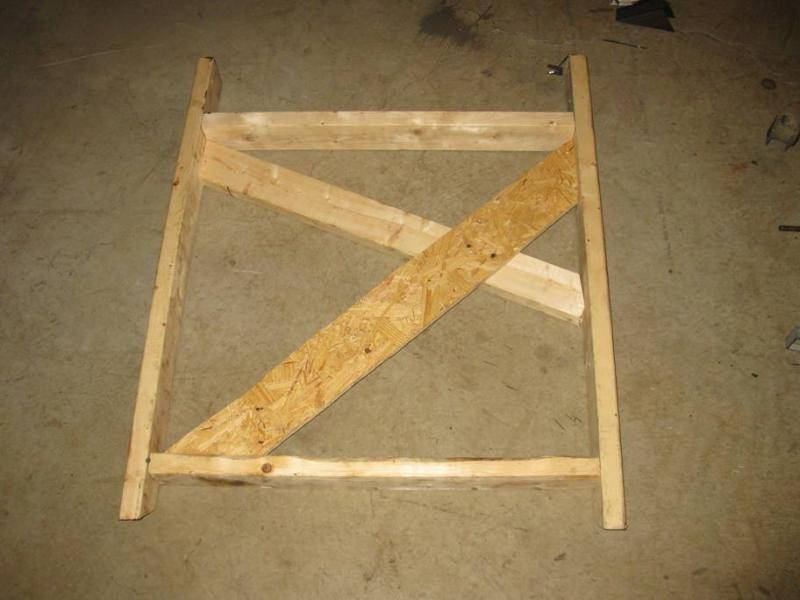

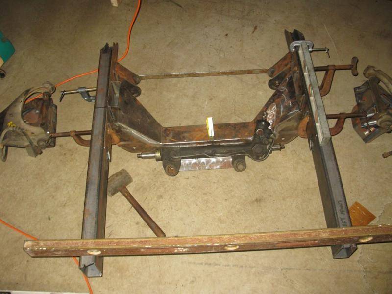

My wife and kids are visiting Grandma in Florida, so I got a chance (belatedly) to do some work on my project. This is "Buck". I laid 2"x4" steel retangular tubing onto the Dakota crossmember and clamped it together to get basic dimensions. I then placed the 2"x4" wooden studs on top of that assembly to duplicate the outside diameter and proper length I'll be working with. When Buck came together, it was an easy (and light) way to place it against the frame bottom and mark
where I needed to cut.

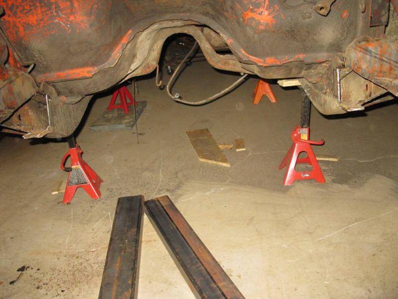

With all the marking and measuring done, I broke out the Sawzall, said one last "Hail Mary" and started to slice. Turns out, I didn't have to slice that much. Nerves of steel....

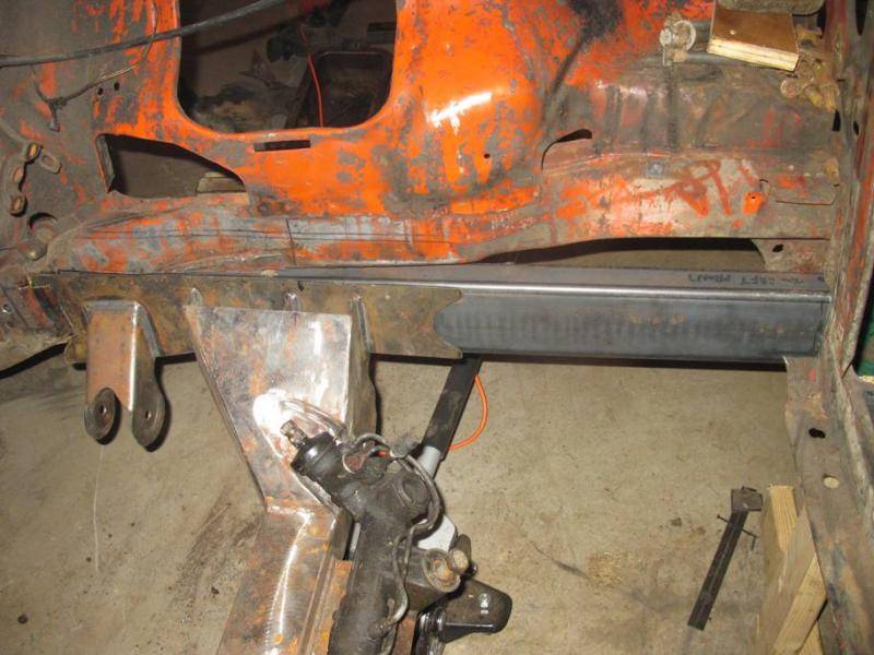

After another couple of days of laying on my back, measuring more and cutting more, I was able to get two lengths of the 2"x4" steel tubing to slide into the frame rails. I actualy had to narrow the tubing slightly to slip in. This is where I'm at so far. The two new frame rails essentially duplicate a 53 Ford F100 frame in width. Once the frame rails were in, the Dakota crossmember slipped right in. Those "high water marks" are where I originally thought the crossmember should be placed after measuring and marking. However, when I put the steering rack on I realized I had to lower the crossmember even more to clear the pump lines. It's right where it should be now (I think). Since I lowered the crossmember in the chassis it may cause the car to sit high. Back to Craigslist and I scored a set of Gen 1 Dakota drop spindles. I'll use them if I need them. Anyway, nothing is welded up yet. I've got to take it apart again and clean it up first, but, at least I've gotten this far. At the rate I'm going, it may take a while.

Continuing to "stay the course" over the winter (it was COLD in that garage), I measured, cut, measured some more. Got some work done (not a lot but some). Welded in the rails and crossmember. Still much, much more to go. Still have to weld in the top hats for the coil spring perches. Nontheless it is a GRAND adventure. Cutting up my car I mean... Dakota A arms are at the shop getting new ball joints and bushings.

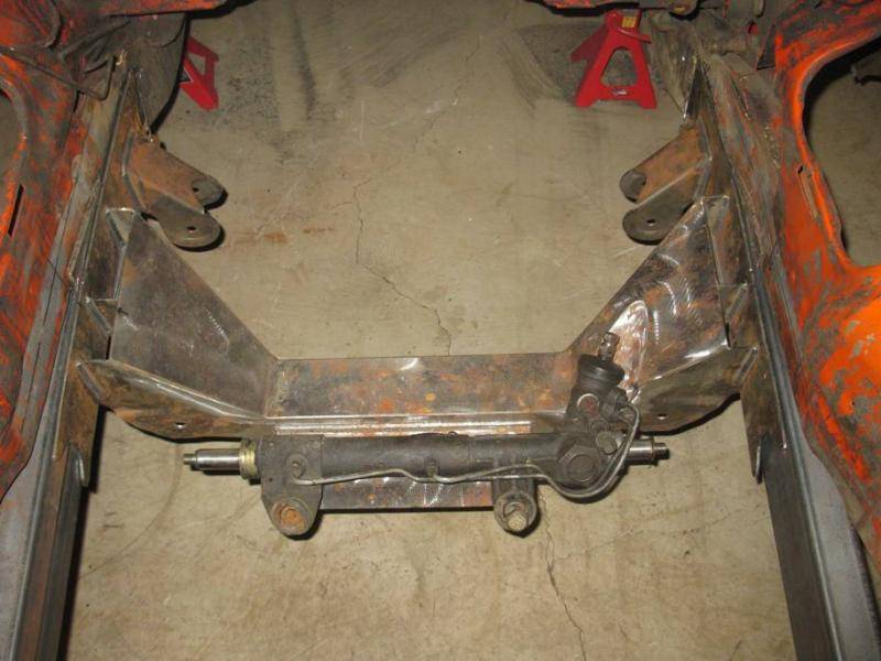

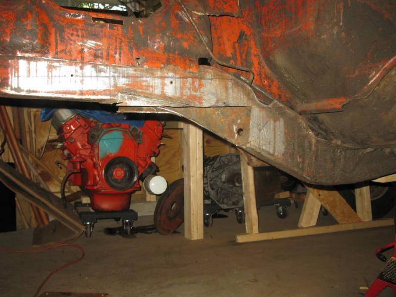

I am SO glad you asked! Back at response #52, you'll see a pic of one side of the crossmember welded in. You may notice several "high water marks" on the body where I had figured the crossmember would sit originally. After a lot of measuring, I lowered that mark to where I actually placed then welded one side of the crossmember to the frame. After sitting the engine in the bay, turns out I was right the first time and second guessed myself into a big fat foulup. Engine sat way to low. So, I very gingerly drilled out the plug welds and removed the crossmember. I've since positioned it higher and with the engine in, I'll be again, welding it back in at (I hope) is the proper height.

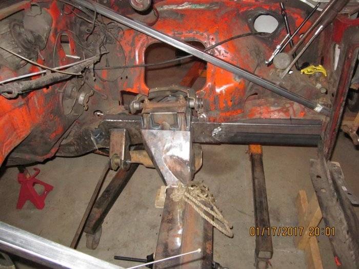

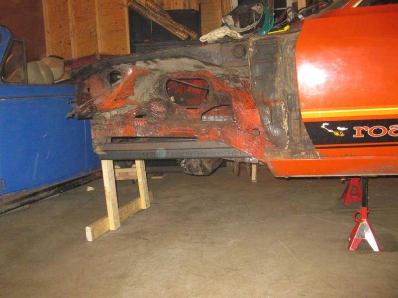

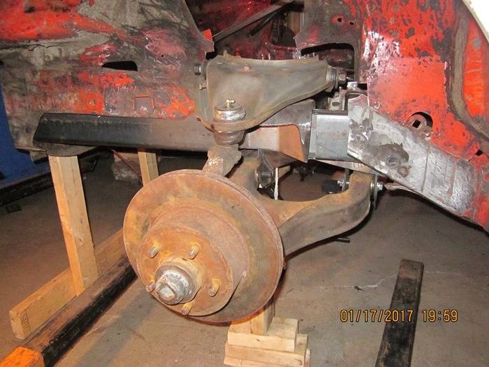

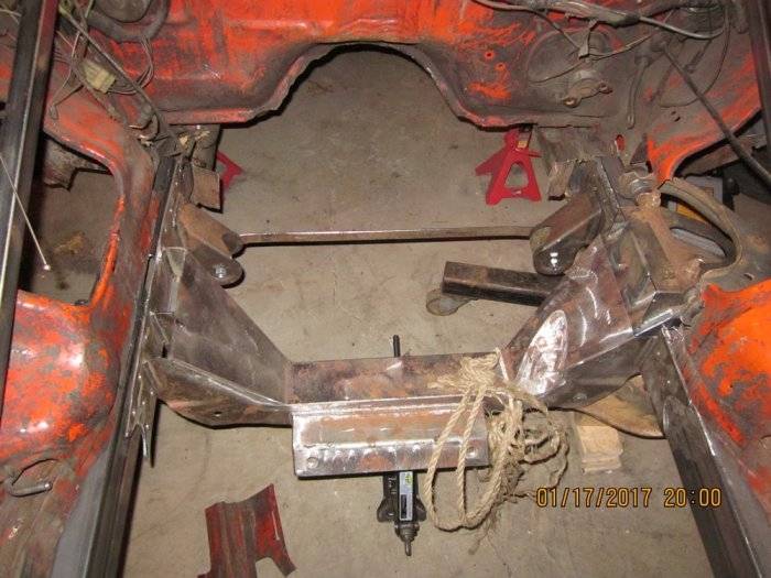

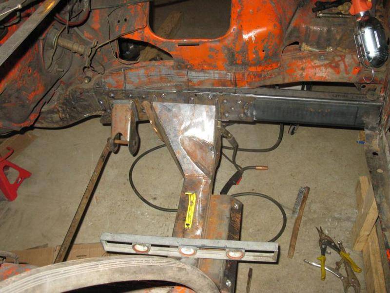

Egads it's been a long time! Let's say this, life is good but working on an old car is better... when you have the time. I confess, I've put this crossmember in the car and blown it out three times from foul ups. Luckily in my education I've learned that tacking stuff in lets you take stuff out without too much hassle. Anyway, I've got the right height and position now and I took some pics yesterday just to show you where I am. Be advised, because of another foul up I'll have to blow it apart again but it won't cost anything other than time spent. Live and learn. Between taking my son to hockey games and selling Girl Scout cookies with my daughter, I've managed to get to the point where I'm certain the front end will work just fine. No coil spring in yet but as you can see, with a small amount of finagling it will go in as an assembly soon. I hope...
Just keeping you updated.
