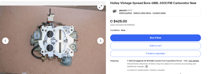

They don't appear to make a new spread bore set up for Chrysler anymore that I can find. The 4011 went out of production. I don't know enough about it really to buy a used one hoping I will get one that is good and not junk. Also looking non-EGR.

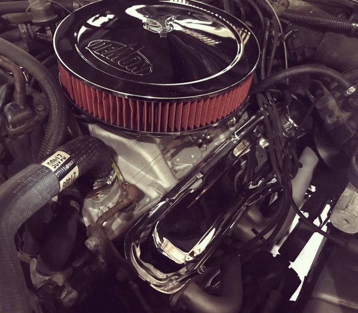

I showed this exact one to him and had him look at it and we will run with it. What air cleaner are you using and does it clear the hood?

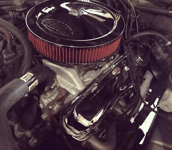

I’m using a 14”x3” air cleaner and a stamped Demon tin. Clears the hood no issue.
Old photo from when I had the 318 and performer intake in the car.

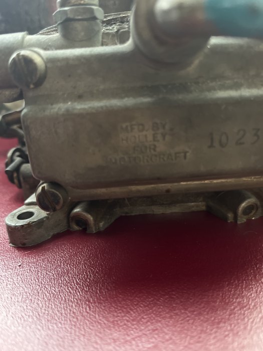

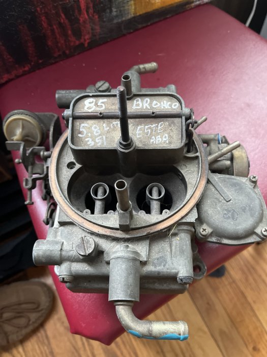

Hell, I think I have an ‘85 Holley off a bronco at home. Was saving for a 302 that I have tucked away in the garage, if anyone is really set on an old Holley 4V, they can have it. Pretty sure it’s OEM ford unit.
Camtron
Apr 25, 2019
2,383
1,963
US
But now that I’m home…can confirm it’s a Motorcraft By Holley…but it’s a square bore. Things been on my TV stand for 4-5 years, lol

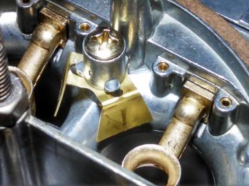

In your time, You ever try adding those atomizer/mist plates onto a carb? Little plate/s that mount under the squirters to turn the stream of fuel into well, more of a mist. Have always been curious if they make much difference but never enough to try them.
XfbodyX
Sep 9, 2015
1,725
499
Central US

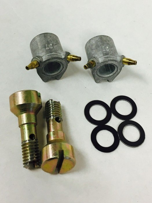

Thats interesting. Ive never seen them before. So I cant say but they look like way to lesson air flow. If you have the tool the ideal way is about $100 worth of annular boosters.
I need to research those just for kicks. Dont think they would fit my needs but always good to learn about different things.
I do use these which are not sprayers but do get it out there a bit better. But even these are low on the list of things to possibly do as is there really a difference?
AMC Diplomat
Feb 14, 2023
1,754
828
NY
They're only good if you have a garbage carburetor that is out of adjustment or has a crap accelerator pump/circuit. You'll see no measurable, observable, scientific benefit from these if your carb is good
