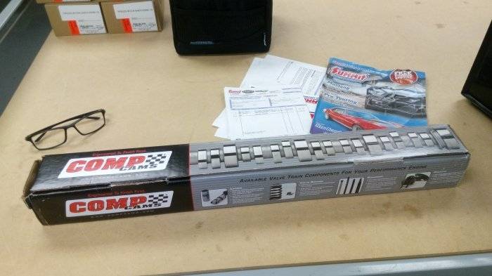

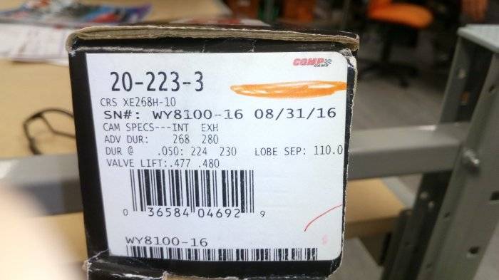

Hmmm this just arrived in at work today

Ok this is my combo I have worked out
10.03:1 compression
190cc heads with 2.02/1.6 valves
Comp Cams XE268 Cam
Double roller timing chain
Timing chain tension cover quick change front crank seal
Timing chain tensioner
408 stroker kit, Internal Balanced, Series 9000 CAST, I-BEAM RODS WITH 7/16" Cap Screws, Forged icon FHR Pistons, Rod Bearings, Main Bearings & Rings
Roller rockers 1.5
Airgap intake
770cfm street avenger
318/340 harmonic damper
To back it up I will have a built shift kitted 904 with the 2200 - 2500 stall converter driving through a 3.21 open rear end (may have to go LSD)
Just remember our gas here is RON not MON, you guys are lucky, we have 91 and 95 RON, our 95 RON is about as good as 87 MON with no ethanol in it so I can't push compression!
