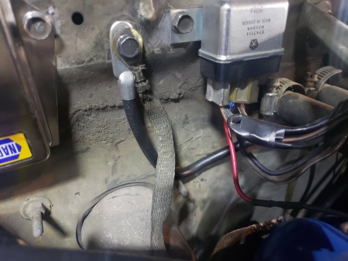

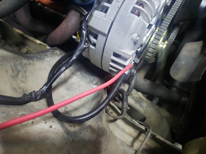

Okay, I just got to anime 6 gauge ground wire from the alternator to the Head, and then I believe it's 12 gauge wire from the alternator body to the regulator body.....
I will see if it works for in the morning, cars too loud to start at night lol

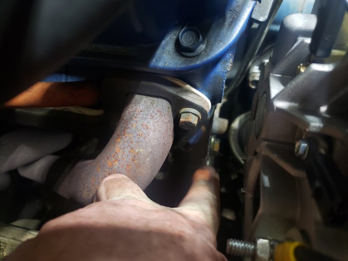

Oh yeah, can't forget about the ground from firewall to back of head ... used another 6 gauge wire with the OEM ground strap.....

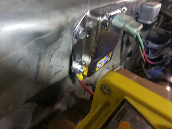

If you saw the video below, if it shows, move the regulator to the fender and straight wired it bypassing entire voltage regulator wiring harness...
