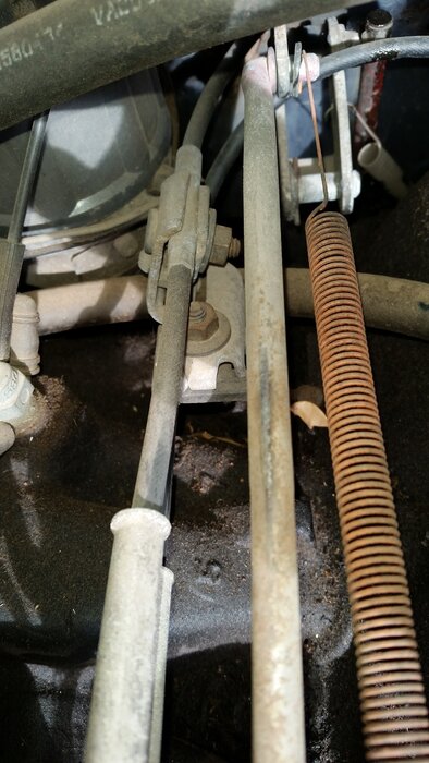

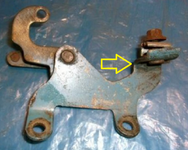

A 318 2-bbl Throttle Cable bracket (from my '86 Fifth 318):
The 2-bbl throttle cable (barely viewable because it is under the cruise cable) adjustment flange is sorta parallel with the ground (yellow arrow).

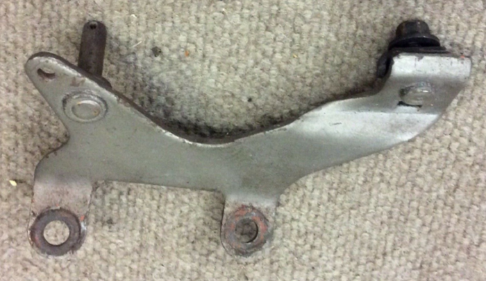

On 4-bbls, that tab is mostly sticking straight up (but hard to tell in this picture):
A person can bend flange up and get your original one to work. It doesn't take a rocket scientist to do this nor does it need to look anywhere perfect to operate correctly. The import part is to try to keep the area where the cable and clamp attach to, unbent.

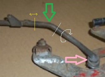

The next part is the upper link. The 4-bbl link is ~1 inch longer (a rough guess - not measured).
ALL 2-BBLs - the upper link is bent upwards at the rear and the rod goes in towards the Left fender. You can see the direction in the top picture, but you can't see the "upward" bend at rear of link.

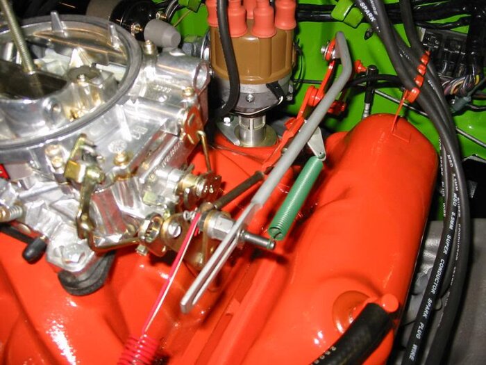

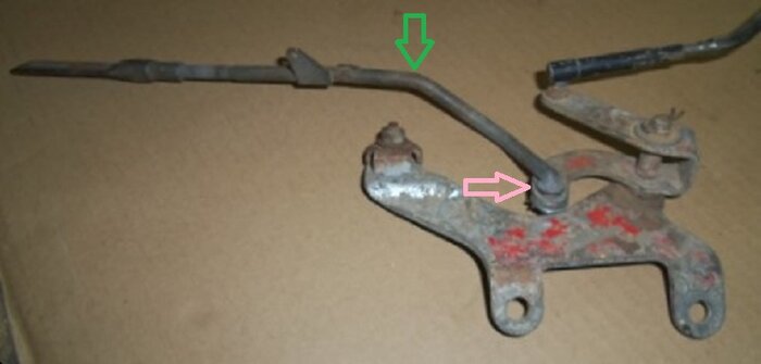

ALL 4-BBLs - the link is (also) bent upwards at the rear and the rod goes in towards the center of the engine. This is a poor picture, but you can see the upwards bend in link (green arrow) and the direction the link is pointing (pink arrow):
The upward bend (in upper rod) is so it will clear the throttle cable.
The picture above and below is correct rod for a 4-bbl. To take an existing 2-bbl rod/link and convert it to a 4-bbl then cut it at the white line (below), rotate it 180' (to as shown) and re-weld:
Then, cut at yellow line. insert another rod roughly 1 inch longer and weld into place. Measure your setup before cutting/welding! (measure twice and cut once). You have a lot of adjustment at the turn sleeve - but not enough to convert a 2-bbl link to use for a 4-bbl.
These two mods should get you working as far as kickdown linkage is concerned.

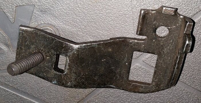

The next item is cruise control (if applicable).
2-bbl small blocks use a "L" shaped bracket to attach the cruise cable in place:

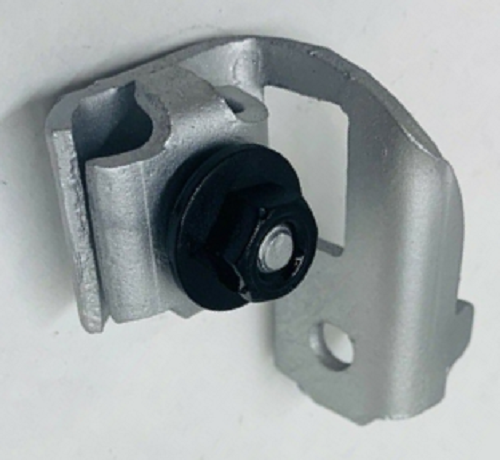

4-bbl small blocks use a different design:
A person can straighten your "L" shaped one to a more flat design. The 4-bbl cruise bracket adapter (above) is rather hard to find.
