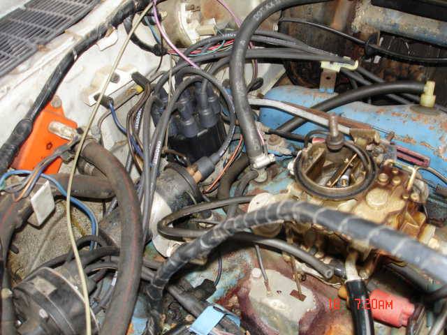

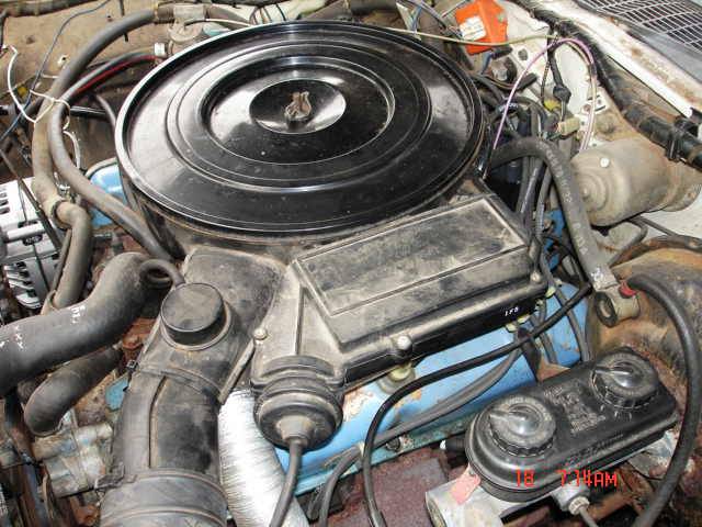

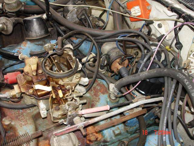

Thanks Cap for pointing me to this thread! I notice on the first page of the article Rick says you need to have a service manual for your car. What I have is a 1972-1979 Chilton's (the old hardcover), recently purchased Dodge, Plymouth & Chrysler 1971-1989 Haynes manual and just received this past week the 1979 Chrysler/Plymouth/Dodge chassis,body & electrical service manual from Mopar on cd. I've tried to find manuals that were specific to the 1979 LeBaron but have been unsuccessful in my search. Do ya think I've got enough material to cover "Trash That Lean-Burn"?
10,746
1,209
If you've got the Chrysler service manual I would say yes.
They didn't make model specific one's.
They would generally just make one service and one electrical for all the models of that year.
In the 80's Fifth Ave years they'd just make one all in one book.
10,746
1,209
This might be a stupid question but here goes... how do you know if your system is "lean burn"?
There's a computer box mounted on your air cleaner on the V8's
It was labeled either Electronic Lean Burn or Electronic Spark Control System...some said Electronic Fuel Control System.
No vac advance.....the computer controls it.
You also had one of two cards...a Holley 2280 or a 6280
The 6280 was the "feedback" model meaning the computer told it what to do.
In it's defense it wasn't a terrible setup.....I'm still running mine on my Fifth
When they work they work and when they don't it's time to lose it.
I'm a bit foggy on the slants.....I'll have to crack the books again
But the Super Sixes didn't have it....they had the electronic ignition setup which was a ballast resistor and the ignition box mounted on the wheel well....no actual computer.
Mostly sensors and emissions line routing I believe
But no idiot box and still have vac advance. the slants weren't as saddled with crap as the smog era 318's and 360's..and as far as I recall didn't have an actual computer box.
greyghost
Aug 14, 2014
154
28
Roscoe, IL
Thanks for the input. My LeBaron's air cleaner has a computer in it even though the labeling is missing. The distributor does not have a vacuum advance (even though it's hard to tell by the pics) The carb is Holley R-8448 4095918 3248 and when I looked up the number the information told me it is a type H2-2280. Here are some pics (it looks uglier in pics than it does in real life)
