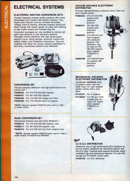

Now to the Lean Burn system: The Aspen had it and after a few years that packed in; same for the G22. I bought an original Mopar conversion set from the norwegian importer and still have the Performance book they gave me way back late 1980's. It was dead simple to replace the Lean Burn system but the original carb Thermoquad was a different kettle of fish. The importer in Norway simply could not get her to run properly. They said the manifold leaked so drawing false air. No way I said as I had personally done the cylinder heads and ground in the valves as well as new gaskets. So what to do? I took off the TQ and checked it over in my own hobby workshop (been a biker since mid 1960's) and found the carb draw false air due to a badly worn carb front spindle. The strong return spring worn one side so leaking like hell. I did that up maching new bushings, tinning up the spindle, maching that too to make sure it turned all right. Perfect!
But having done all that I found it better to swap that to a new Edelbrook fitting straight on the manifold and easier to tune. Lean Burn stopped working on the G22 so a fresh convertion kit bought. Since swapping to Electronic ignition no problem at all. Same as I did on my Norton Motorcycle way back in 1980's. She is still running perfect.
Anyway here is a copy from the Performance manual
