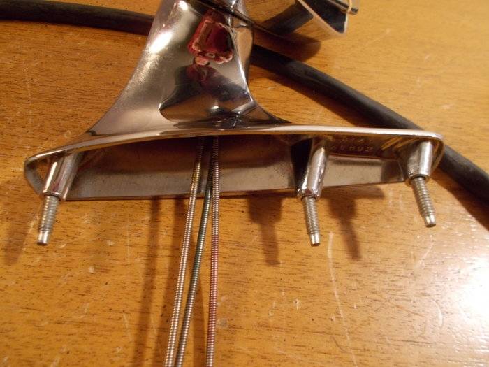

This area of mirror cable is where most used mirrors get damaged at. By prying on or pulling on the cables, you will kink the cables (which happens pretty easily). The mirror will pretty much ALWAYS go towards the kinks, thereby changing the adjusted mirror position.
A minor detail when removing a mirror – but a detail that has MAJOR annoyance.

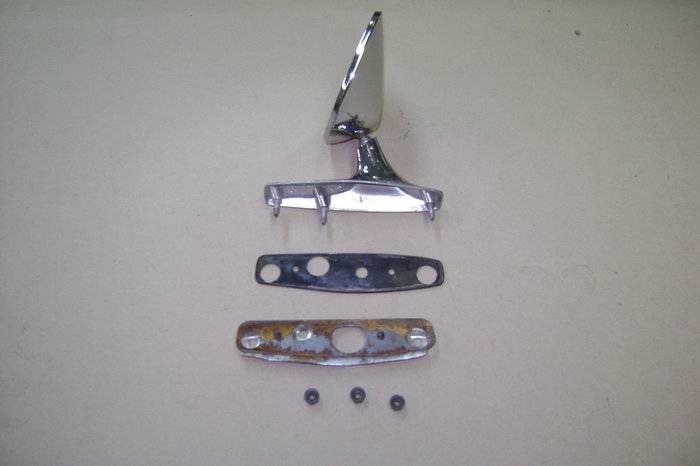

You are missing the mirror base gasket, metal backing plate and 3 nuts. You could install mirror without the metal backing plate, but mirror will work loose in time bending the door skin.
Same with the gasket. It doesn’t seal anything, per se, but keeps metal rubbing against paint.
(another swiped eBay picture . . .)
I “may” have the missing parts, this eBay mirror needs: the metal backing plate, nuts, gasket and dash nut (all used - but unseen).
I might even have (maybe) instructions for install, as well (I have a NOS Right side bullet mirror, to be used on my ’77 Wagon) – but have installed these mirrors before, so can tell what is needed for that, when ready.
The only “other” thing is the plastic trim for the plate that goes under the steering wheel – which I’m not sure that I have (if not, then I think I know where one can be obtained, at).

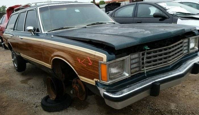

The best thing would be to find a similar car that being parted out. There was a 78 Diplomat on eBay that was recently listed as being parted out.
(PARTING OUT THIS CAR) 1 LUG NUT 1978 DODGE DIPLOMAT 2 DOOR WITH 318 78DD1-LN | eBay
I contacted him about the mirror, and he said he would list it, but it never came on. Maybe he changed his mind, since I can see the ad was debated here and some people urged him not to part it out.
D
Deleted member 1959
Guest
I see the 78 Diplomat is back. I have just asked him to list the RH mirror.

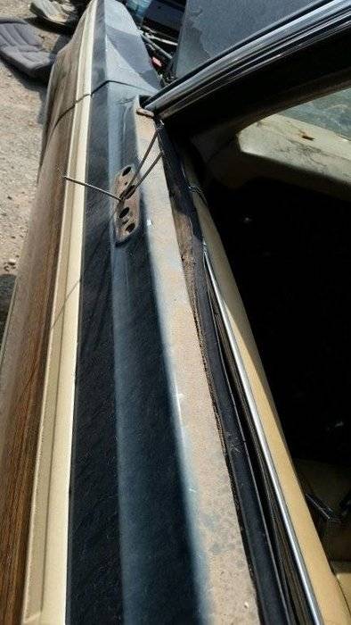

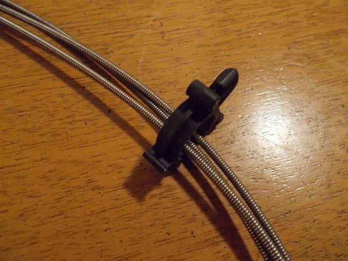

There will be one, or two, of these black plastic loops inside of door.
PLEASE tell the seller to cut the loops and NOT to pull on the cables!
You can purchase, or fabricate, something to place into door to keep the cables from interfering with the door glass. Kinked cables are impossible to “un-kink”.

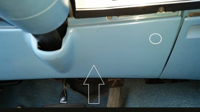

If you do get the used mirror, be sure to also get this panel (white arrow).
This part has to be removed to access the dash nut, anyway.
It will have a hole cut into it (roughly where the white circle is located), and a trim ring. You can cut our original panel (if you wanted to) or dye the replacement panel and trim ring to match.
The trim ring is the part that is hard to get separately.

There is a hole in dash and clips along it path already in place. If a person gets the under steering column panel, then no dash cutting is needed.

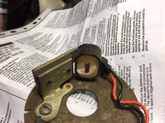

I just changed the reluctor and the pickup coil. The coil was pretty rusty, but the change brought no improvement in the way it idles. It still has little "dips" in revs every 3-4 seconds.
Bud: I did ask if anyone had tried de-coking an engine with club soda in #28; hence the answer from Rustyroger :)

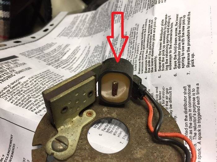

Pickup coils do go bad – either totally dead or only go bad after a heat soak. Primarily at location of red arrow. The problem is it is hard to get pinpoint tests done to it due to its location – when/while car is acting up.
It is the cheaper item to replace (than computer) and does have a good percentage chance of being the problem.
It if was replaced and still doing the same thing, then the two other items are suspect (computer or fuel line vapor lock).
