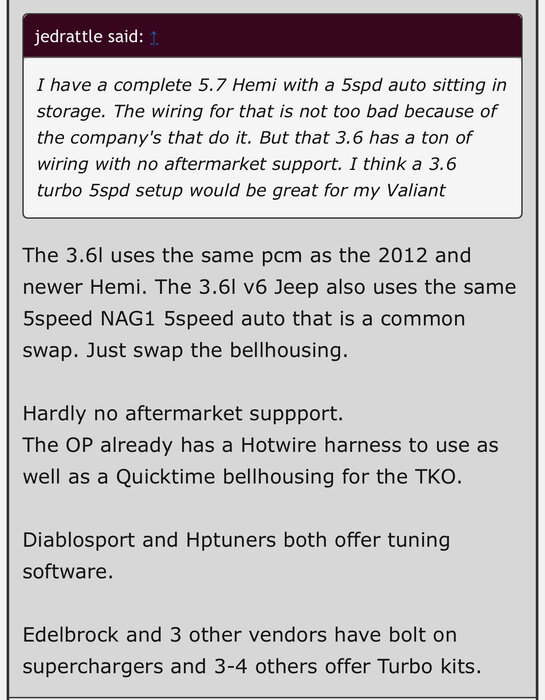

Gen3 hemi or 3.6 pentastar swap. 305hp 270 lb/ft of torque ain’t bad for a v6; slap a turbo or two on it and, off to the races you go.
Could do a full tubular front end swap with control arms/coil overs/disk brakes for like $4-$5k and have a damn solid road race car that’s nimble AF, lol.
1,833
1,040
Nobody makes an aftermarket ECU for the 3.6L. One guy over on FABO successfully swapped one into a Dart, but you should see the hell he went through to get the factory ECU to work. Would have been easier welding a Dart together around the existing car.

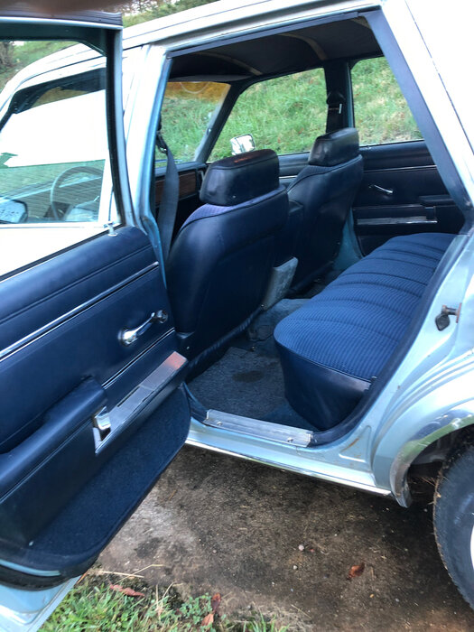

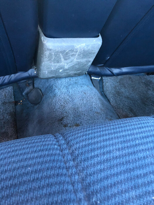

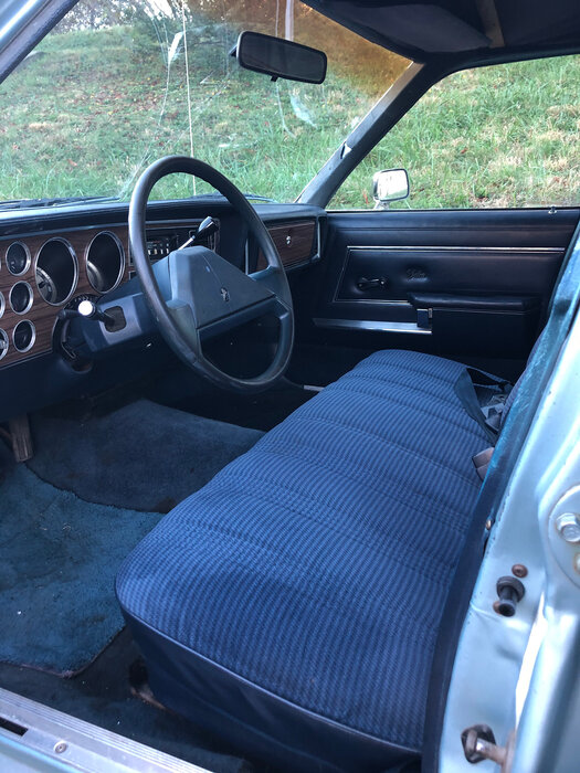

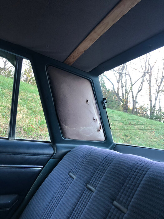

Well, I'm home for the night, and before I ran out of daylight I fixed my flashers and relays. Still need to replace all the bulbs in the right rear, so I'll likely just replace all the bulbs whenever I'm home next time.
I got interior shots this time though.

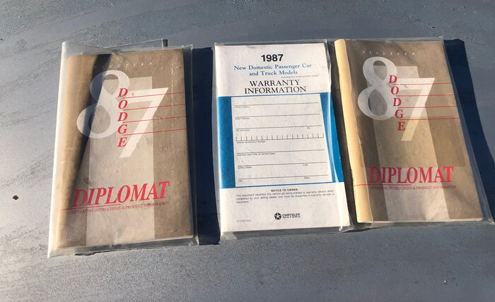

And it has the original owners manuals too.
Next time I'll also see if I can find the build sheet if it has one.
Lightning II
Sep 24, 2020
239
108
Augusta, GA
Safe to say that my original paint color choice has been vetoed now that I've seen the interior in better light. I'll probably go with Midnight Blue, so the nearest shade from the catalog back in the '80's.
