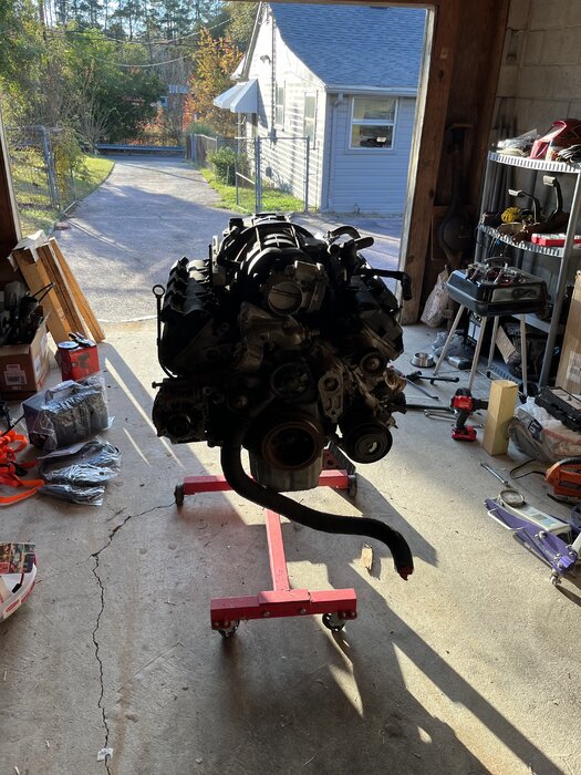

Going to pull the heads off tomorrow to see how the pistons look….or I might use that el cheap scope I got off of Amazon and just pull a plug and stick the scope in it instead.
If the weather’s good the 318/904 is getting pulled this weekend.

Great power and mileage . I'd seriously consider doing the swap if I had easy access to the parts. 360 swap has been fin but a pig on gas.
The lifters depend on year. It seems ro happen more with the 09 and newer engines. Idle time doesn't matter much its a defect with the lifters themselves. There are a lot of people whove had them fail with limited use. They made some changes to them which helped but there are still failures. Definitely worth checking what the cam and lifters look now to save some work. Some earlier years also had valve seat problems.

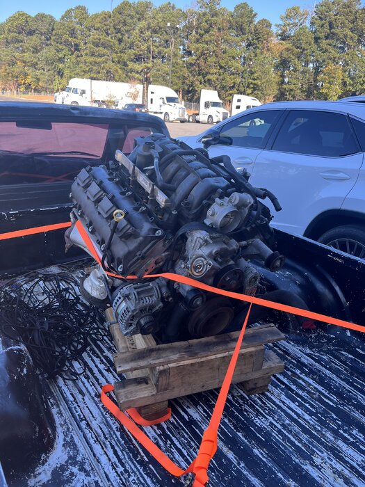

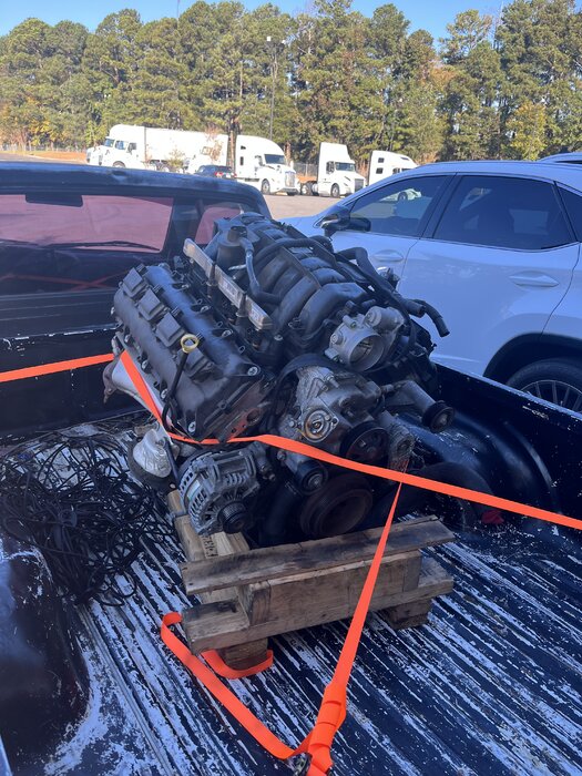

checking the cam/lifters has been pretty high on the priority list when I started looking at used Hemis. Mine's out of a '13 Chrysler 300 that got rear-ended.
The guy was trying to sell me the rest of the front suspension to go with it :D

Long idle time tends to increase chances of lifter failure. Early gen2 Hemis have failure of the lash assembly, especially in the MDS lifter, and they fail the roller same as the later engines do, just not as often, usually due to the oil used in them.

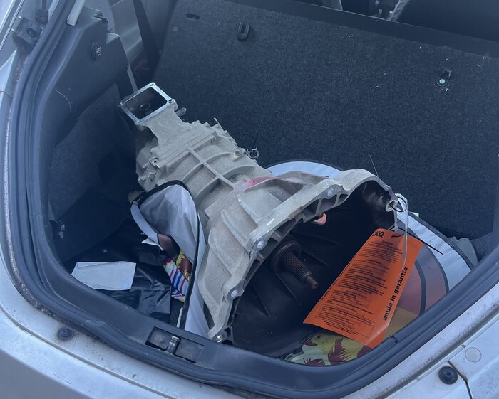

Bought an AR5/MA5 5-speed.
Now to get a compatible bellhousing.

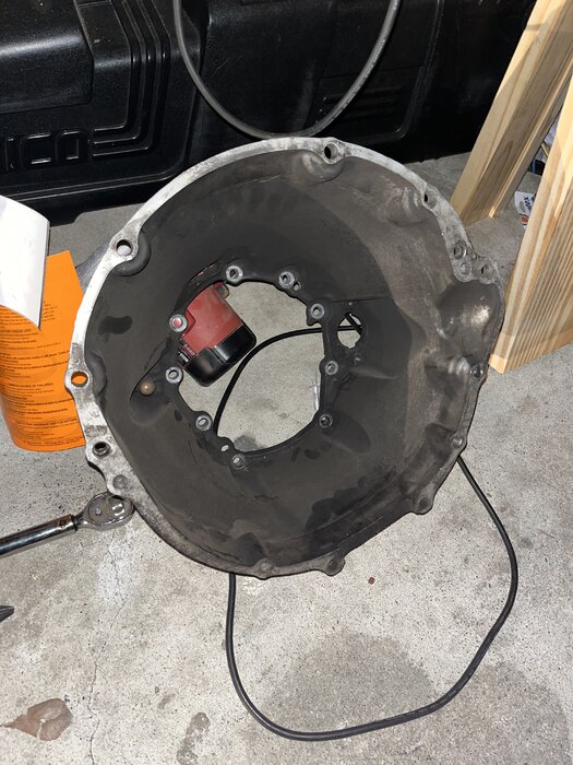

EDIT: well, I got lucky and found a bellhousing off of an '02 Liberty that'll bolt onto this thing. Should be here next week.

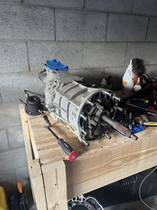

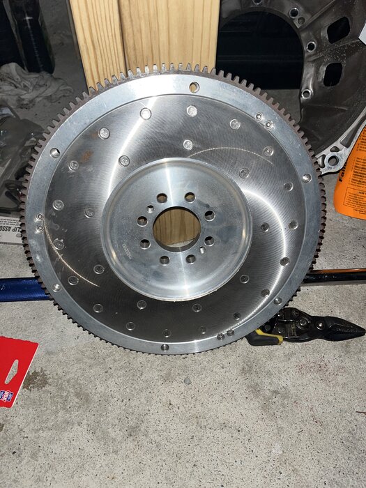

And now the Bellhousing and flywheel have arrived.
The flywheel is MP P5153593.

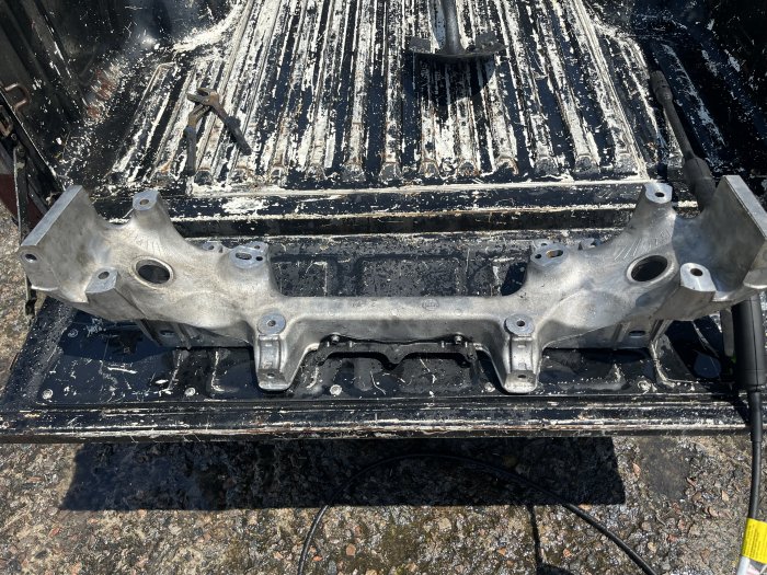

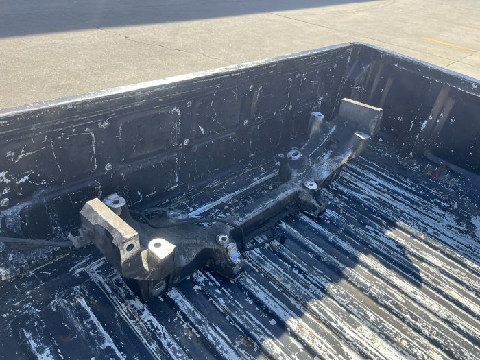

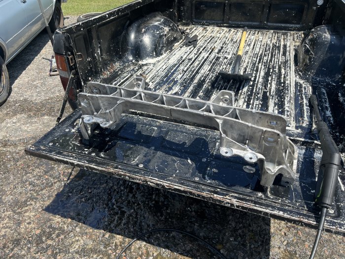

Also…got the first piece of the possible front suspension conversion earlier this month: the front crossmember out of a ‘96 SC300. (Only cost $120!)
Then today I hit it with the pressure washer and a wire wheel on the drill:
On initial inspection, it does appear that the mounting holes match up with the front frame rails, but I might need to add a bit of metal to get a flatter surface for it to bolt on to.

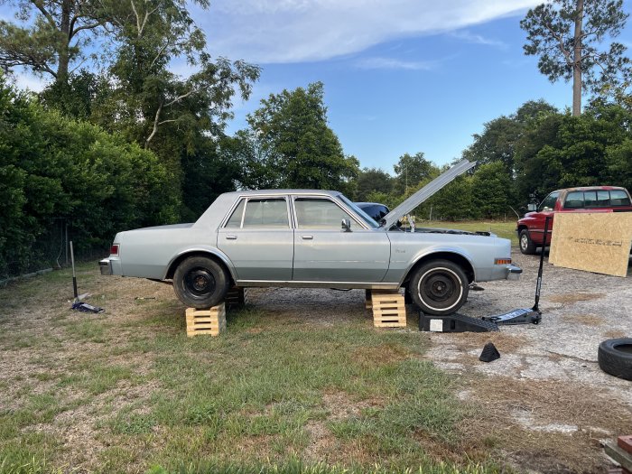

Well, after only getting to update the engine’s thread, I can finally start updating the car’s thread.
It’s 90% up on some more stable stands.
