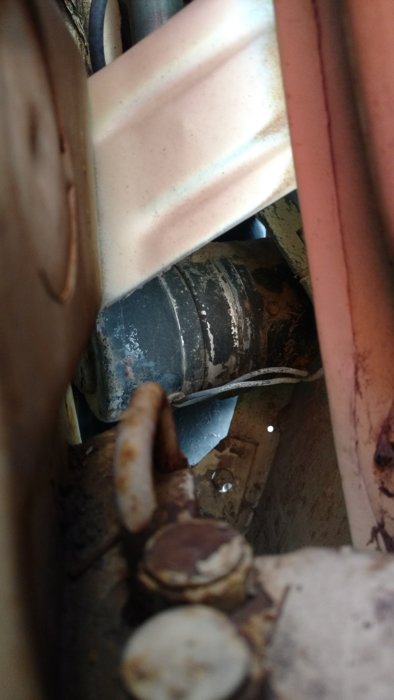

Mine is only the AM/CB transceiver, not AM/FM/CB. It is a bit marked up because of the original owners cigarette habit and bad ashtray aim. I have only tried it a few times because I don't want to put stress on the power antenna before I can rehab it. It doesn't retract all the way down into the fender, leaving about an inch or so above. The antenna automatically raises or lowers when you turn the radio or CB on or off. The power CB/radio antenna was a one-year-only item for 1978, and came standard with the CB. Subsequent years had a fixed CB/radio antenna.

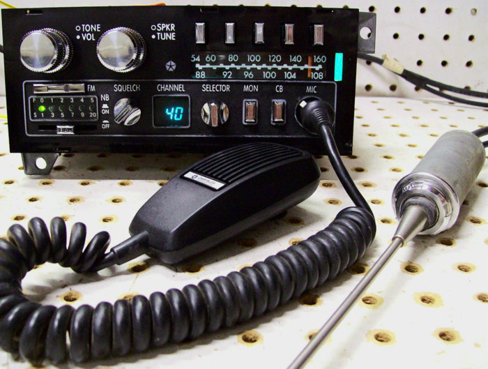

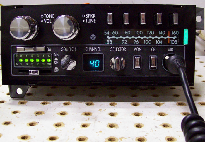

A few years back, I bought a very nice AM/FM/CB with mic to replace the AM/CB in OY. I have yet to get around to installing it:

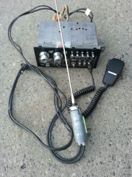

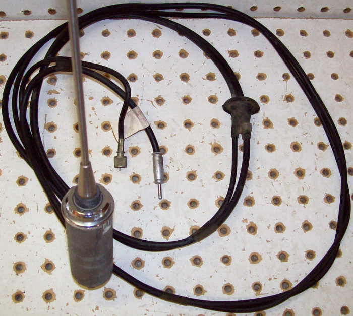

Here are a few internet pics of a "fixed" CB antenna from '79 on:
Here are some pics of the '78 power CB antenna inside OY's fender and the NOS one that I bought recently from Marty. It is the only one that I have ever seen for sale, and I wasn't about to let it get away.
And finally, here is a nice internet pic of a AM/FM/CB transceiver that was for sale somewhere a while back, EB maybe?:

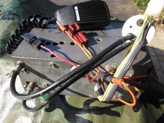

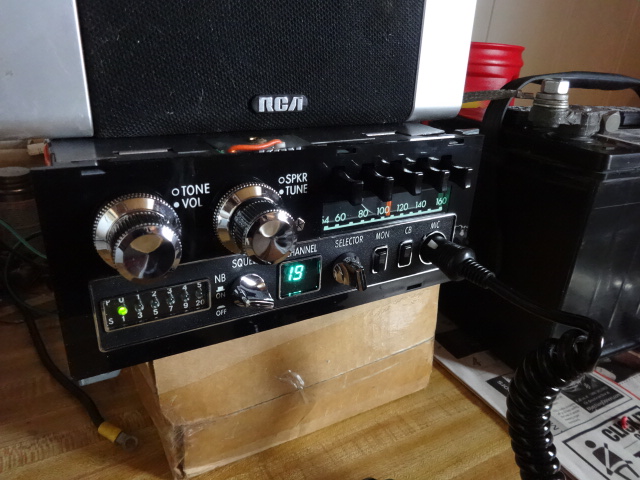

Took longer to get the parts together then to wire it and test.

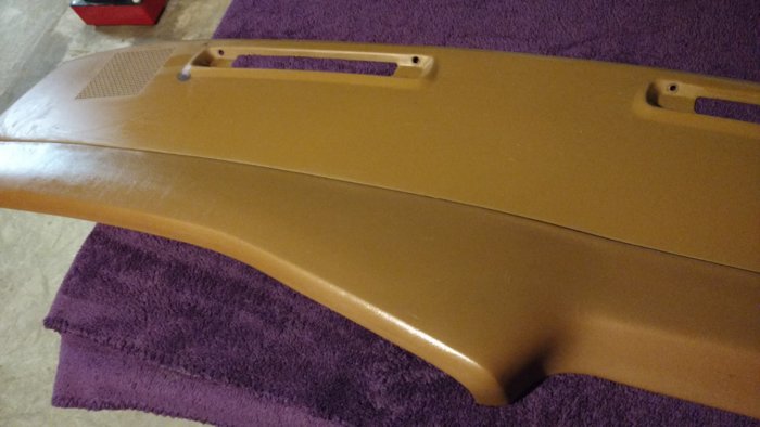

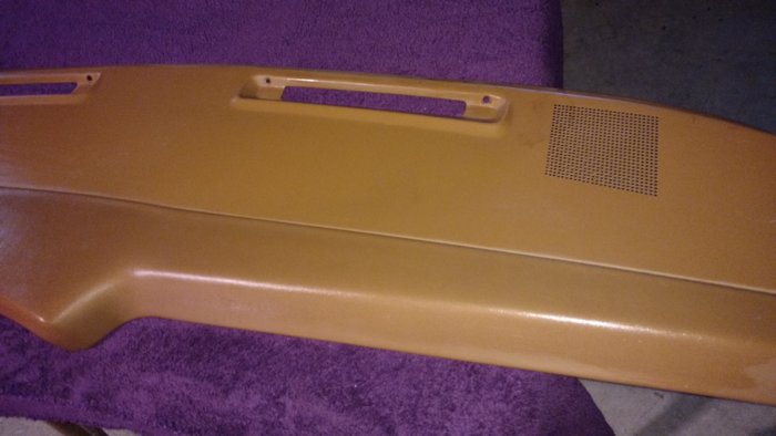

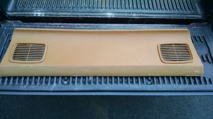

Another reason for being stalled on this particular project with OY (installing the sound system) is that I am not sure exactly how and what to do. The original single dash speaker is no good, as is the original dash pad which baked and cracked in the desert sun. However, I have an almost perfect dash pad and two speaker dash top to install out of my deceased T-top, which I want to use in conjunction with the two speaker rear hatch cover and speaker brackets that I got out of the black Oklahoma parts wagon:
The "new" AM/FM/CB unit is stereo, and is most likely wired to handle the stereo set up of two speakers on the dash, and two speakers in the hatch, but I am not sure exactly how to do it since the speaker wires for this never existed in OY, and I would have to splice in new wiring to all speakers from the AM/FM/CB unit, which ordinarily would have just been plug in and play. I'm sure that it would not be very difficult, but I have never had the time or inclination to sit down and figure it out and just do it. Running wiring for speakers is a pain, and would be a bit tricky to get them running into the hatch nicely. Even if I do all this, it will still be a very "old school" sound system, when what I would prefer would be a modern one. Hummmm. o_O

I will post the ele. paperwork I got with this unit, sorta diff then the norm.
I was able to test it against my hand held deal, I went maybe 1/2 mile out in the field and it was good.

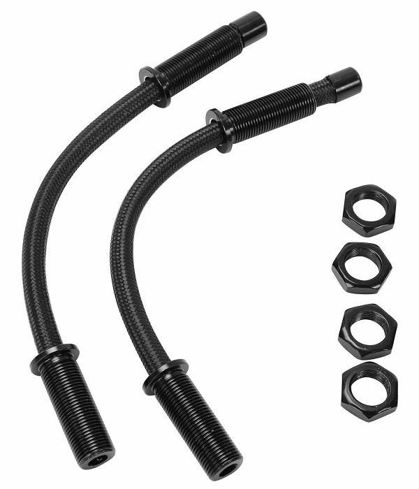

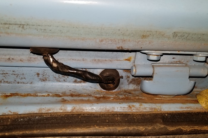

For tailgates (or doors), I would run a separate wire for ground on the body side (but don’t place ground on the tailgate/door). Most aftermarket speakers are marked with a “+” and “-“ (or a paint dot close to the “+”). The “-“ goes to ground and “+” goes to radio. It generally will not damage most older speakers if you hook it up in-correctly – but the speaker output will be pushed the “other direction”. Some of todays speakers have electronics built in or dual cones (like the one shown on above post #37) – and those most likely will be damaged with incorrect polarity hooked up. It pays to pay attention to the little things like speaker wire polarity.
Do you have new speakers lined up for front of Old Yellow?

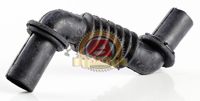

This picture is from drivers side tailgate on my ’77 Wagon. It does not have rear speakers (yet) – but does have rear heated (grid style) back glass. The knock-out holes should be in same location.

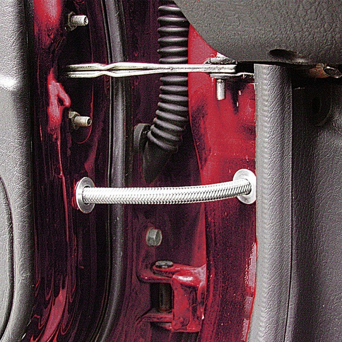

I would not have a problem with someone making their own harness for rear speakers. I would find a (out of lack of better word) fitting/tube/sleeve for “front doors” and attach it in same location. Most of these are water-tight so it should work good for you.
Rubber Door Loom Johnny Law Motors KICDLOOM hot rod truck custom muscle | eBay
12'' Black Stainless Steel Door Loom ~ Pair hot rat muscle pickup car truck v8 | eBay
Flexible 5/8" diameter door loom rubber tube ELE-4301-70-011 | eBay
There are other examples as well. The factory design (two grommets with exposed taped harness) is my least favorite.
