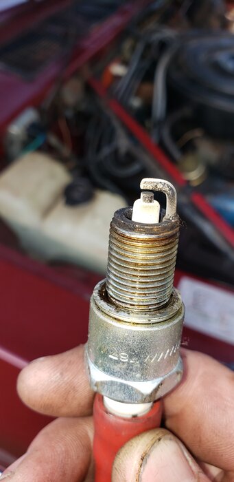

Plugs are new. Less than 1000 miles. I'll check condition this week. It really seems like a situation that could be corrected with the EGR being reinstalled. Or higher octane, less timing, more fuel, etc... 100% stock other than the EGR delete. It's currently operating outside of the design parameters which means adjustments to the remaining components would be required.

this is one of the plugs with deposits on it. Cylinder 5 and 6 have the most. But not bad at all.

That looks to me rather like its running lean... hence pinging.
But I am no expert.

I wouldn’t imagine the EGR delete would cause a lean condition itself. It shouldn’t have had THAT big an effect on cylinder temps or just have an effect off idle to part throttle but, I don’t know if the Spark Control/Lean Burn might be doing something funny to compensate for it being disconnected. I have no experience with them. It still sounds like a metering rod/spring/jetting issue to me.
My car had a Carter 2v, the Lean Burn delete done and EGR was failed shut/blocked by the time I got my hands on it. It drove great after a timing and carb idle/air speed adjustment. I’d still start at the carb myself. Get your wide band plumed in; heck just use one of those clamp/gasketed bungs for now. Make sure fuel/air/vacuum are all right before diving into the engine.

You might consider laying out all 8 plugs to read them all. The center two cylinders always burn hotter then the ends. If your plugs show this you can consider running one range on the 4 corners and another on the inner 4 cylinders.
