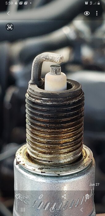

You might consider laying out all 8 plugs to read them all. The center two cylinders always burn hotter then the ends. If your plugs show this you can consider running one range on the 4 corners and another on the inner 4 cylinders.
Cylinder 5 and 6 look the leanest. I cleaned up the metering rods also. Considering getting one size smaller on the big end. Going to hook up a wideband in the next couple weeks also.
