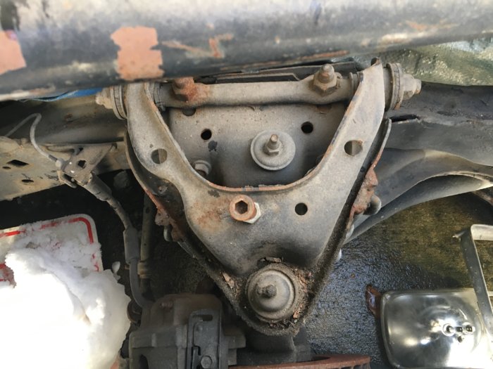

Passenger side viewed leaning over fender.

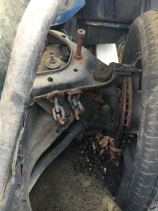

Next pic is pass side viewed from front

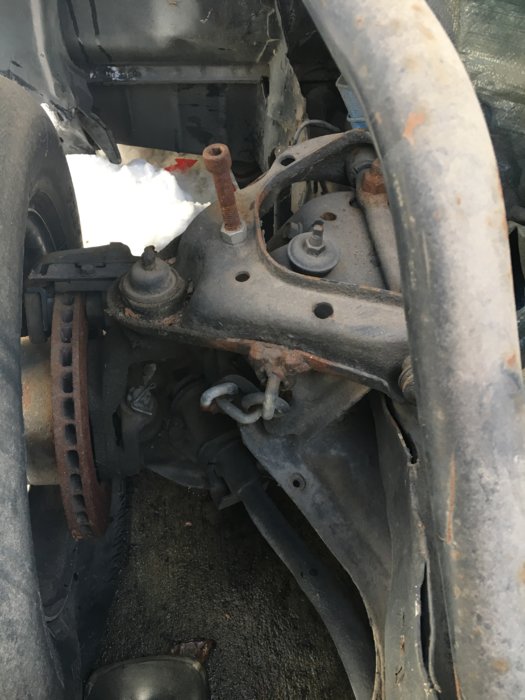

Next pic is driverside viewed from front.
Chains limit control arm movement during wheelies.......
I didn't limit droop but I limit compression, I've crushed two oil pans.
Busted ring gears.....
Ok, back to Stock front suspension, except for the chrome plated K Frame and Control Arms.... Wes gots more bling than any NSX, Yo! Lol
I wouldn't mind the Chrysler a bit!
Compression limit was done by spacing snobbers 2", It will scrape the pan every once in a while but not shove the sump at the crank.
