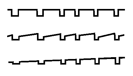

I've been having severe issues with my alignment. Every year the toe is really out of spec and I have wear on the outsides of the tires. Camber seems to be OK though as I installed shims to give enough adjustment. I can't keep the damn toe in spec though. Taking it for its yearly alignment soon and I'll have another printout to compare to last year's specs. Does these things ever stop sagging?
1,494
It sounds more like a Camber problem, than it does toe-in, to me.
When you have tire wear on inside or outside of tire - Camber is the reason.
Toe-in (or toe-out) will cause a feathering of the tire blocks where tire is scooted sideways down the road. A test for a toe-in/out problem is to run your hand on top of tire in a few directions (don’t do this if you have cords poking through the rubber!). If the tire blocks have high ridges on one corner – the you (also have) a toe problem. If nothing jumps out on the hand test – then toe is where it should be.
This is an exaggerated picture of what I mean, indicating toe wear:
Top is normal, middle is feathered edges from toe-in being off and bottom is camber tire wear.
You can have both camber and toe-in issues – but camber is what causes tires to wear on inside (or on outside).

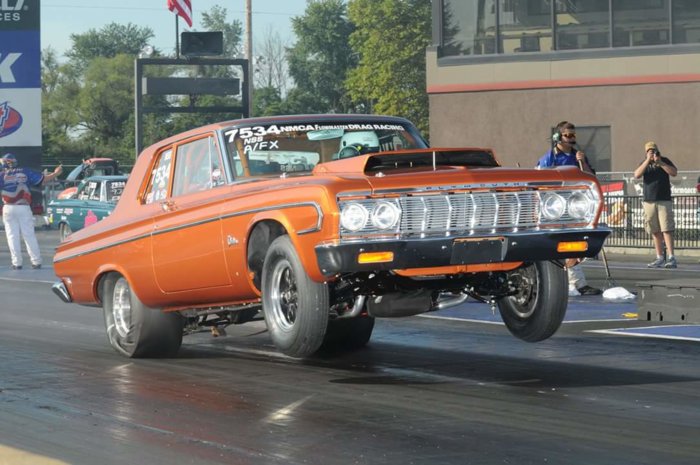

The stock suspension is overkill for drag racing. Good bushings and no worn hard parts. We have 3 stock front suspension cars. 76 Volare, 123mph, 62 Savoy, 142mph, and 64 Belvedere, 150mph. All drive great. As you can see the 64 has plenty of "landings".
Doug
LSM360
