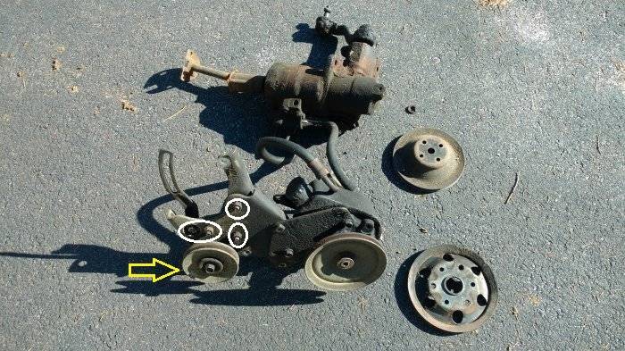

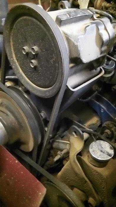

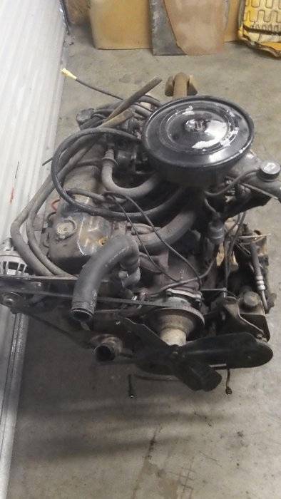

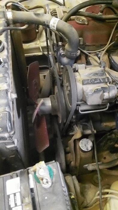

Before doing anything, I would remove the aftermarket A/C brackets from your bracket set (white circles) and I think you will be fine.
I believe the pulley (yellow arrow) is also for A/C – but not 100% sure.
That idler pulley is what I call a normally wearable part and might need to be replaced (if it is needed, that is). To check, give the pulley a spin and feel for looseness and for roughness. If any is present – then replace.
Next step is to take what you have in picture (but not the pulleys – unless you have a way to keep pulleys “tied down”) to a car wash – as is. Get some good spray degreaser and wash the dickens out of what you have.
Once done, disconnect the lines then drain the P/S system. There is no good way to drain it out – but you will want to do so, after it has been washed (to get rid of any water in system).
Parts will get somewhat oily after the fact – but it at least won’t be caked on greasy.
To drain pump, remove cap and turn upside down – into something. Turn back upright and give the pulley a spin a few times clockwise. Then, place a hand full of folded up paper towels underneath until ready to use. It will seep for a while – but not make a big mess.
To drain gear, turn upside down the best as possible, then spin input shaft a few times back and forth. A lot of fluid will come out. After a few times, you will be able to use the Pittman arm to spin it over – but not for the first couple of times. Place it upright, wipe off residual fluid – and it will be good to go on.
Use new fluid after installed.

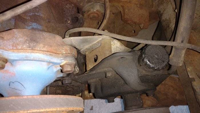

If rebuilding the coupler (which I recommend), it can be done with shaft still attached to gear, on the bench.
Your P/S hoses appear to still be good shape.
This would be a good time to paint items – if you wish to do so.
/6’s don’t have this problem as much as the 318’s with pre-cats, do. The steering gear input and output shafts seals are close by the driver’s side catalytic converter – which can operate at temperatures above 1,000’ F.
The reason I mention this is I feel that is a common reason why those seals leak on the V8’s a lot (my opinion only – no facts to back this up), is the seals burn up. I feel getting rid of (if possible) of the pre-cats and lengthen the lifespan of the power steering gear box seals (on V8's).
I don't see any significant leakage on existing parts – or it would be “oily” than “caked on” greasy – if that makes any sense.
1,492
You can reuse your existing P/S return hose (the 11/32” with yellow (or red) spring clips). That hose is low pressure and doesn’t give much problems. It doesn't appear to be leaking, in this case.
The pressure hose is one that people have (in general) burst on them, spraying high pressure fluid everywhere.
Note: if you turn a steering wheel to the end of rotation, then always back off a bit.
The P/S pressure spikes at end of rotation – which is what causes those P/S pressure hoses to burst.

Great – it looks like you have what you need.

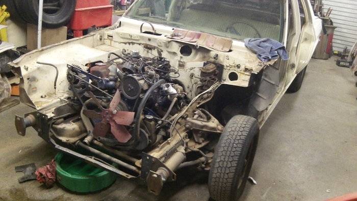

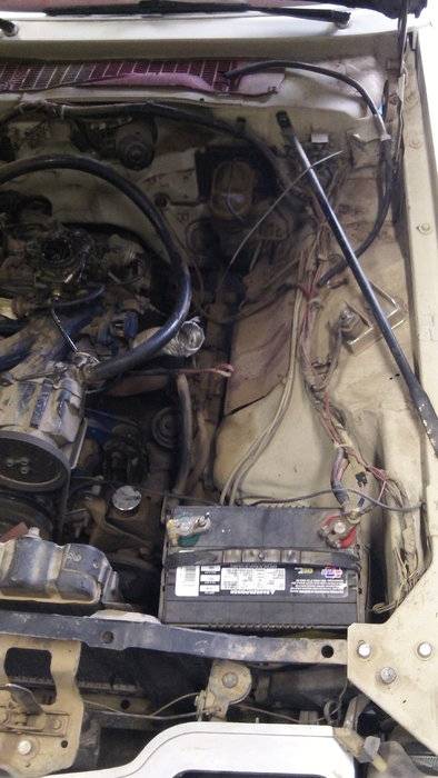

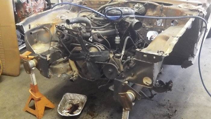

Yeah right, "progress". I have so little time to spend on OY it's really sad. But, I did get to take off the A/C part of the mounting bracket from the Aspen parts car, but it still doesn't seem to fit on OY. I need to play with it some more, but I am guessing that I need an entirely different bracket from a NON-A/C car to mount the power steering pump on OY. Here is a pic of OY as it is with manual steering (LOTS of room down there):
Does anyone have a pic of the power steering pump brackets from a NON-A/C F body that could show the bracket(s) that I need?

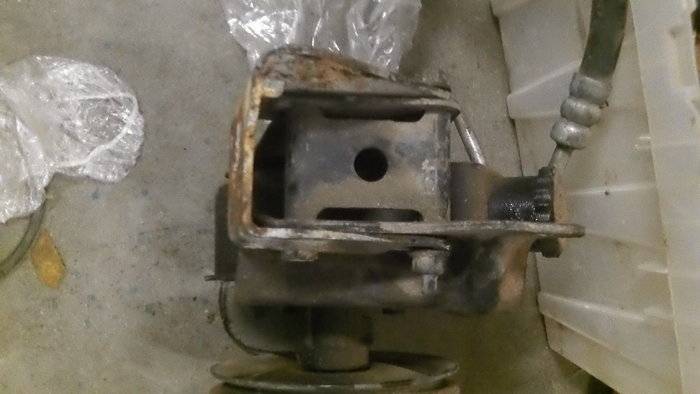

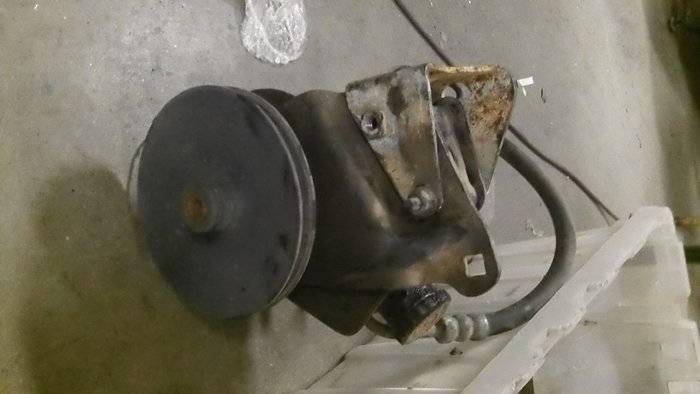

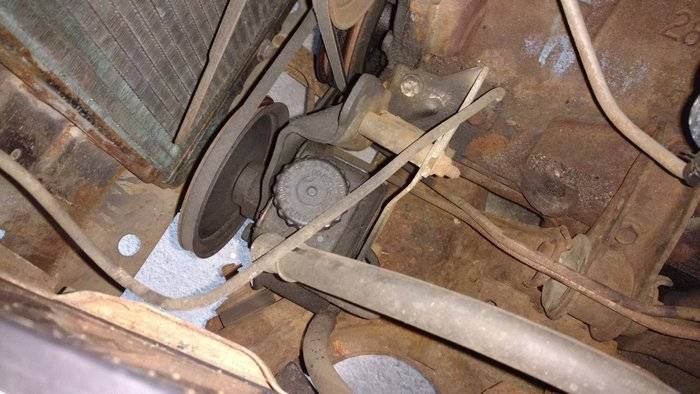

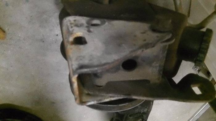

Thanks Jim. I don't think I have those pieces. Not the "curved" black bracket that is mounted to the front of the pump, or the two (?) silver brackets that mount to the engine block with the long mounting adjustment bolt through it. I do think I have one of the silver engine block brackets, but whether it is the right one, I don't know. I have to go over to where I have OY stored and take a look at what I have in the box again. Here are a few pics of the brackets on my friends '75 Dart Sport, power steering with no A/C. Looks like the same brackets that you posted above. Maybe I could use brackets from an A body? Might be a lot easier to find.
F body Deconstructor Jim
Jun 19, 2011
557
135
Phoenix, AZ
I would bet the brackets will be the same on the A body.
Its been a few years since I tore down a non-a/c slant F so not too sure I have the pump bracket you need.
I do have a couple of the pieces that mount to the block so its possible.
