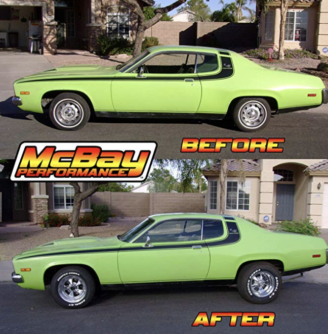

Anyone use McBay Performance leafspring shackles? I just ordered a set. Adjustable ride height from 1”- 4” should give a nice aggressive street look...and knock out my wheel rub
Adjustable 1"- 4" Lift Rear Shackle Kit for 1960's thru 1970's B-Body, C-Body & M-Body Mopar's

Wow, overpriced IMO. I don`t like using them as they can take a marginal spring and flatten it out. They do look better quality then the MR gasket ones for sure. I would have just used air shocks with just enough air to keep from rubbing. Hopefully they will work out for you.

The problem is that using a longer shackle to adjust ride height isn't great. When you make the shackle longer it makes the arc of it's swing slower, which means the suspension reacts more slowly, which means worse ride and handling.
If you haven't got the dough for new leafs I understand, but in my opinion it's better to save up for that than use a less than ideal part.

I love the before and after. They couldn't even use the same size tires for a direct comparison.
