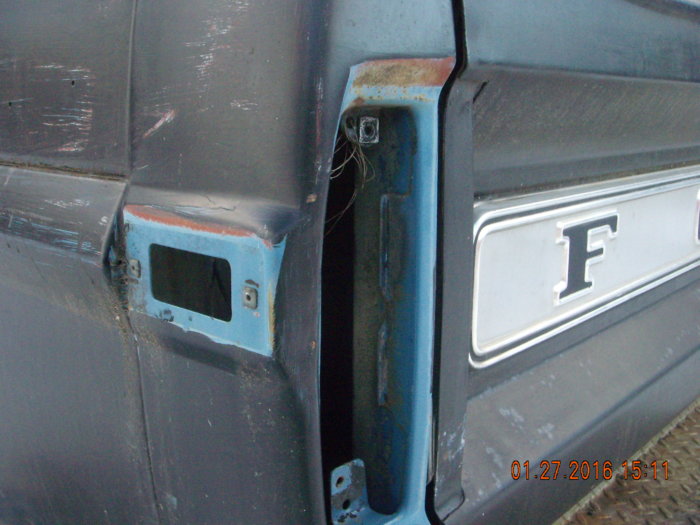

The rack n pinion from the panther series bolted up to the 67-72 F-series when adding a couple of plain brackets. The Mercury had it too, the Parklane or Turnpike, forgot the name.
Poly
Jun 15, 2018
137
21
USA
To line up with the rack and pinion, flip the axel...and shazaam...lol

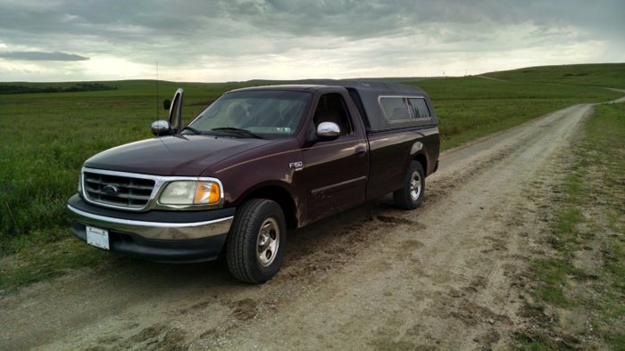

Several years ago, I bought a 2000 F150 XLT. It was hard to find because I wanted a two wheel drive and a standard cab. It has basically been just "ok". RUST in places I didn't think it could (how can the vertical radiator support get giant rust holes in it?) Leaks like a sieve. Electrical system sucks. It has the Triton V8 which is fast, but likes to fry spark plug coils, and I wouldn't dare touch the spark plugs myself for fear of stripping the one or two threads they are held in with. Slop-o-matic transmission. I only use it for hauling mulch and junk from Lowes now. An "ok", but essentially disappointing truck. These pics are from Kansas when I drove it out to strip the black Volare Premier parts wagon in Oklahoma.

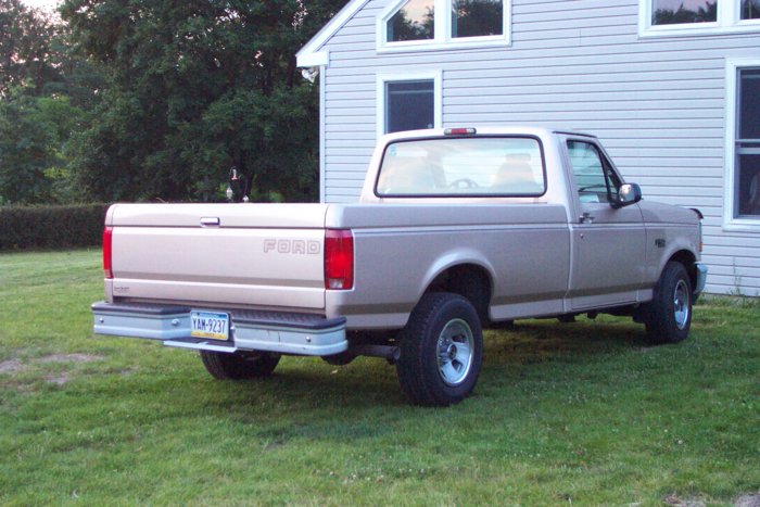

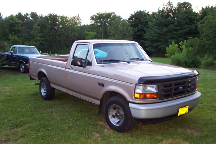

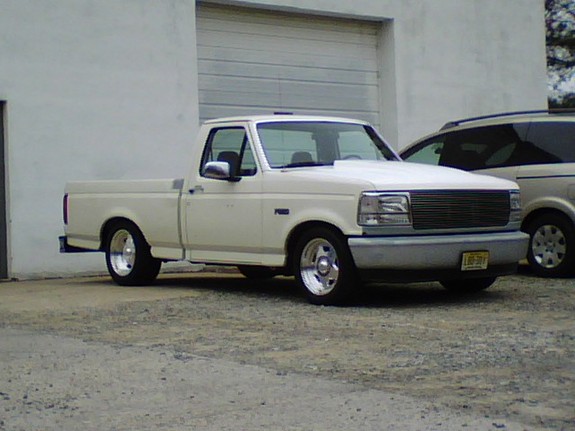

I have a similar truck, 93 F150 regular cab, short bed, 2wd, 300 l6, 5-sp. It was my daily driver up until I bought my Ram last year.
Getting ahold of a Mustang GT parts car seems to be the most cost-effective way of getting toward Lightning greatness.
I personally like the turbo or supercharger on the l6 idea. After some internet research I learned that the F150 Lightning was an almost completely different animal from my workaday F150 w the vinyl bench seat and manual windows... they can be made to look the same or similar, but it'd be cheaper to just buy the Lighning by the time you figure-in suspension and chassis mods.
My approach was going to be to take a different path... KISS principal. Follow what police and military do w their vehicles, ie: add beef, boost, and badassedness w/out fluff. Keep it businesslike w steel wheels (Lightnings use 17x9 with 4.75" bs) and bench seat, but lowered a bit for attitude. Just make it an interesting DD. The body on this thing is just too good to not be used for something... 0 rust or dings. The plasticky-plastic 90s interior has 0 cracks... a real time machine, I could scuff-and-shoot today if I wanted to change the color.
My 93 will be up for sale soon, my newer Ram has taken precedence and dominates the minimal time and money I have to dedicate to unnecessary vehicular modifications. Not ironically, my bare-bones Ram is taking on a similar "customization" arc as the Ford was on.
