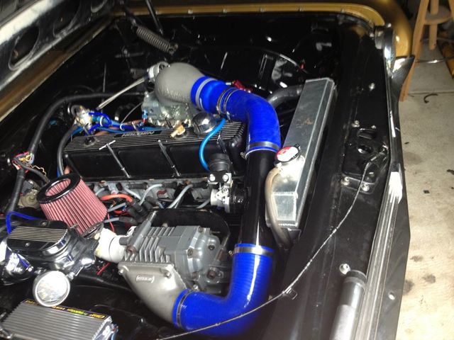

Something similar to this:
Only reversed. This is an M90 on a Holden I6. Remote mounting will enable me to plumb it for intercooling and it should be good for a 5k redline; which would be about the limit of an I6 rev range anyhow.
It would be different and pretty cool.
