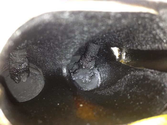

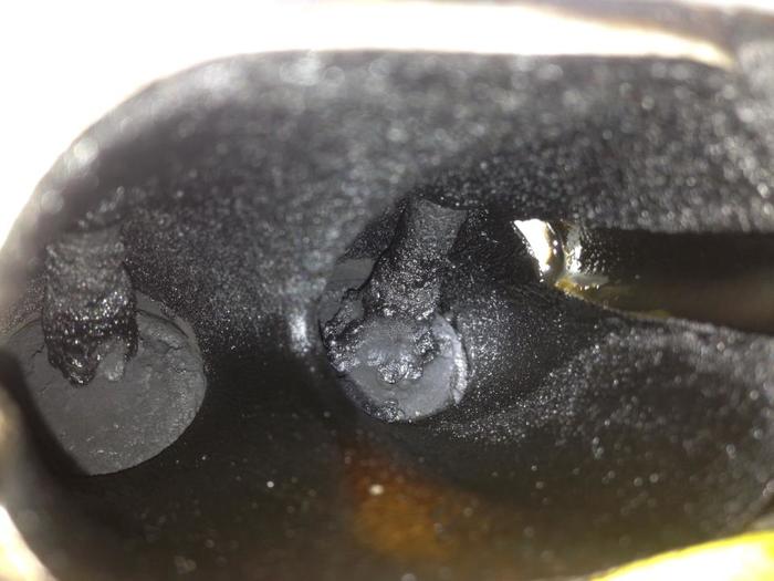

Ok this is what PCV does to a direct injected engines intake valves, you think its pretty good eh?

Which valves are those?
You say that the PCV is to blame for that?
Well I don't know chit about Direct Injection, but I do know about PCV, and I'm not trying to be a jerk, but you would have a very hard time convincing me,to blame that coke on the PCV.
Direct injection has a high pressure pump and the fuel is pumped straight in the chamber like a diesel. With a carb car or conventional EFI car that dumps fuel into the intake manifold the fuel washes against the backs of the valves to keep them cool and clean, direct injection this doesn't happen, the PCV sprays a mist of oil into the intake which sits on the back of the valves and cokes up and those photos are what your lovely PCV system does. Worked find for old setups but is proving to be a problem for this modern stuff, BTW this is the way forward, California emissions laws and European laws have forced car manufactures to go to smaller turbo engines to meet the emissions standards. If you hang around long enuff on this planet you will see it all happen, Ford is just one step ahead of all car makes in the USA! In Europe they are saying Naturally Aspirated engines are dead now! All will be turbo, its the only way at this stage to meet the new emission standards.
In NZ we are seeing Hyundai compact SUVs with 1.6 turbos, Volkswagen are doing 1.4 turbos now, we are seeing quite a few ford models here using the ecoboost and even mustangs here can be had with a 2.3 ecoboost, Aussie falcons had the 2.0 ecoboost.
I'd be more inclined to blame that on cylinder pressure finding it's way into the crankcase, and from there overloading the valve seals. I'd be experimenting with figuring out ways to reduce the blow-by, or to improve ventilation, or to increase the intake valve temperature. That looks like a lot of carbon in there as well, and if so, how did it get there? It's supposed to be direct injection. The only way for that to get there, is back past the intake valve with a late closing ICA and the piston pushing it back up in there. Well I suppose with a turbo, it could come around thru the overlap cycle, but that's a bit of a stretch.

Cleaning the valves is a lot more involved (picture from post #46).
