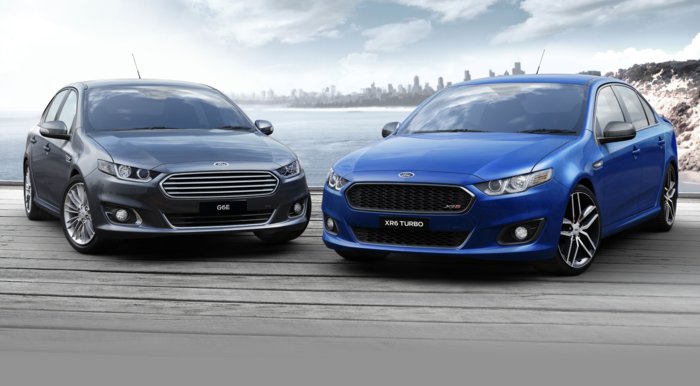

Fords last offering

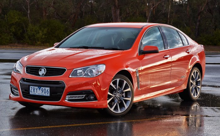

GMs last offering

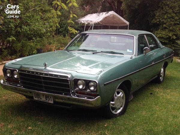

Chrysler last offering

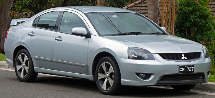

Mitsubishi's last offering designed in Australia

Well I guess it goes like this, you either embrace the new modern technology or you don't, turbo engineering has come a long way now. Variable cam timing is accepted now and direct injection is more common place, if you ask me (and don't get me wrong I love my mopar V8s) Ford is onto a winner!
Lets put it into perspective, my 2.0 in my falcon is faster than a 4.0L double over cam, variable valve timing straight 6! Its lighter, uses less gas (not heaps but less) has to use less at the stop lights. I admit the burble of a four is not as smooth as a 6 and not got the rumble of a V8 but jump inside and you can't hear the engine, but you think you are driving a 195Kw 4.0 6 cylinder!
Just to let you know the ecoboost falcon was a flop, it didn't sell well at all. not because it was bad or had issues but people just couldn't get to grips with a 4 cylinder under the hood! Falcons has been a 6 for the last 50 years!
I talked to our local Ford dealer and he said they were awesome, not many around, not good sellers, he said the Mangers at the local ford dealer ship drove them and liked them but it didn't flow down to the buying public. His last comment to me was, they were faster than a 4.0!
Well I remember the off shoot of the 4 was it handled a lot better with the engine sitting back a bit and less weight on the nose! The reviews all noted how well it pointed and how well it cornered with the wait off the nose.
I can tell you this, there is a very slight hesitation for the turbo to come in, town driving its not noticeable, just when you take off quick, but its a everyday economy driver and it does exactly that!
