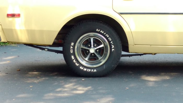

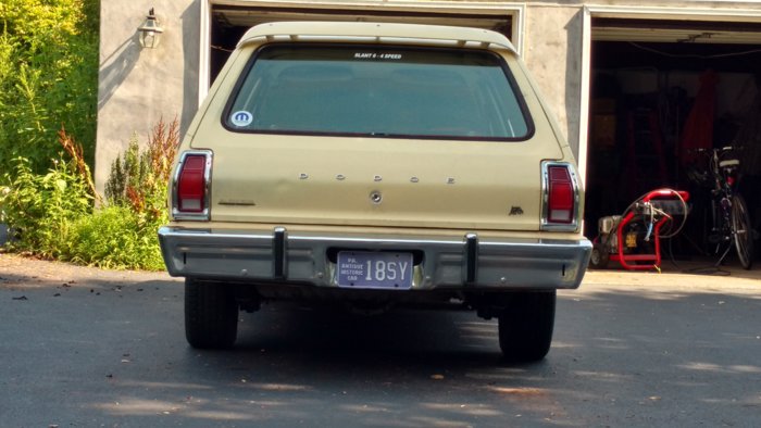

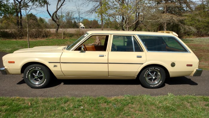

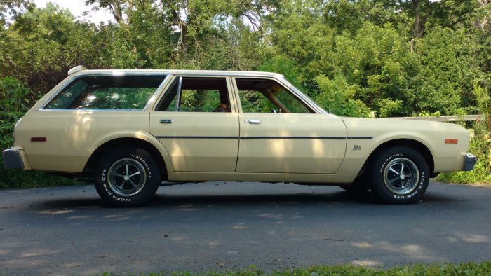

However, I did get the new leaf springs and all four shocks on, and I am very pleased with the stance OY has now. It's just what I wanted! Sits up just a bit in the back, but not too much.
Before:
After:
About the KYB's. Turns out they're stiffer than a 18 year old, well you know.:p Had them on my car until recently, and now switched to Monroe OESpectrum's. Much nicer ride.
Unfortunately, I think Aspen500 might be right. I didn't drive it much, but the ride seems choppy and rough. I have the KYB Gas Adjust on all four wheels, and it might be too much. OY is a cruiser, not a performer. So, I am not sure if I will keep them on or not. I'll have to drive it some more to see.

OY looks like he has that new car stance now! How many leaves did you get in the new rear springs? how many leaves did your old springs have?
Thanks Darth-Car. I'm really happy with the new look. The difference is very noticeable to me. It made me think of what OY must have looked like as a new car sitting in the lot. :) The new springs have five leaves in them, as did the original ones. I think all wagons came with five leaves.
