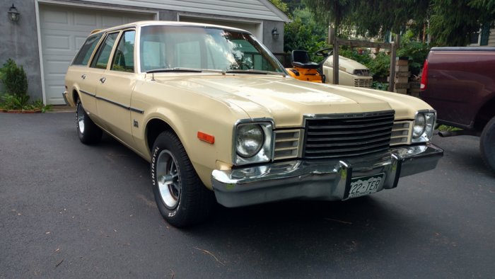

Ok, so now I have my neighbor working on OY.

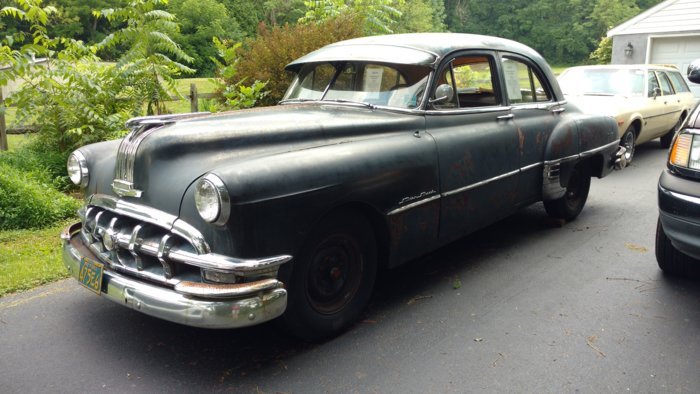

He is an 84 year old life-long mechanic who seems more like 63 years old. He's a Buick man, and has restored several including a '63 Riviera which he just sold for $$$, but still keeps his favorite, a '63 LeSabre coupe that he has restored to PERFECT like new condition. He got my '50 Chief running smooth as silk, so maybe he can purge the gremlin(s) from OY.

I also decided to have him replace the rear springs and hardware along with all four shocks on OY as he is much more set up to do it with a lift and all his tools (and experience). I bought KYB Gas-Assist shocks all the way around, and NEW leaf springs and hardware from "Springs & Things" (thanks Duke5A for the recommendation):
