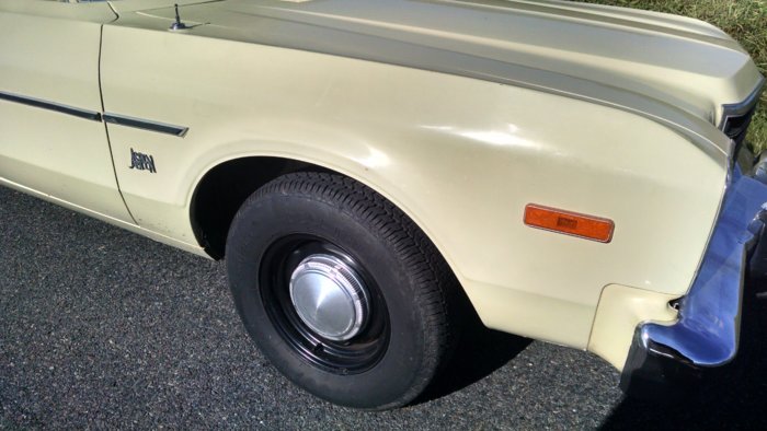

Lol. It's been a LONG time since I used CB. As I said, the original unit in OY doesn't seem to transmit. I was able to pick up some truckers over in NJ and down in Delaware a while ago, but they didn't respond to me when I tried to break in. I haven't tried it much since. I don't like to use the power antenna until I can find out how to service it. I don't want to risk breaking it as it is the special CB/radio power antenna and I don't know where I would ever find another one. It already doesn't retract fully into the fender, leaving about an inch or two above the fender when it retracts. So, for now, I don't use it.
old yellow 78
Aug 28, 2015
1,307
454
near Allentown, PA
I used the above pic to show how the antenna doesn't fully retract. I wanted to try to circle it or put an arrow pointing towards it, but I don't know how. I see others are able to do that. How?
XfbodyX
Sep 9, 2015
1,725
499
Central US
Did they fully retract when new? I know of one really nice 78 with the cb deal and ive never seen the ant. fully down.
I really don't know. Seems kind of odd that they would design them to stick up a few inches though. It's always been that way on OY since I bought it, but then I've only used it maybe ten times or less.

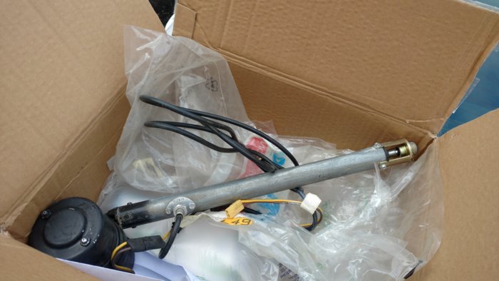

4048257 POWER ANTENNA PKG /TRI BAND U4048444 1978 H,N,F,G 1 125.00
Marty has an NOS Tri-band in stock.
Many thanks again 7T8 Custom! I bought this NOS tri-band antenna still in the mopar bag from Marty for a spare. They are extremely hard to find in my experience, so I didn't want to let this one get away. Agh! I can't wait for Spring to start assembling OY and all the toys for it. I'm going to show it this year - hopefully - if I can get everything else caught up. o_O

I got the Tri-Band power antenna from Marty, and am very pleased. It is a nice unit, and Marty was good to deal with. I'm going to try Darth Car's suggestion on my original antenna first, but at least I have a spare now. I think they are fairly rare as they were one year only (1978) on the F's. Not sure about the other Chrysler products of the era. Thanks to both Darth Car and 7T8 Custom for your help! ;)

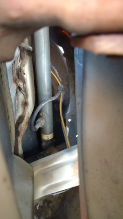

Here's a pic of the original on OY currently:
