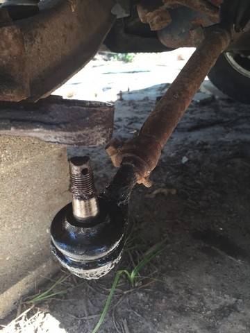

Each tie rod has a vertical tapered, threaded shaft and near the top of the shaft is a hole.
Once the tie rod is in position, you thread the castle nut on it and run it down far enough that you can see the hole inbetween the 'cut outs' on the nut.
Then you put the cotter pin in the hole and bend up the ends on the other side so the nut won't back out.
Course, I was taking it off so - cotter pin out, nut off and tie rod shaft backed out.

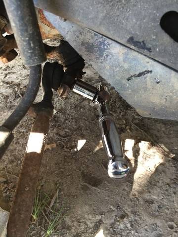

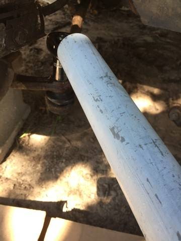

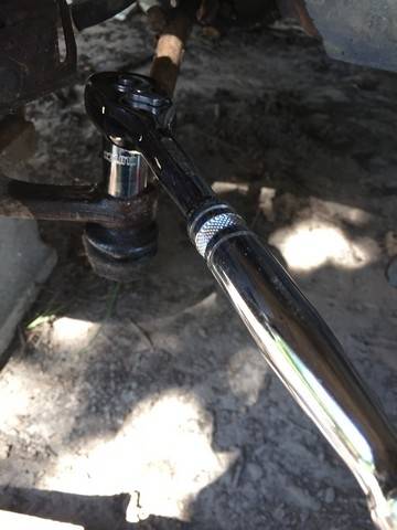

Socket on the castle nut.
breaker bar for leverage.

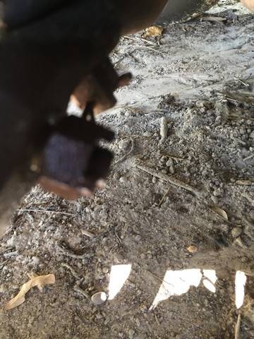

lovely dirt shot

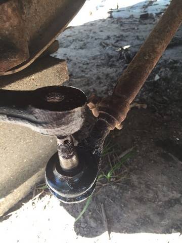

Once the nut is off, you will be tempted to whack it with a hammer.
Don't.
IF you want to use a hammer cause you don't have the special tool, then take the castle nut flip it upside down and thread it on the end of the tapered shaft (cut outs going towards the tie rod).
Only run it down far enough to meet the top of the shaft.
WACK that with a hammer.
If you run it down too far, you wind up with a castle nut trapped below a squished shaft end.
If you don't use the nut, you wind up with a squished shaft end.

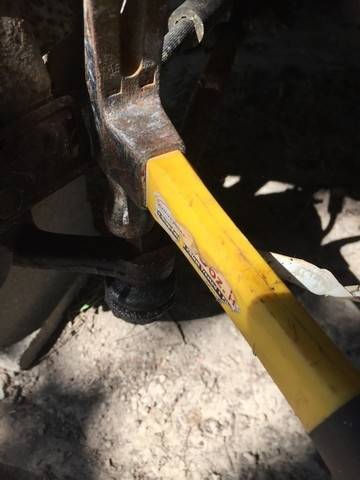

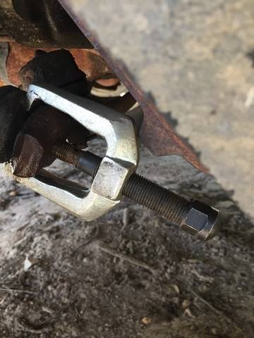

Far better to use the proper tool.
Set it up and use a box wrench to wind the center theaded shaft down until the end pops out.

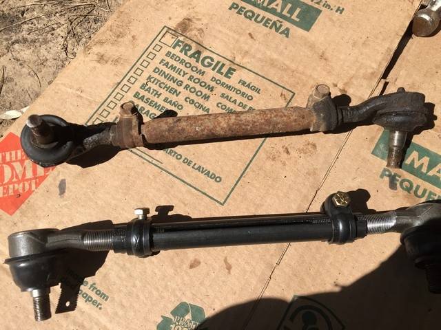

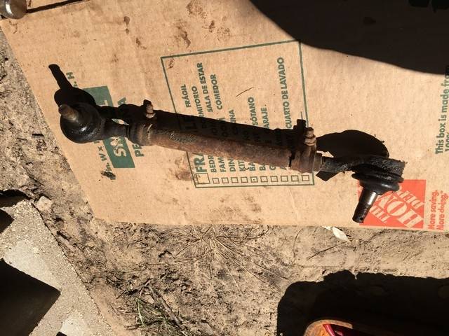

original tie rod
Old above, new below
I chose to replace both the inner tie rod, outer tie rod and sleeve. Two reasons.
1. These were original to the car and were 9/16. I moved them up to 11/16 - little stiffer, little sturdier and we have a 1/4 mile rock road drive way.
2. The car spent several years in Illinois after we gave it to my mother-in-law. Salt can't be good for these things.

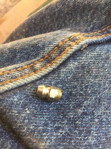

Don't forget to screw in the zerts into the ends of the tie rods before you install them. Much easier. Otherwise, you get dirt in your hair as you lay on the ground trying to get it to thread from below.

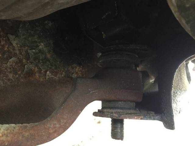

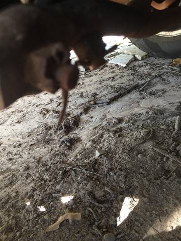

Driver side

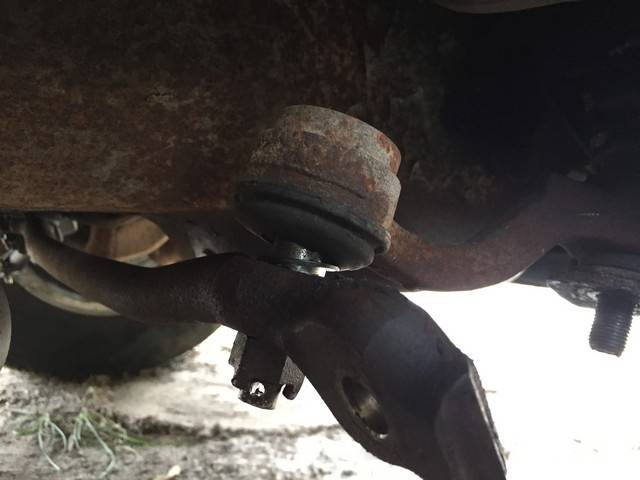

Notice the hole in the center? Thats the very end of the center link with inner tie rod already out.
The arm you see there (passenger side) is the idler arm.
Notice how pretty shiny it is above the center link?
The grease boot had ripped all the way around and there is no zert on the original, so you couldn't regrease it. Had to come out... Too much play in the system as it was.

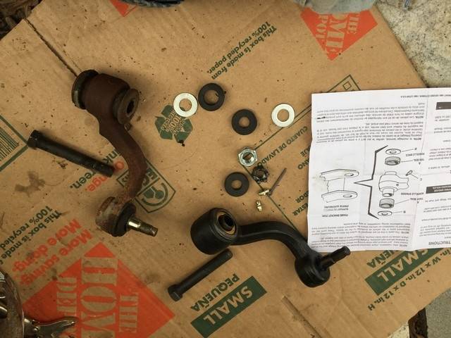

Great design of the other end of the idler arm. How in the heckamonious do you get to the top of the bolt? What a pain. Finally used locking pliers and backed the nut off the bottom.
Old on the left.
New on the right.

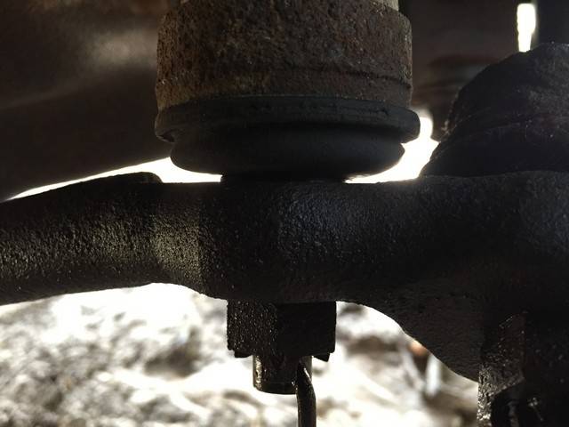

Couldn't get the last cotter pin into the hole of the idler arm shaft. Bent it twice.
Have to go buy a new one tomorrow and then take the car to the mechanic so he can review what I've done and let me know if I did things okay.

The end result was two worn out parts. Inner tierod end boot on passenger side was ripped all the way around and the idler arm end that connects to the center link was ripped and dry.
Budw was spot on about the centerline connection being dangerous.
