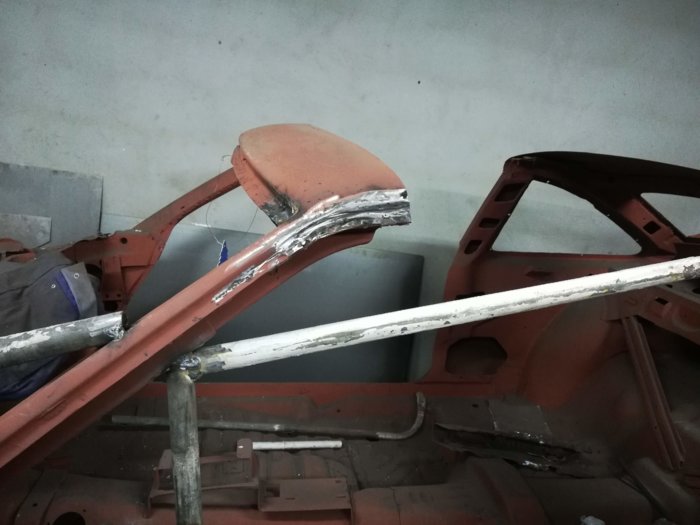

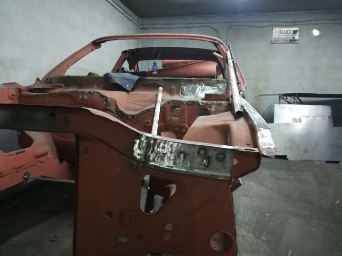

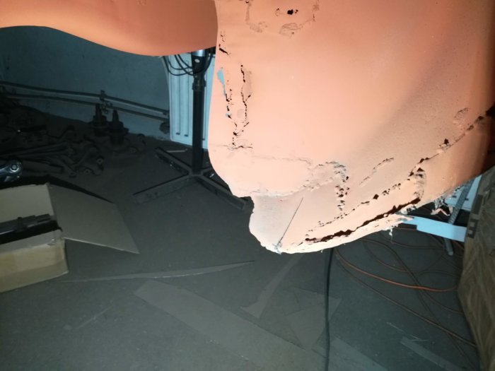

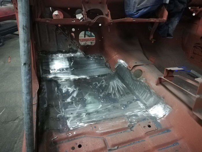

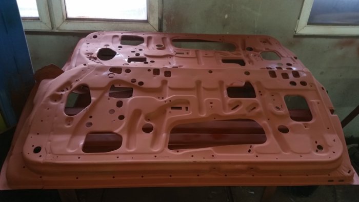

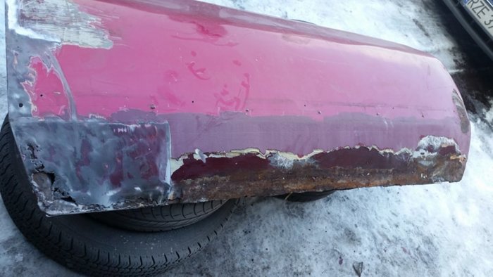

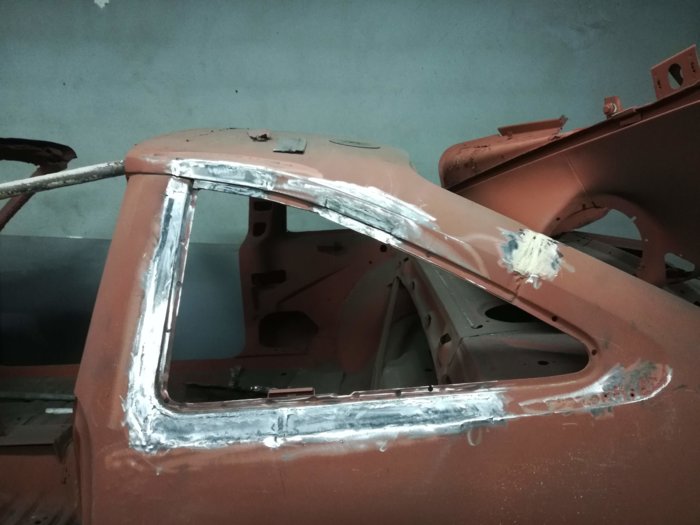

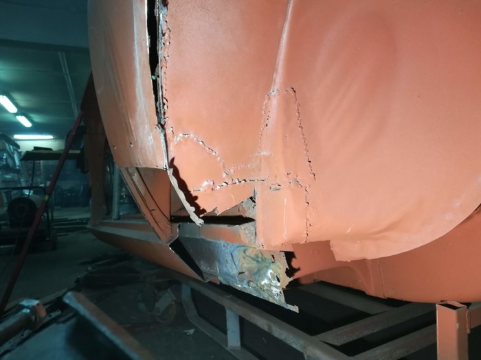

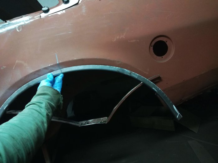

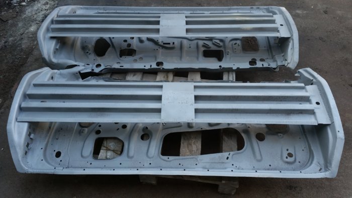

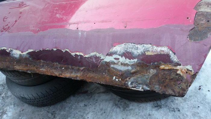

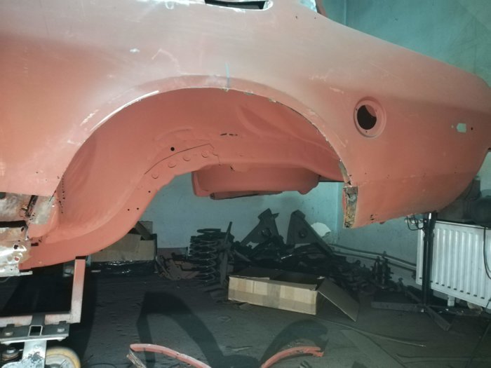

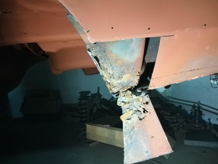

Fight, second round:) doors opened, metal work, sanding and painting.
Big rust, more than other cars ... is it normal?

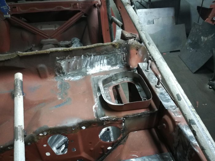

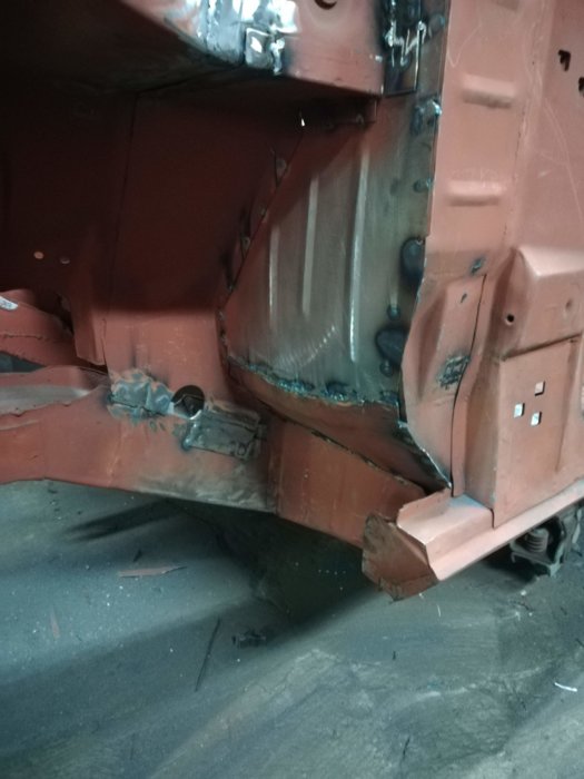

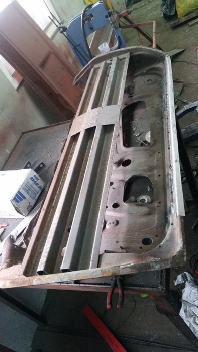

I hate to put a damper on this but if those are mig welds the thing is a hotspot for cracks. There's a lot of stress in the welds.
SixBanger
Jul 31, 2018
347
52
The Netherlands
It is possible to warm up the welds with a propane burner to release some stress. But maybe it is to overkill for a car welding jobs.
1,834
1,040
Do you plan on welding in frame ties? I would highly recommend it if you haven't done it yet. It'll greatly stiffen the car.
Boncky
Sep 17, 2018
44
42
Poland
about welds, it is Mig/Mag but dont worry about stress, in car like this, is no problem, i have big skill so i know what to do, to do this good:) only in car like this is problem because body is made half of what volare
some pictures? where, how ?
