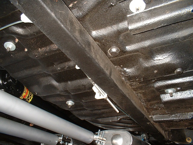

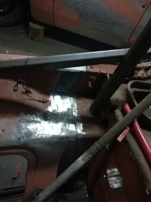

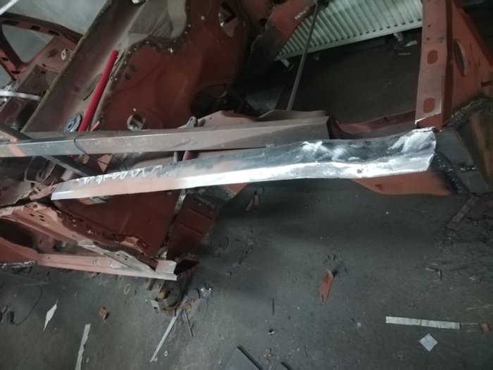

Two inch square tube, open front of rear frame rail and back of front and slide tube in both ends. You will have to trim rear foot wells for the tubing going forward. Then weld ends and the floor were it buts to the tubing.
2,991
Here's a pic of my subframe connectors, taken a couple years ago before I changed mufflers. As Oldiron said, slots cut in the rear footwells and the floor welded to the connectors. They don't intrude on the inside of the car far enough to be noticeable. The carpet pretty well hides them.
thank you !
You saved me a trip to the garage. :)
hahah :) it will be great trip...:)

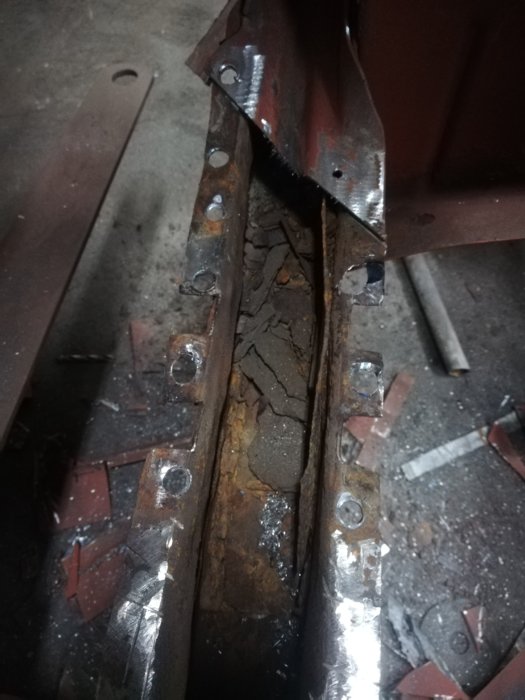

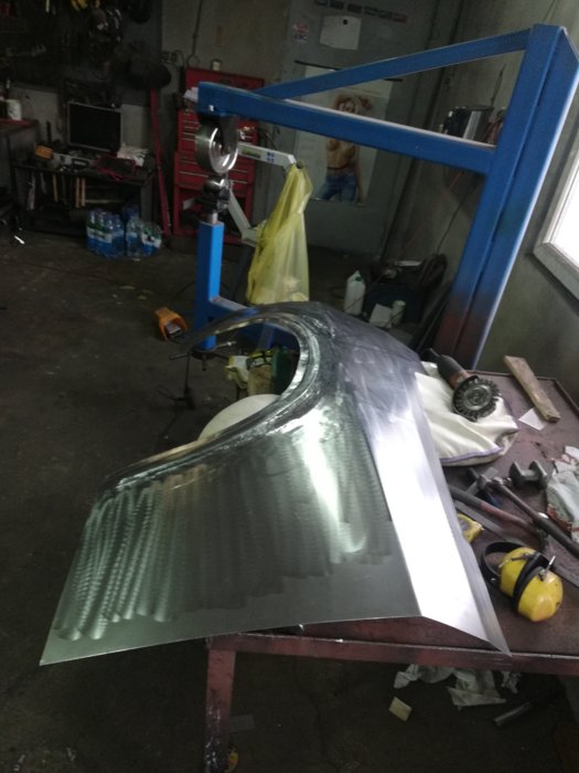

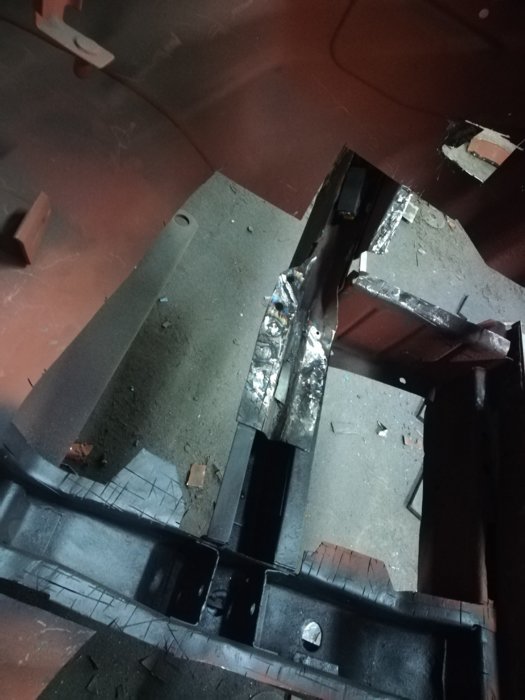

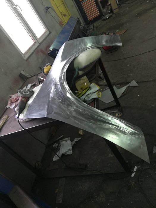

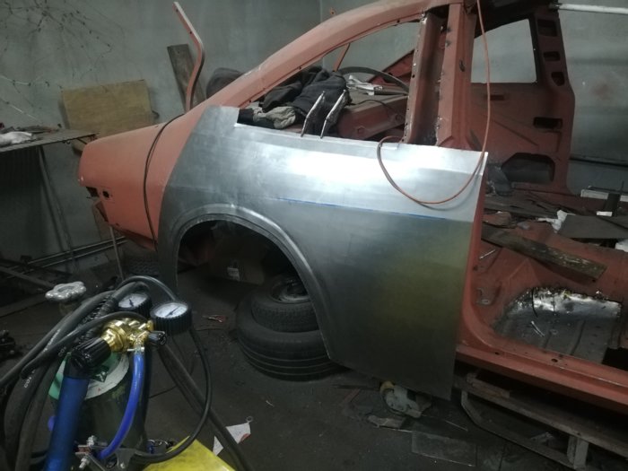

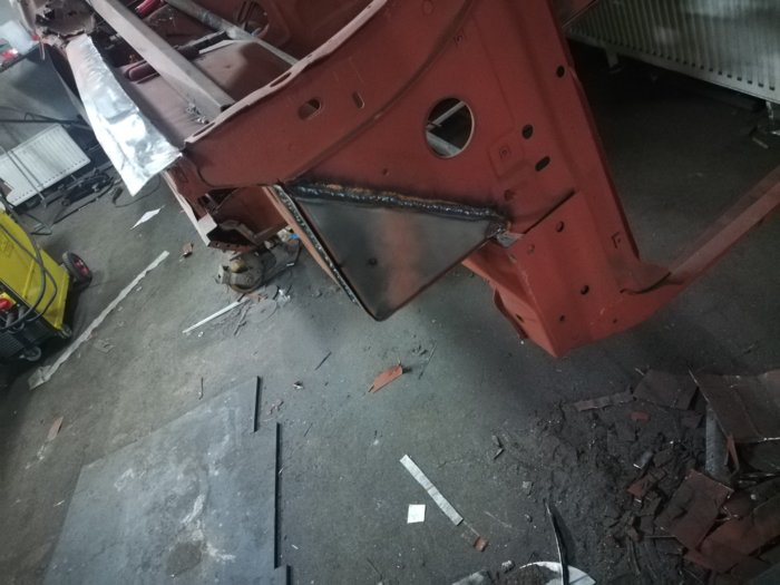

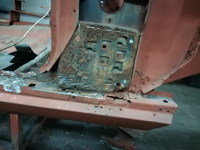

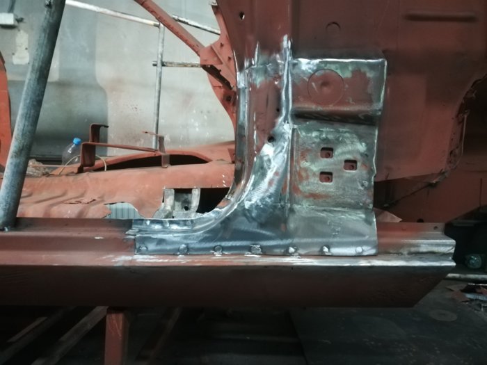

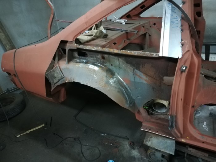

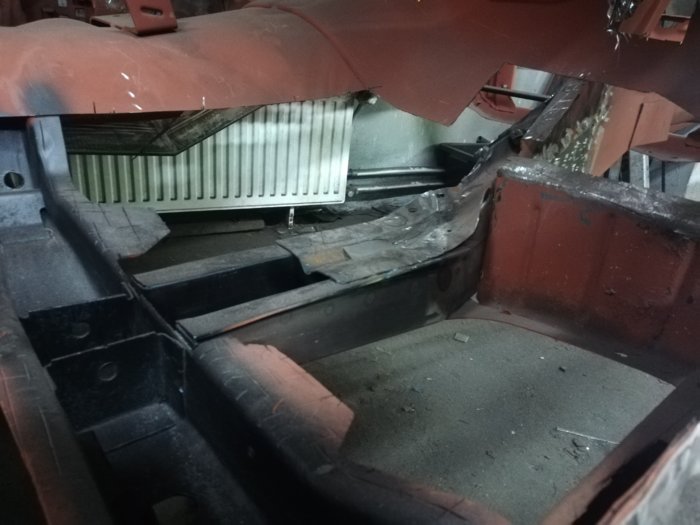

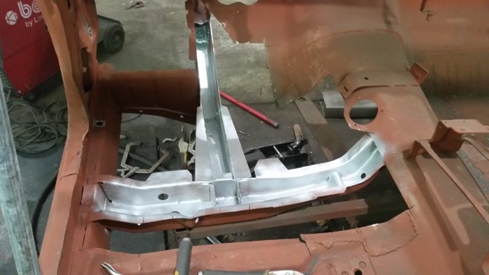

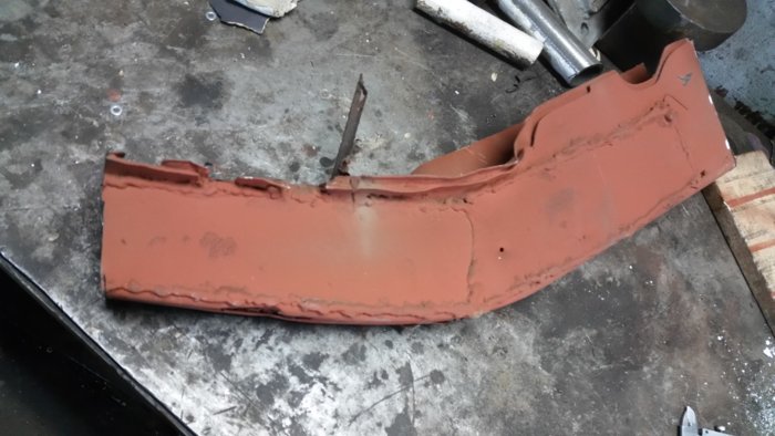

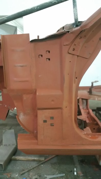

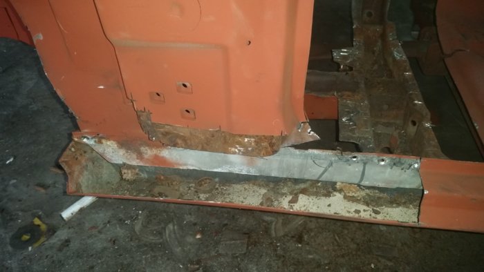

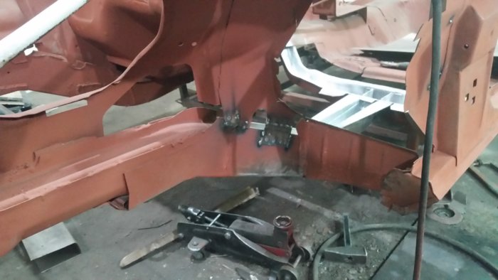

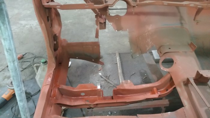

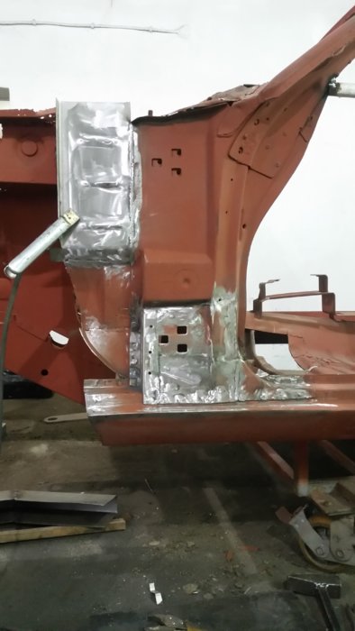

few more panels, new frame support, and more... what do You think ?
front:
new frame support
front right
now i fight with all quart, i jus start panel, from one metal element
