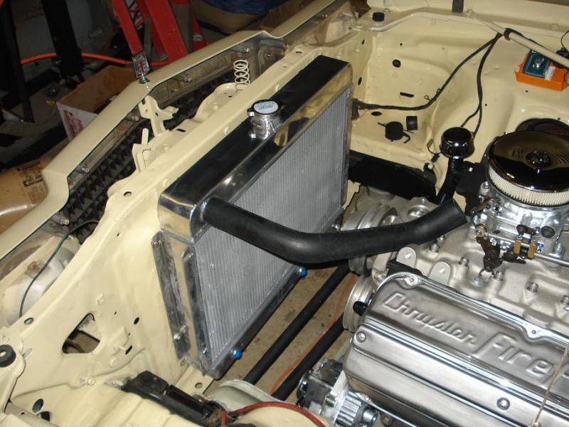

I got the radiator. Anybody got a radiator hose for a 1980 Diplomat, 1957 354, bigblock Chevy water pump, and a 1967 Nova radiator??? I've search the web and can't seem to find a part number. Go figure!?
joeblo
Feb 27, 2011
194
10
I'll post some pics after I get the radiator installed. Looks like it should be a nice fit. I will probably make some braided hoses or something, haven't given it much thought yet. Any suggestions would be appriciated. If I don't have time tommorrow I'll get it in on Sat..
Don't do the braided hoses...if you have to use some RPC stainless steel hoses. Your car looks to good for the braided hoses.

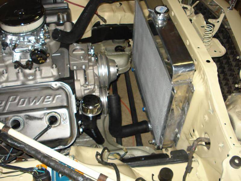

Radiator is a nice fit,(67 Nova). The top hose should work but the bottom hose is a bit short. Also finished the water ports in the heads and installed the oil fill/ breather. Chevy one wire alternator should work ok, but will need to fab some adjustment brackets.

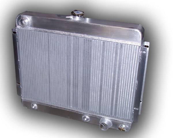

i like that radiator. how much did it run you? would certianly look good in my 5th with all the chrome

Found it on ebay, company called engineered cooling products.Checking the mearsurements I thought I might be able to use the original mounting holes, but it was about 1/4" off. Not a big deal to drill some new holes. This one was made for a 62-67 Nova, and cost $250.00 with shipping. The over flow spout sticks out at a funny direction but again, not a big deal. I'm going to order a electric fan for a Jeep wrangler that should fit nicely. My car did not have a/c originally, I think a/c cars had a bigger rad support, Someone else may chime in on this.

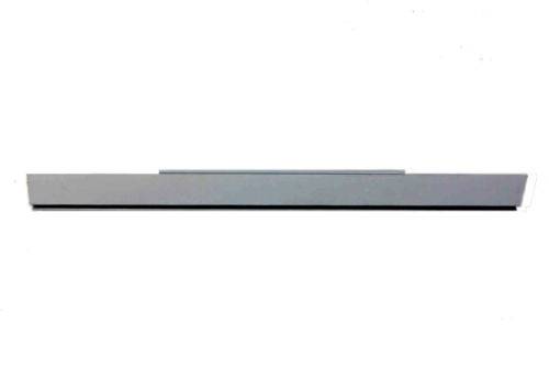

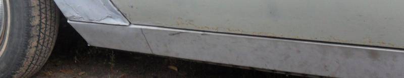

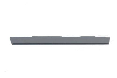

in 1 of your pics it looks like you need a rocker panel? i bought 2 outer rockers for the f-m-j- 2door from jakes auto body ( think thats the name--- find in in e bay under auto body repair panels ) i welded the left one on, and the fit and quality is very good,,, now the cost,,,,,,,,,,, just 25 bucks each !! they also have em for 4 doors too. ill try to post a pic or 2

rockers
cataloge pic of rockers and pic of panel on my car:wave:

My drivers side rocker was real bad, but I made a new one from an old air conditioner. If I would have known that I could get one for $25 that would have been alot easier and better. Thanx for the information, I'll pass it along to my buddy who is getting ready to fix up his gran fury.
