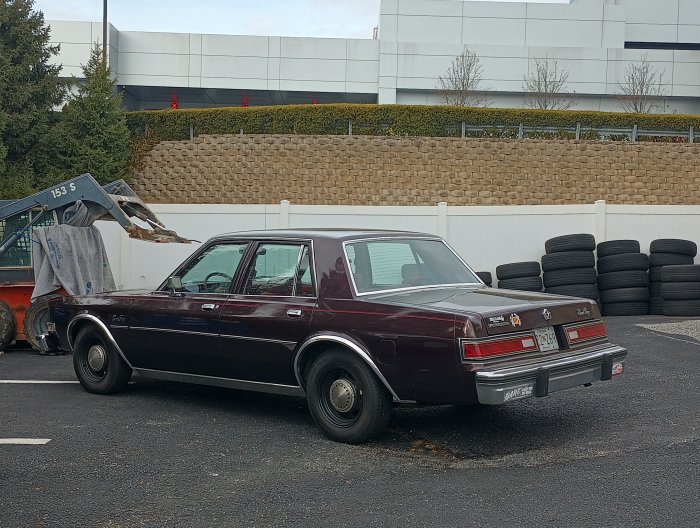

that's a huge help. 84 New Yorker is an M right? theres one in Pennsylvania that might get sacrificed. if not one in Delaware that might as a bonus have the red seats i want for my maroon car
that or i can see if i can get back in contact with the guy with that white car you took the header off of

Go for the one with red seats, because if the quarters aren't any good at least you can get the seats.
Idk how much better that white car was, and if i recall correctly, the trunk didn't even open, so its not like you could even check down inside and see if it's rotten.

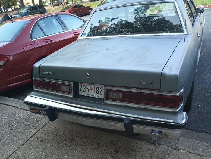

found a picture of this car in old family photos. yep, it was always grey it seems. had a repaint when the Plymouth header panel was put on i remember that.
new plugs, wires, cap, rotor. acceleration stumble is gone. that was simple. carb is leaking though. needs rebuild. wipers still don't work. will likely need a new switch. even the spray nozzles don't work.

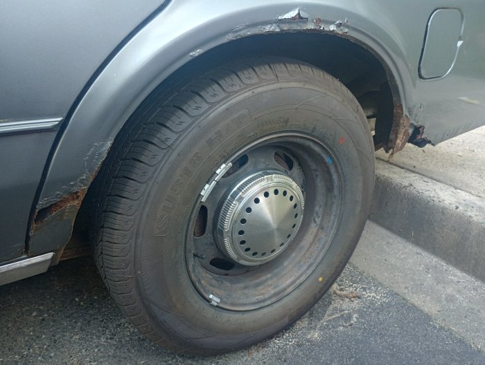

made sure to check under the wheel well trims of my Plymouth. to my dismay i can see rot starting there. very minor bubbling now. made sure to clean em up really good.
hunting for quarter panels now. might have one lined up.
Pop those bubbles, sand the area down to remove the rust. If you want to be surgical, use a Dremel. Clean with acetone or brake cleaner.
Treat with ospho
Paint with rusty metal primer, several coats
Is this the "professional" way to do it? Hell no. Will it slow the rust and preserve the car? Yes. Is it cheap? Yup. If it's behind the trim, you can use the trim to hide your work after and keep enjoying the car

thanks AMC. gotta track down a good Black Cherry spray paint. or just get really good at taping off the fender. rust is only on a few paint chips and on the driver's side rear quarter. hidden on the underside and under the skirt. and one or two tiny bubbles around the window, those will be hard to hide. how easy are those rear window trims to take on and off? some paint chipped off there. filled in with a touch up pen but it really came out looking black
your tips have definitely taught be this task isn't as daunting as it seemed at first. gonna try and do these cars right
