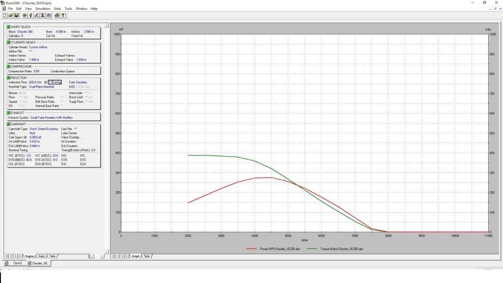

Just for an idea I found some head flow data for the stock closed 302 heads, I entered that info into desktop dyno, entered in the 1.88/1.6 valve size, cam specs, got the comp at 9.5:1 with a 600 holley. Set it for small tube headers and mufflers and here are the results. This is all on a 360 block bore and stroke. I have no idea how accurate this program is but from what I see a stock 360 with 318 heads with the kinda stock cam is capable of 4500/4800rpm all ok.
Cam is a Comp Cams 20-220-3 CAMSHAFT XE250H
Duration @ .050" Lift:206/212
Valve Lift: .432/.444
I did run the same engine with 360 port flow data and the low comp of 7.9:1 and the results were pretty much the same graphs but 30hp/ftlbs lower, so in this case one could say its not the flow but the cam in this situation limiting the revs??
clearly it is RPM limited.But so what!Check out the torque; exactly what you need for a tire-fryer.

That looks to be 385/390 ftlbs. I can guarantee you that 385 will roast some tires with a 10/1 starter gear; maybe even with an 9/1, with a little TC help to jerk it loose.Once they are spinning, they won't stop for a long,long time.
