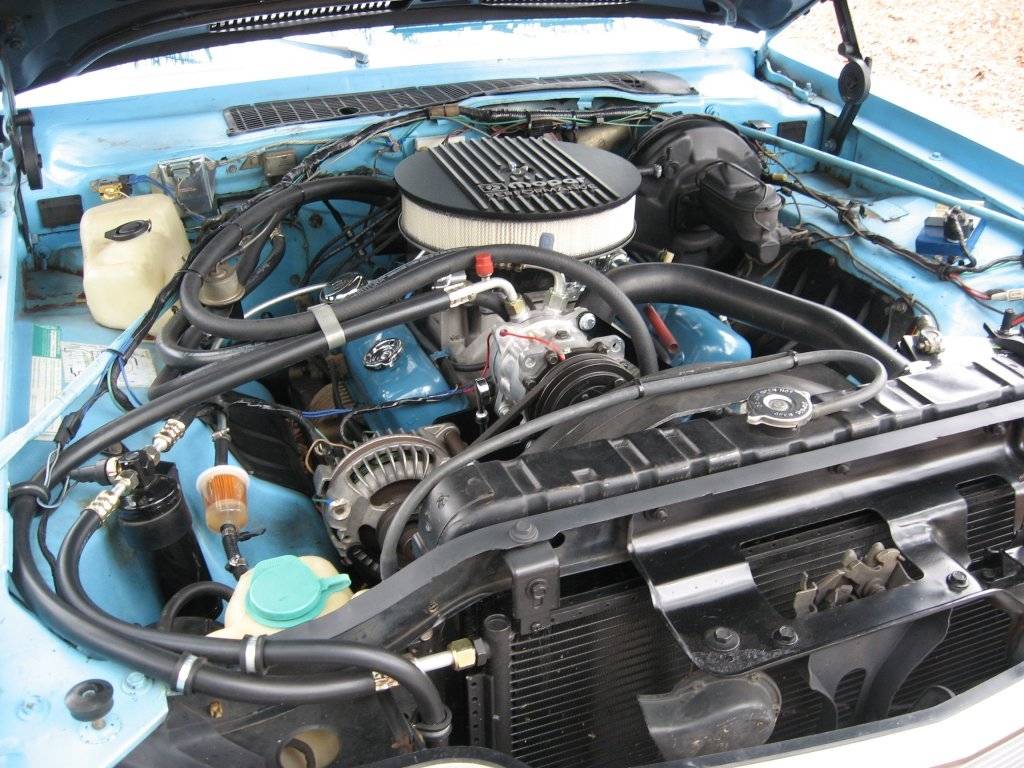

Well,,,,I had Glen-Ray Radiator, here in town, make me one. They took the biggest rad you could get in an F-body and put a 3 row core into the stock tanks and side pieces. I'm assuming they started with a 360 with A/C radiator(?)
With a clutch fan and shroud, it cools a 500" BB, with the A/C running, on a 90 degree day, in traffic. Temp rarely goes above center on the gauge.

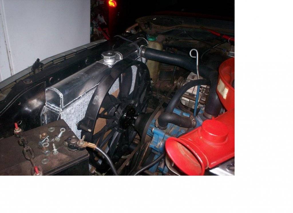

Got mine from a custom Radiator shop. It was ordered by a racer and never came to pay the difference and claim it. I paid the difference $229 and just had to change the top hose to a passenger side inlet. It is a 3 core and keeps the motor cool at highway cruise- where I had problems. Problem solved.

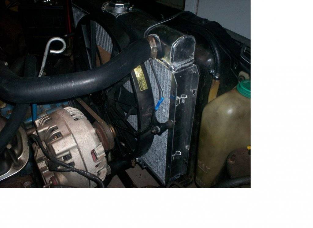

I used an E body 26 in radiator. Just positioned it were it needed to set and drilled 4 holes in the core support. Works great. It is a three row and keeps the 340 at 170-180 with a/c on 90 degree days. Real happy with the set up.
