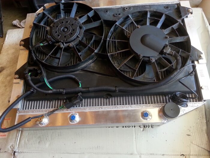

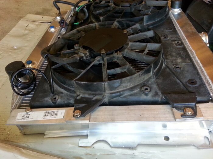

IF you can get the aluminum fan shroud for your radiator for an E fan they do work very well
the fan they ship with is complete garbage but the shroud is totally worth it.
1,830
1,035
This radiator is set up for a b/e body shroud to bolt up to it, idk if there would be any clearance issues on our cars, I don't have one of those shrouds, and don't want to buy one since I'm probably installing e-fan(s) in the coming weeks.
Ford V6 Contour electric fans work well with this radiator. I used a Dakota Digital 2-speed controller with them until I went Sniper EFI and let the ECU handle hit.

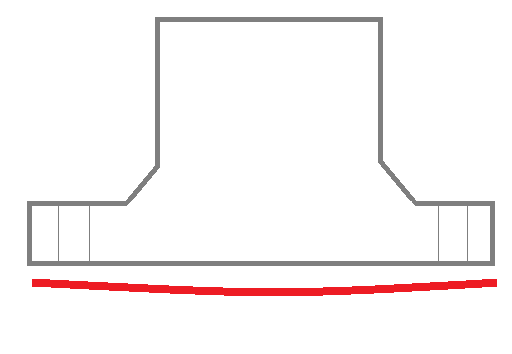

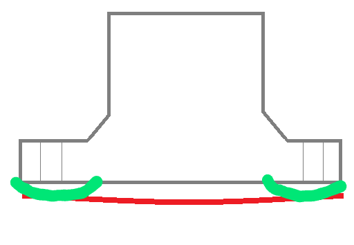

What I do, on leaking thermostat housings is get a file (or a power sander, turned upside down) and file/sand it down so the surface has a slight rounding to it (filing more at the bolt hole locations). That way it pushes down more on the sides. It also removes any rust or corrosion and leaves a more flat finish.
Note: this is an exaggeration of what I mean.

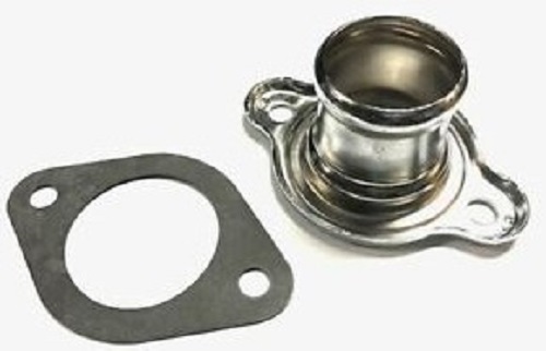

I know the big block thermostat housing has the same crown shape to the thermostat gasket surface. I am not sure if the same is true to /6 or small blocks.

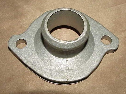

Another thing I have done, on pitted housings (from rust or corrosion), is I have used abrasives (wire brush, sand blasting, etc.) to get down to bare metal, then used 2-part epoxy to fill in those voids, then perform any sanding or filing once dry. Trying to get an older thermostat to seal when the surface is not flat or smooth, will just leak (been down that road, too many times).
The thick aluminum housings have more of an issue with leaking than the stamped steel versions do, for some reason.
Aluminum ('78 and older), big or small block. All /6's look different.
Steel ('79 and older) small block.

Mine (factory stamped steel) had been deformed by years of over-tightening. It was bent in like the green lines. Not enough to be visible (why I missed it the first time) but when I used a scrap piece of aluminum as a straight edge, the middle was definitely getting no sealing pressure whatsoever, there was a noticable gap. A few love taps with a hammer sorted it right out
