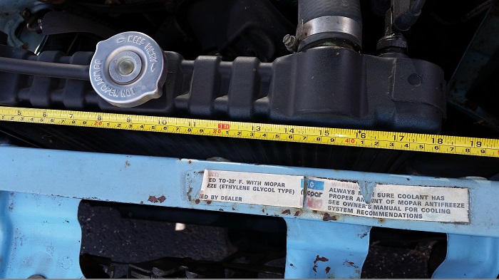

    The 26” wide version (used on FMJ's with A/C, trailer towing, police or taxi) and the narrow version (which can be 18”, 19”, 20”, 21” or 22” wide, depending on the year) on FMJ's that don’t fit the above description.
    My ’77 Volare wagon 318 (no A/C) has an 18” wide radiator.

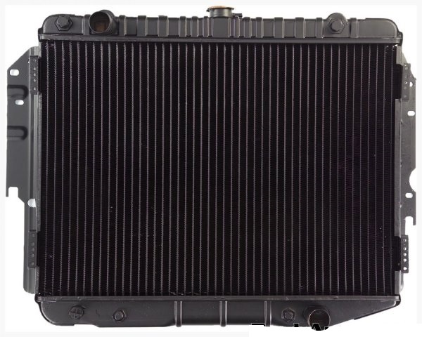

    All the factory FMJ radiators are made of brass. Brass is not as good of a conductor of heat as copper or aluminum. Copper is too soft a metal for radiators, so not used. If you don’t have other issues (ie: blown head gasket, rust/crud in cooling system, stuck thermostat, etc.) the brass unit works fine.

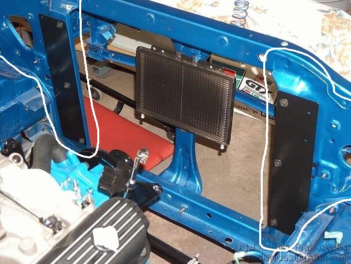

    Note: if you currently have a narrow radiator (ie: not the 26” wide version), it is a bit of work to upgrade to the 26” version. The two metal pates on both sides of the radiator core support are made differently between the wide and narrow versions. It takes a bit of cutting/welding to change the plates out.
    Another method is to bolt the wider radiator in using new holes (that you make).
    If you do this, you have the option of getting out a saw and cutting the core support plates for the increased air flow OR leave the wider radiator with the smaller air entrance hole (ie: not all radiator cores will get any airflow).
    This fellow forum member converted his narrow radiator brackets with no cutting (on the car). He made plates to fit the wider radiator - but he also has a few core tubes that don't get any (or much) airflow. The original plates are circled (below).

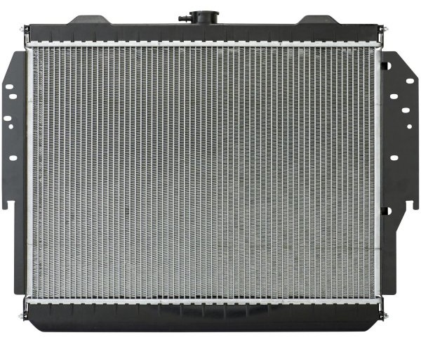

    You might want to make note of what vehicle you have (I found it, but it took a bit of digging.

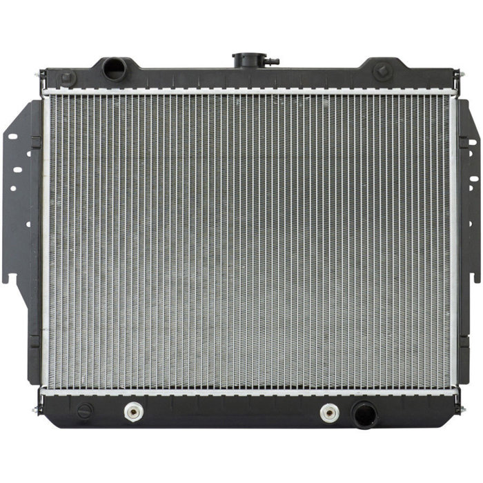

    I then went to RockAuto.com and they only show two radiators in stock (both are 26"). Most Fifth Ave's come with A/C so I think you have a good chance of having the 26" version.
    The cheaper one has a picture that appears to be brass but the “info button” says it is plastic/aluminum.
    (the picture will not be what you get).
    The more expensive version is also plastic/aluminum:
    The top/bottom tanks are plastic. The core (light colored part) is aluminum. The black side straps will either be metal or aluminum (painted). The bottom picture is made to fit many cars

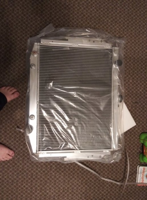

    so my ebay radiator came in today. doesnt look bad. cant wait to get it in

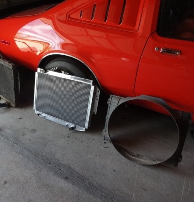

    Sorry, a bit late to the topic, but the pic BudW posted was mine as I documented the re-do of the coupe and in particular the move to the wider rad given that the car was originally a /6 setup.
    Anyways, for what it is worth I actually went with the following setup:
    43-3959 Radiator, ReadyRad (Proliance), $129.99 USD
    Now that was a few years ago (yikes, my build spreadsheet says 2006...LOL), and the rad was purchased at the local AutoZone.
    As I went looking for the up-to-date info on that part I actually found the prior forum post on this very topic => slant 6 to v8
    Alright, looks like you have found something already, aluminum will xfer the heat faster, so should be a better performing rad.
