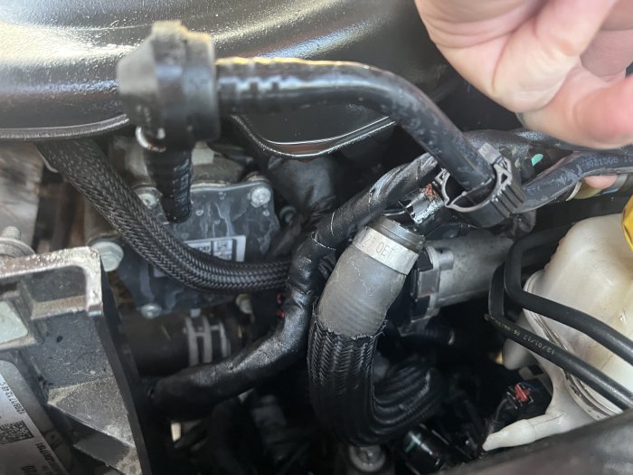

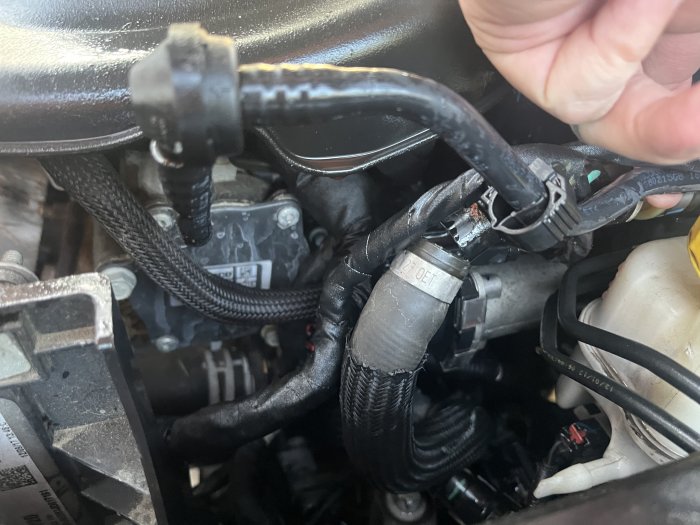

Nothing like catching the whiff of coolant burning in the air only to realize it’s coming from your engine…
Fucking Jeep.
AMC Diplomat
Feb 14, 2023
1,737
822
NY
Fucking Jeep.
Oh no, Jeep was infected with the Chrysler coolant line problem too? It's so bad friggin Dorman has a whole line of upgraded connections and hoses for Chrysler products. You know a design sucks when Dorman can take the time and make a better part
Camtron
Apr 25, 2019
2,378
1,955
US
You got it.
A seemingly pointless plastic connection in the middle of the hose snapped after the anti vibration clip that holds the hose to the intake manifold snapped.
AMC Diplomat
Feb 14, 2023
1,737
822
NY
You got it.
Yup, they all break. Some cost cutting loser made an entire career out of saving Chrysler 10 cents on every coolant line. Doorman has a bunch of replacement aluminum fittings you can splice in or you can just buy a brass hose connector from the hardware store.
