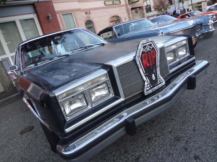

This photo was from a Halloween car show, and you can get a good view of the bad hood.

The paint on my '86 Fifth Ave was about 95-97% nice when I got the car, over a decade ago. Sun/weather and a lack of waxing the car, is now showing its toll. I have the same problem from the clearcoat coming off the top surfaces and it looks about the same as yours. The sides look decent, though.

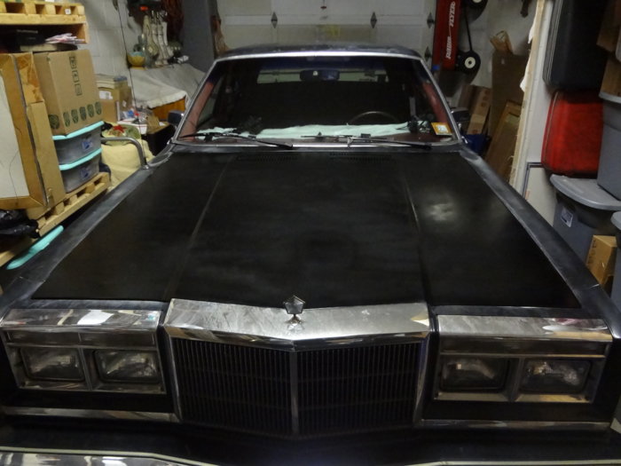

I did a decent bit of prep work, but my conditions became less than ideal, and since I was trying to get this job done today (no more days for the foreseeable future of decent weather), I kept working in the dark, under a streetlight. It didn't come out horrid, but it wasn't actually good. Whichever way, it accomplishes my task of rust prevention, and it looks better as one solid colour, instead of having those patches.
I'm going to do this again probably in a few weeks, or a few months, when I get some consistently good weather, and I'm going to just start at like 7AM, and do it all the 100% proper way.

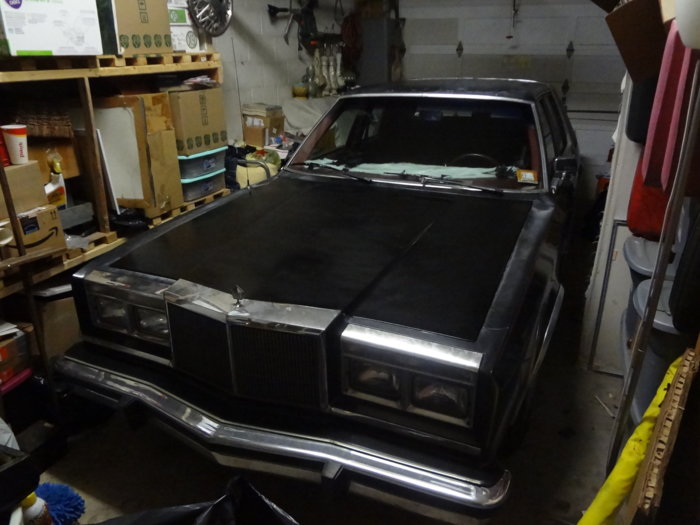

The first picture below was the first night that I got it into the garage. The 2nd and third are my pictures of it today. Next time I do this car, I'll be doing it with factory code paint, and I'll get myself a paint gun, and do it the right way. I'll also sand the hell out of it with a sanding machine to. (I sanded this today by hand, not impossible, but gets tiring.) Looks better than before, but not necessarily that great. What do you guys think? (If it looks like trash, don't be afraid to say it.)

Not horrible but you can see the imperfections of the last paint . What I would have done is sand with a 400 grit then sprayed primer like a filler wet/dry with a 600 then spray paint in the black and clear

I initially used 80 grit to get as much as I could off, and then I did 150. After that, I did 220. Then I did the primer. After the primer, I did one more sanding, with 220. Then, I applied 3 gloss coats, and 2 clear coats. (I did 3 or 4 primer coats.... hard to remember at the moment.) I probably shouldn't have used black primer either, since I was painting black, and I couldn't really see exactly how much spray was being put down onto the hood with each pass. That, on top of having a daylight shortage, just lead this to be doomed.
I'll probably do this again one day, but I'll try to get my hands on the correct coded chrysler black, and I'll make sure the whole thing is 100% smooth beforehand. One thing I noticed, was that there is a bit of body line in the middle of the hood, and I don't believe that goes far up, but I was doing my best to sand on each half, instead of going over it much, since I was afraid the sandpaper would take out the shape of the metal, but I don't know if sandpaper actually takes off layers of real metal. I know that I didn't get through every last layer of paint, but it was something going through my mind as I was doing the job.
