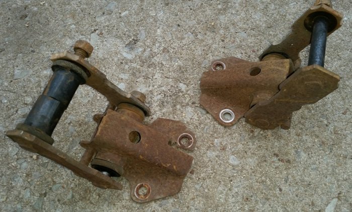

Non-police FMJ rear hangers (what 99% of FMJ's currently have on them), above. Police version shown below:
The police version would be nice to upgrade to if making a car capable of making harder turns.
The rear hanger (police or non-police) is an FMJ only part.
The trapezoid shackle was also used on '84-95 minivans - but a person will need to modify the rear hanger to make the wider shackle to fit (about 1/2" wider on each side).

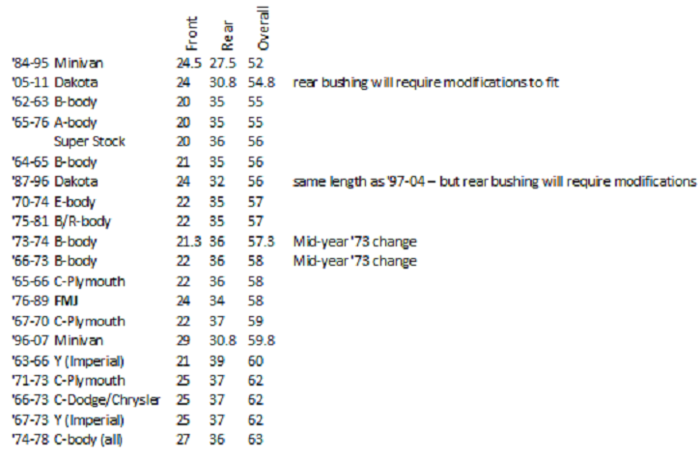

For reference (in inches, and sorted by overall length):
These are all of the 2½” wide leaf springs Chrysler used from '63 to present.
Pickups and vans used 3” wide springs – so not included in the list above.
I don't have much documentation on leaf springs used before '63 but even then – those springs might be hard to find, anyway.

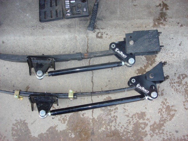

The top is a mopar spring with the needed boxes. The bottom is an off the shelf calvert split mono and caltrack setup they sell for our Fs.
Both the split mono and caltrac setup is listed on there website. OEM F front hanger. Simple bolt in if one is looking for simplicity.

The top pic I posted is a zero arch mopar road race/dirt track spring and they worked great with and without the caltracks. The caltracks helped in different (street) setting with different tires.
3,171
818
Top spring looks like a SS spring and hanger with the Caltrack added…

Maybe the shorter front segment makes one consider that. They are zero arch dirt/oval track springs. I no longer have these in the pic but I do have a new set sitting just because I found a couple singles on ebay dirt cheap shipped and ya never know when ya just might have a use for them.
