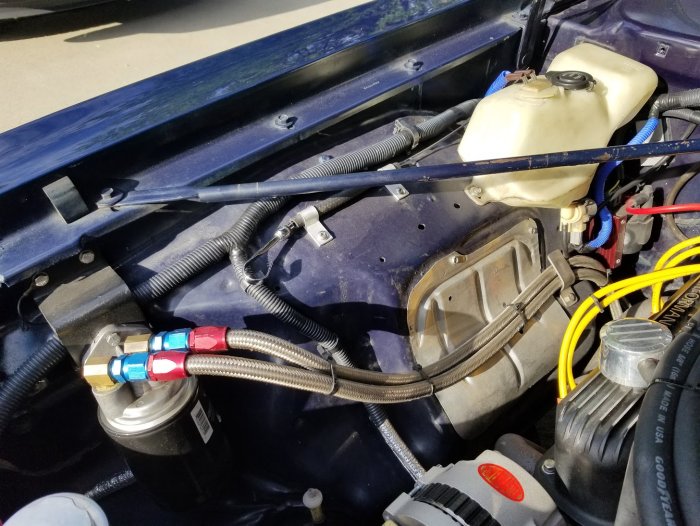

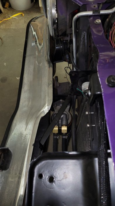

This is Dad's setup. Just a standard relocation kit with a custom bracket to mount it to right above where the vapor canister used to be. Dad even made me a bracket like that, but I never used it because I changed plans and went big block. I've still got the bracket if you want it.

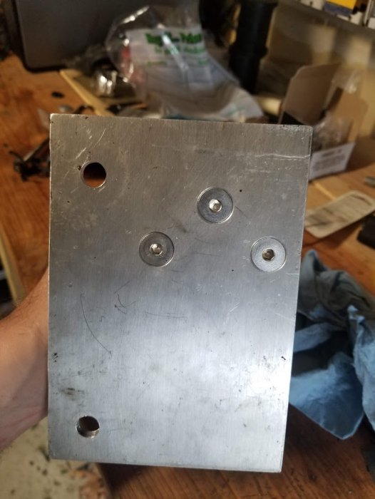

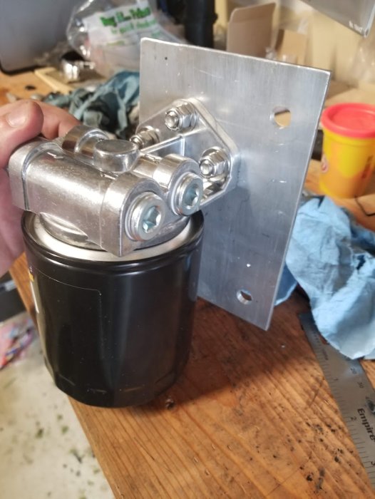

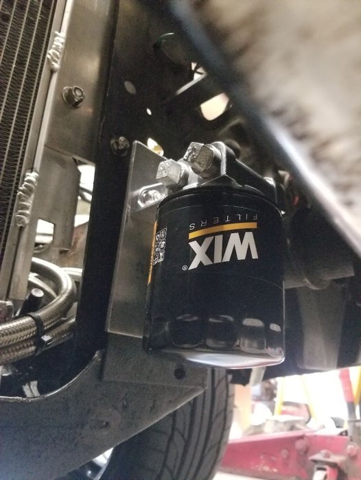

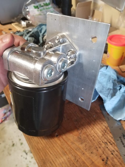

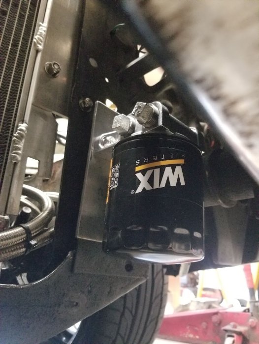

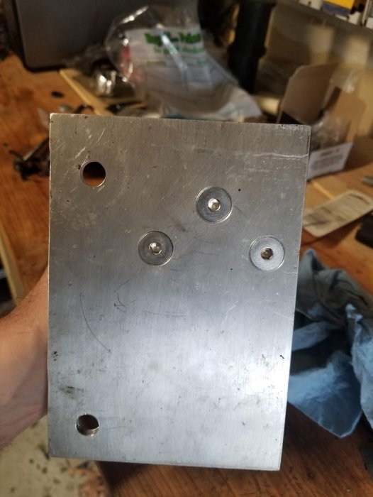

Below is what I did for mine. Mounted it to alloy plate and used the bumper shock bolts to hold it in place. It's on the driver side, but you might be able to do something similar to the passenger. This puts the bottom of the filter even with the bottom of the bumper.
Looks like the bumper could take out the oil filter in a small fender bender making it in drivable. Ford did something similar with there trucks one year.
If the bumper gets pushed in that far chances are it won't be drivable anyway.
But that would be my concern being up front that it's high enough that something couldn't easily damage it.
It's well past the length of travel in the bumper shocks and doesn't sit any lower than the bumper itself. If something pushes that heavy of a bumper back that far the car is fucked either way.

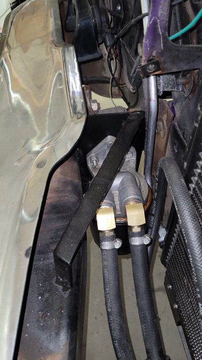

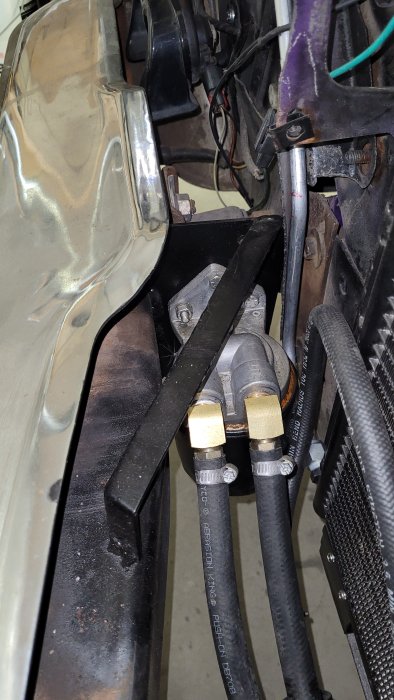

I Installed a remote oil filter behind the bumper. I welded some brackets to the back of the inner bumper. The filter is at the same level as the bumper to protect it from road hazards and the radiator is lower. I needed to leave the charcoal canister in place and it was too thick to mount behind the grill. It would have blocked the AC condenser. The hoses run under the rad above the bottom of the core support and thru the engine mount. I intend to replace the hoses with bent tubing in the areas that are possibly subject to chafing eventually; some hose will be needed to allow for engine movement. That was my thought process.
I certainly like the filter mounting setup your dad put together, but I actually have been on a 'drive' to lower the amount of stuff that's showing in the engine bay...our rides already have plenty enough of wiring and hoses. So my preference is to go as un-seen as possible.
For that reason Mark, I like how you had implemented this. I have some spare aluminum plates here that I could mount the oil filter adapter to and attach to the frame, maybe even in the same spot you have it in, just the opposite side. I'll measure some things out this weekend.
I Installed a remote oil filter behind the bumper. I welded some brackets to the back of the inner bumper. The filter is at the same level as the bumper to protect it from road hazards and the radiator is lower...
I like how sturdy that setup appears to be, although that's probably a little more fabricating that I was planning on doing.

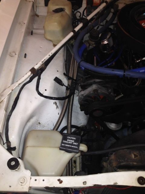

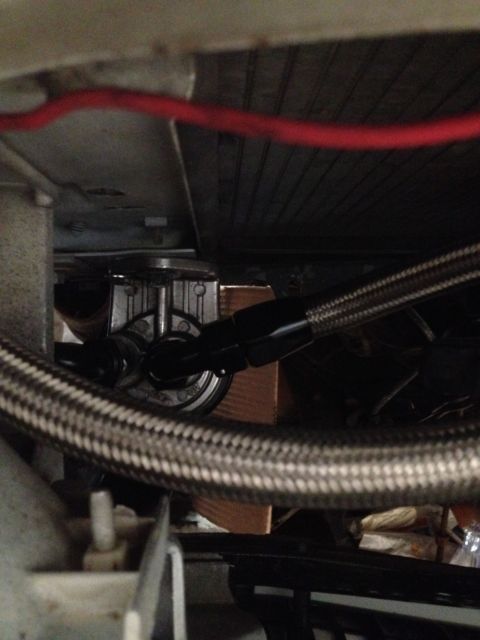

I have the adapter on the block, and steel braided lines with AN fittings with the filter mounted to the rad support. I also have an inline engine oil cooler. I'm very happy with it. It has been 100% seep/leak free and oil changes are so much easier and cleaner. And this way the filter is away from the heat of the engine block too.
