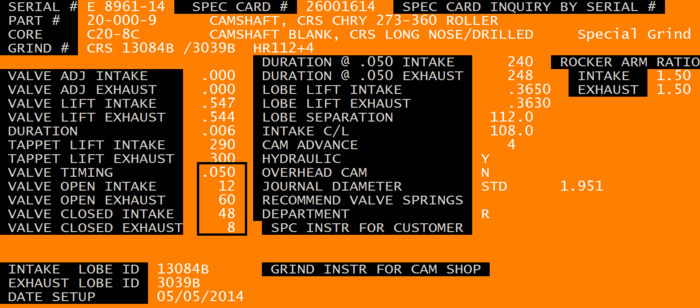

    A pretty sout cam, but why the crazy spread @ 0.050" between intake and exhaust durations? And boy, does that exhaust ramp seem aggressive or what?
    You would almost think that design is anticipating an absolutely terrible flow on the exhaust side, so maybe stock manifolds? Either way, this long of a duration may bleed off a lot of pressure on the intake side...and that would require a good bump up on the CR I'm guessing.
    Take a look at the attached grind spec sheet for my stroker roller build. Was going to start on this over the winter but things are moving slow here...anyways, pretty similar specs: 290/300, 240/248@0.050 and .547.544 lift on 112 LSA. Not for sale, but for comparison purposes.
