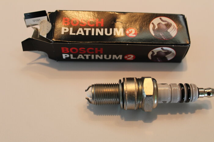

One question on plugs. Have done them before several times on other cars. Ordered these Bosch plugs from Rock Auto. A different kind of tip, supposedly fits my 5th Avenue. Okay to use or get some more 'traditional' tipped plugs? I dunno!View attachment 44534 I've just never used this kind of tipped spark plug before. How about you all?
I use the Bosch Platinum +2 in my 1988 5th avenue with all of the original factory Lean Burn equipment and they work excellent, idle to highway speeds.
