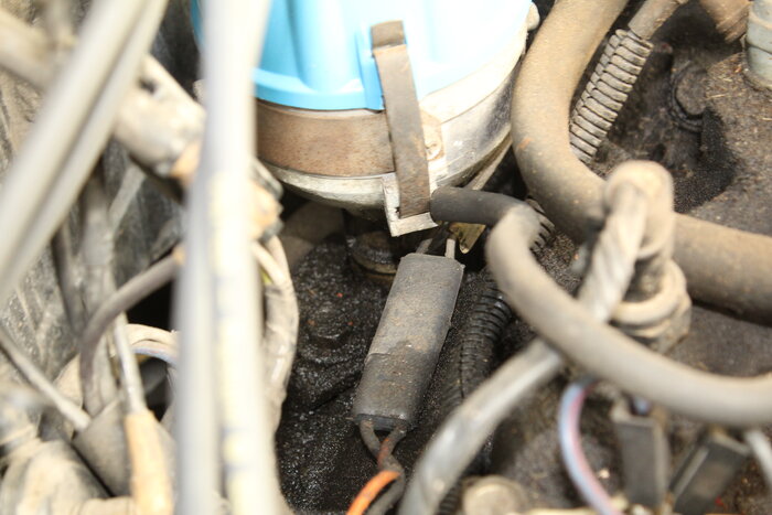

Looked at distributor as best I could with all the stuff in the way. Seems there is a bolt, which looks to be holding a metal bracket in place, on the left side (standing at front of engine looking back to towards the firewall) of the distributor. Bracket looks to reach over to distributor. Is this the bolt I need to loosen to turn distributor cap? See photo.

That looks like the correct bolt. But check the marking on balancer first.

Yes that's the bolt.
