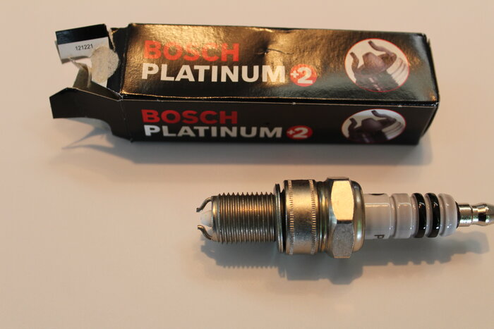

One question on plugs. Have done them before several times on other cars. Ordered these Bosch plugs from Rock Auto. A different kind of tip, supposedly fits my 5th Avenue. Okay to use or get some more 'traditional' tipped plugs? I dunno!
I've just never used this kind of tipped spark plug before. How about you all?

I've never used that type of plug, so I'm unsure. I personally just stick to the classic style so I can accurately gap them and install.

I've always used plain champions or ngk splitfire. Platinum plugs and other modern stuff doesn't have much benefit in an old engine and can actually be a negative.

As mentioned, the multi ground, iridium, etc.. plugs don't seem to function well in older engines, especially with stock ignition systems. Personally, I'd go with plain old copper core, regular plugs in your car.

I agree Aspen500; Just use the Champion RN12YC. Just what your engine wants. And I also doubt it's a burnt valve in the venerable 318. You need to go through those old hardened vacuum lines.

I once put Bosch platinum plugs like those on my old '82 Fifth Ave: big mistake! They were fried in a month...replaced them with the Champion copper plugs the others have mentioned and that's all I've used since

The spark plugs, on our cars, only last about 30k miles (48k KM) on average. There is no sense putting expensive plugs in our cars because they will still need replacing and most likely, the more expensive plugs won't last that long anyway.
