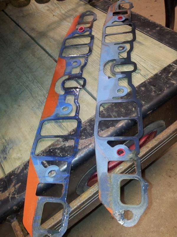

Here's a handy tip for virtually every person on the board: You know those neat-o end seals they provide with new intake gaskets? Throw them out, every time--especially if you're using an unknown intake (meaning you have no idea where it's been or what's been done to it). The end seals can actually hold the intake up too high and cause vacuum leaks from the lifter valley. Run an 1/8" bead of black silicone from intake gasket to intake gasket, both front and back, with an extra glob at the head-to-block junction point. Let it form a skin before you install the intake.

I did use the cork end gaskets.. Dangit. Shoulda just done RTV. DANGIT. HMM the intake didn't look like it was milled. Also the RTV that I used to seal the water ports is all squished out the top between intake and the head.. So I feel like it has clamped down the proper amount. I know for a fact these heads have NEVER been off the engine. My Poppy (grandpa) bought this beauty new in 1988. The intake though.. I coned the carb opening with paper so my ether sprays wouldn't get sucked in.. and I sprayed around the various vacuum spots externally, no sort of rev ups. So that is good I guess.

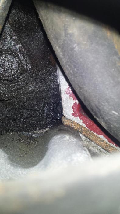

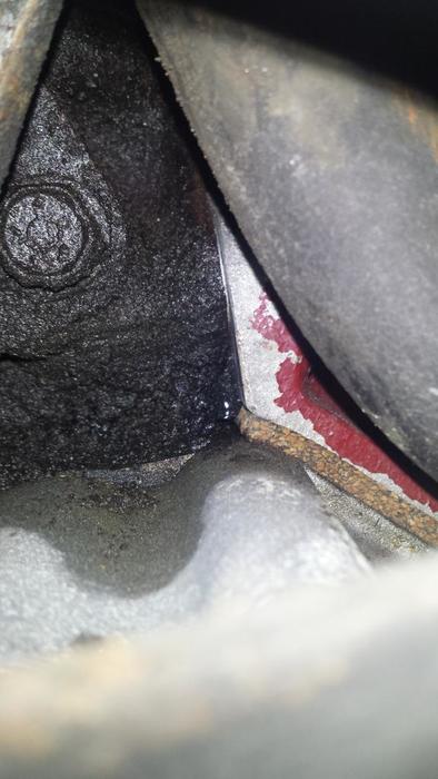

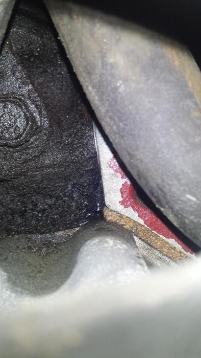

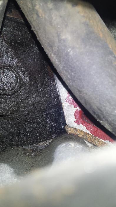

The bitch of the intake leaking from the valley side is that you'll never hear it. The top half of the gasket will be clamped just fine, and if all is done well you'll never know short of pulling the intake from the engine. The problem looks like this when you find it:

Hmm, good pic. Great describing aid on what you mean when it doesn't clamp down right. What I meant by doesn't sound like a vacuum leak is the way the engine is running, it is not stumbling or chugging at idle (like is normally seen with a vacuum leak). Pulling off any of the lines or anything, manually inducing a real verified vacuum leak, it runs rather rough and you can tell it is not right.

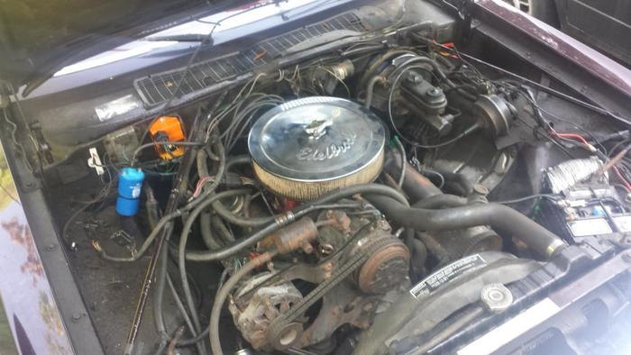

Edelbrock cleaner from my Cougar, fit on there. Filter is probably not the best, but i can't see it being THAT RESTRICTIVE.
Couple different shots in front of cylinder #2 where the intake meets the head and block.. looks like I have a good seal there?
The behavior with the air cleaner still indicates a vacuum leak. Normally, installing an air cleaner will drop the idle a little if at all. Air cleaners are more restrictive than you might think. For instance, look at this Big Honkin' Air Filter's* dimensions, then look at the CFM it moves... or, rather, doesn't move.
How the intake-to-head junction looks at the ends tells you nothing about how it looks in the middle. You did follow the correct torquing sequence and specifications, right? Even if you did, that won't make up for milling or warpage. If you absolutely know 100% it's not leaking topside, it's sucking from down under.
