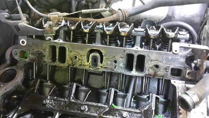

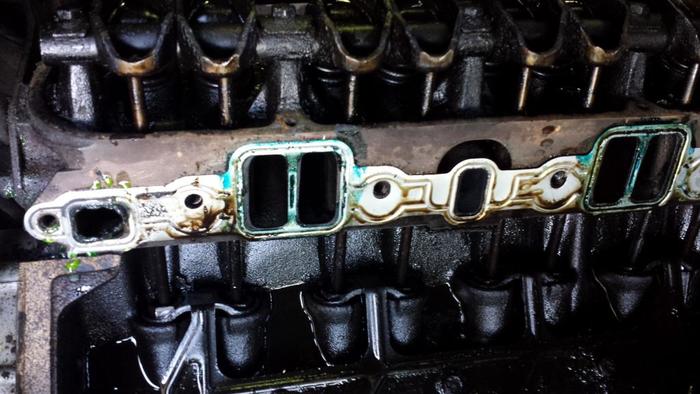

This is what everything looked like as soon as I pulled the manifold. didn't touch anything else prior to the picture. Seems like you were correct on the issue.. lol
